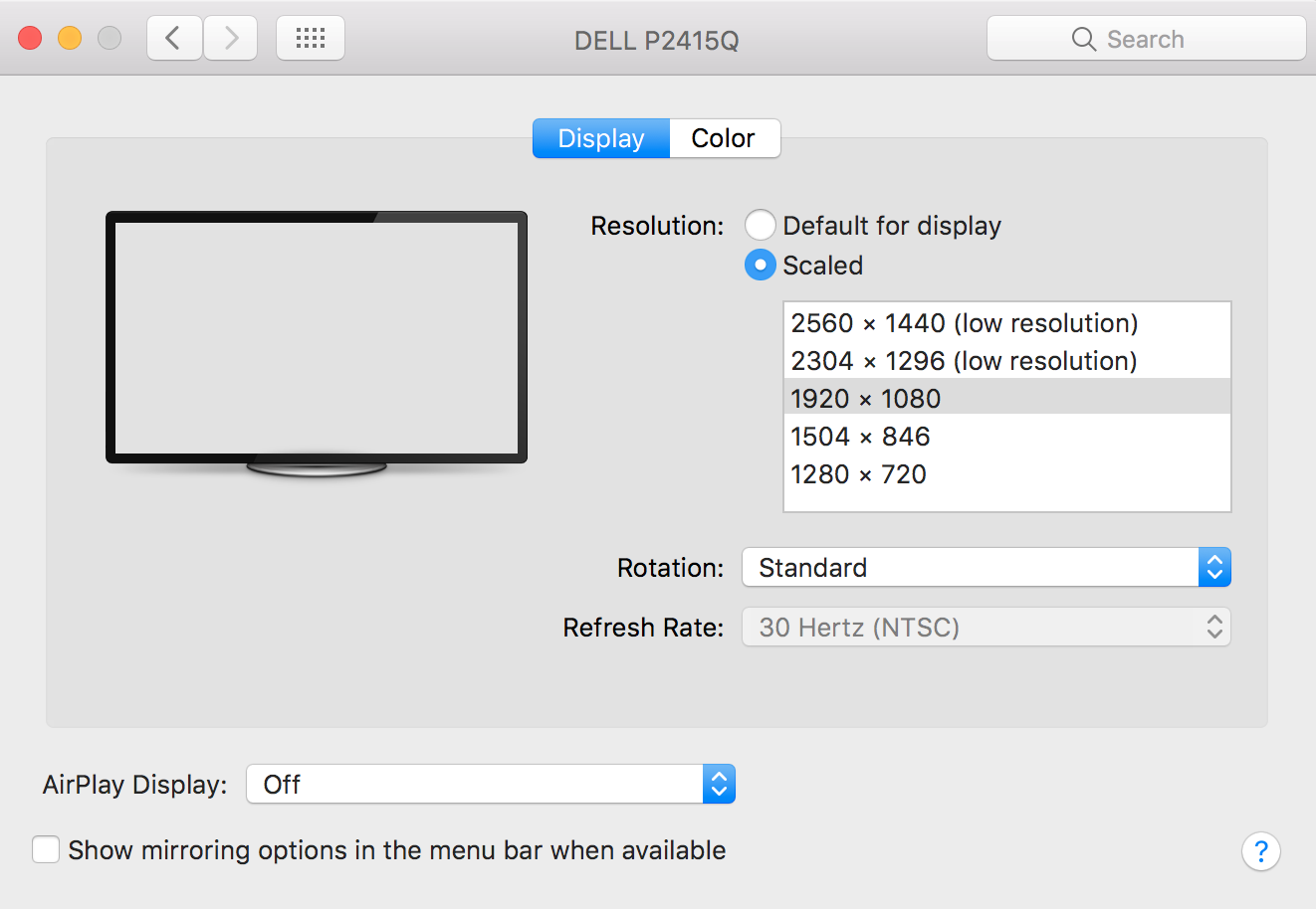

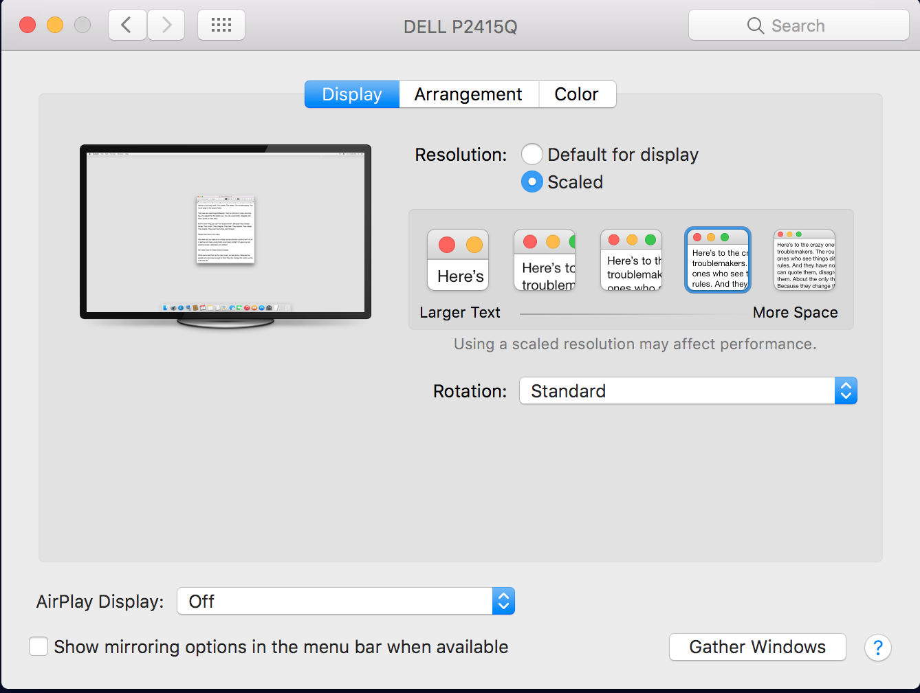

I have a particular variant of this problem on Sierra with my DELL P2415Q: When I first boot the machine plugged into the Dell monitor, I get the higher resolutions fine. My display settings looks like this:
It's when I unplug/replug the external monitor that I lose the high resolution and my display settings looks like this:
I tried setting:
sudo defaults write /Library/Preferences/com.apple.windowserver.plist DisplayResolutionEnabled -bool true
and rebooting, but that did not solve the problem.
Did not have this issue in El Capitan.
Talked with Apple Tech Support -- they did not have a solution for me. Hopefully Apple will release a fix.

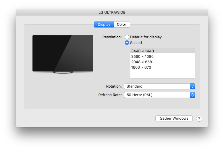

I have a Mac Pro 5,1 and using the HDMI port on my 3440x1440 monitor yields only 1080p. DisplayPort works fine, my El Capitan Macbook Pro works fine, etc. I've tried all solutions available: Forcing an EDID file, using DisplayResolutionEnabled and changing to false, etc. I've heard reported that the 10.12.1 beta may fix it for some. I'm just posting here for it to be noted as there aren't many Mac Pro users posting about this. yet.
Bumping this after the 10.12.1 update today. Has this update fixed the issue for anyone?
Does not appear to work, Plus it trashed my GTX980 driver until Nvidia updates it. GT120 still stuck at 1080P on a 3440x1440 monitor via HDMI. Presumably Displayport still works.

More importantly, that's not HiDPI - the '1440' figure is a dead giveaway. Unless I'm mistaken, the only problems that we're seeing involve UHD resolution or above (at least that's all I care about, since I have a 4k Samsung). So while it's great that acctman's monitor is working, that doesn't sound like evidence that the issue has been fixed in Sierra. :/
I tried setting:
This. This is exactly what happened to me.
