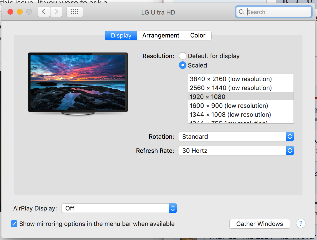

Well I'm running El Cap on a 13" rMBP (2014). Yeah the image seems very clear and the text is crisp. Just that it's at a 1920x1080 screen real estate. I can't select anything higher. I don't mind it perse but it would be nice to go even to 2560x1440.
Which LG do you have?
I have the LG 27UD58.
This is what I get in my display preferences.

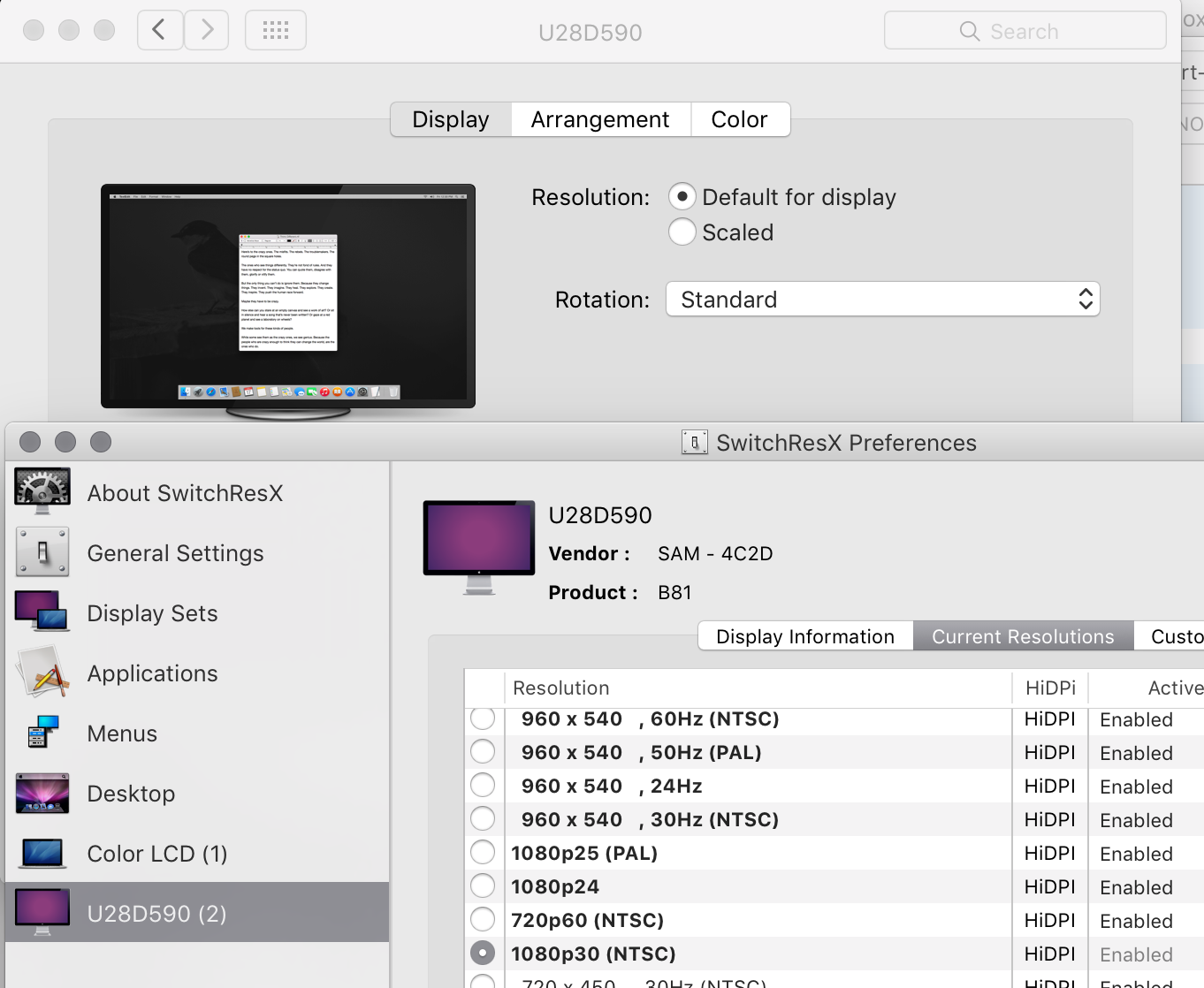

My own setup/settings seem pretty strange, see attached. It's been awhile since I got this dialed in, but I do recall not having HiDPI working when I first plugged this monitor in (it was 4K, but with a tiny UI). I remember monkeying with SwitchResX (I just downloaded it again, it wasn't installed), but I'm not sure if that was necessary to make the UI work correctly.
