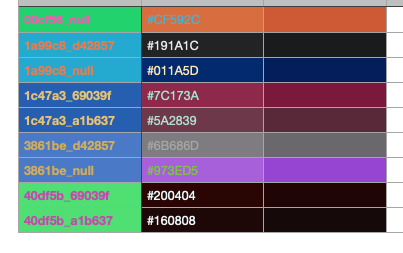

I'm trying to take a list of Color Codes and spit out a chart with the colors actually visible.
I'm trying the script* in this post from the Apple Support Forums:
The script worked once on a sample.. but then not again (and it didn't work quite like I expected)
This is what my table (sample) looks like**:
When I ran it and it worked, once, it gave me this
Why the first cell that has no "#" which should be the trigger according to the script colored as well, I don't know...but as I said, it didn't work a second time
Can anyone help me figure this all out?

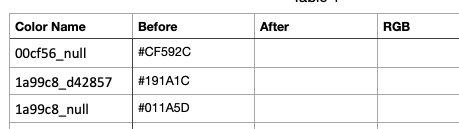

**(I changed my table to match the look in the original post to simplify my understanding of the code.....this is the actual table:

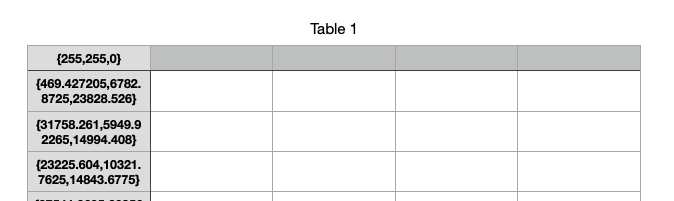

ok, trying to hammer out how to make the color that gets set flexable.
Using the script below, I get the error:
error "Can’t make \"{255,255,0}\" into type color." number -1700 from "{255,255,0}" to color
using the test table of :
I'm getting the info from the cell right, so that's good. but it's the turning it into color info that's not working yet.
Trying to use "the value of cell i as color" didn't work either.. so it doesn't like the sytanx of the cell value.

In your first post, you say "it didn't work a second time". Please explain what happened or what you observed that leads you to this conclusion.
I'm asking because if you don't change any of the cell values, then running the script a 2nd or 3rd time will simply tell every cell to set the colors that the cell already has. In other words, no colors will change, because every cell is already the color that its value represents.
If you manually change some cell colors, say to black text on white, then run the script, you should see colors change.
If there's something else that happens which leads you conclude it didn't work, we need to know what that is. If there's an error message, please post it. If there's something else, then describe it.
When I run the script in post #1 after a minor change, it works every time I run it.
If I change the value in a cell, then the next time it runs, the cell's color changes. And if I don't change a cell's value, then the next time it runs, the cell's color is unchanged, because its value is unchanged.

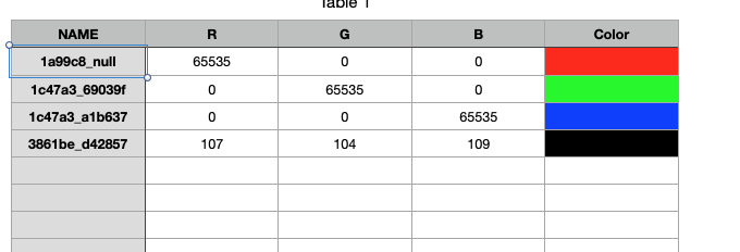

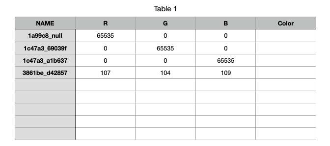

My script is now well on the way to doing what I want, which is largely to set Background color based on the R, G, B values in my rows.
To turn:
Into:
The script below does it as I expected it to.

EDIT: Figured it out, a simple IF/THEN fixed it, so now the Working Script is

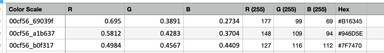

EDIT: I moved to using real data samples. the RGB values are from blender which is in the form of decimel values from 0-1, so I need to multiply that by the 65535 that Numbers uses for RGB. The IF/THEN doesn't account for the values grabbed being null, so I've replaced it with just a Try section to ignore the errors.
I could rework that to a different IF/THEN if needed, but for now it's good.
The new script is:
