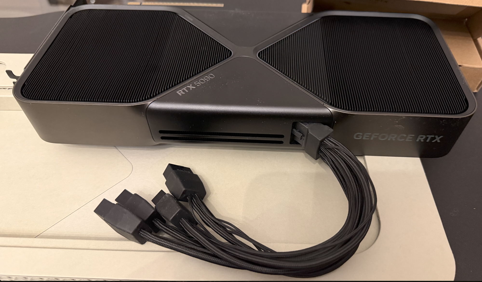

I finally decided to buy the RTX 5090 FE. I regret not doing so sooner, as I had doubts due to rumors of problems with burning connectors/cables. I also couldn't find any real-world examples of installing and using the 5090 on a Mac Pro 2019 on the forums.
I'm very pleased with the performance on Windows 11 25h2 (I'm a beginner here), despite the limitations of the outdated 12-core processor and PCIe-3.

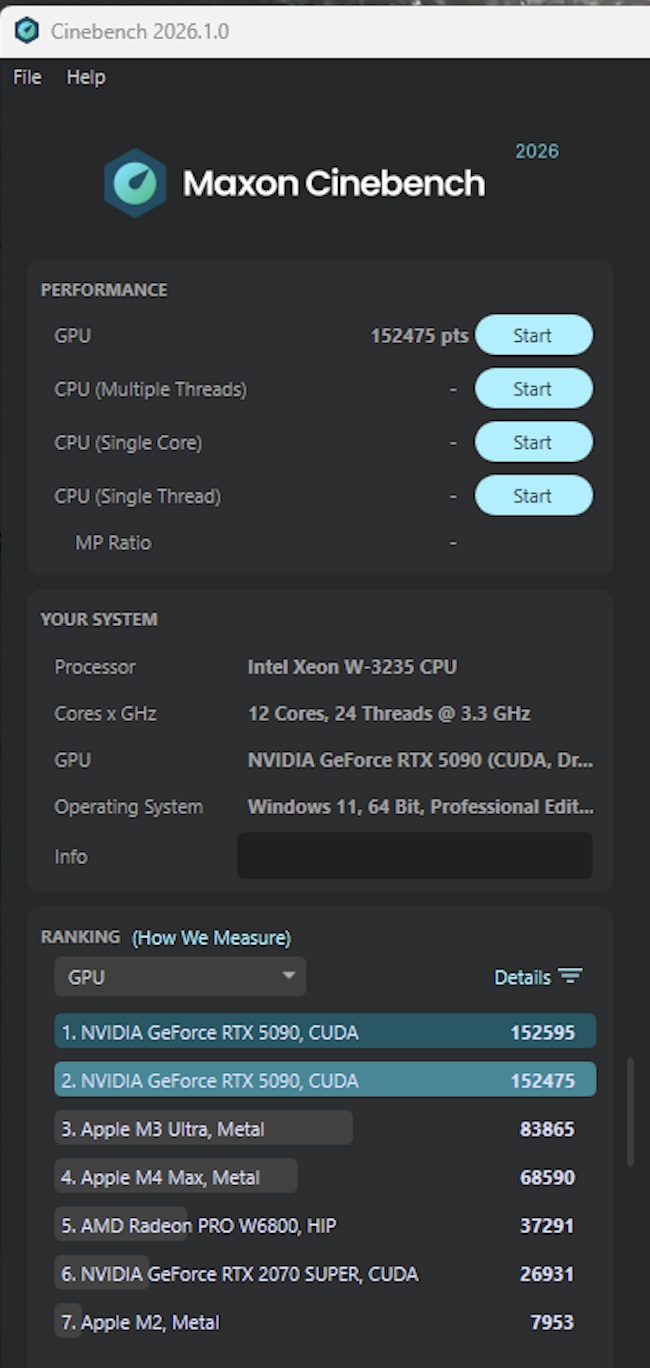

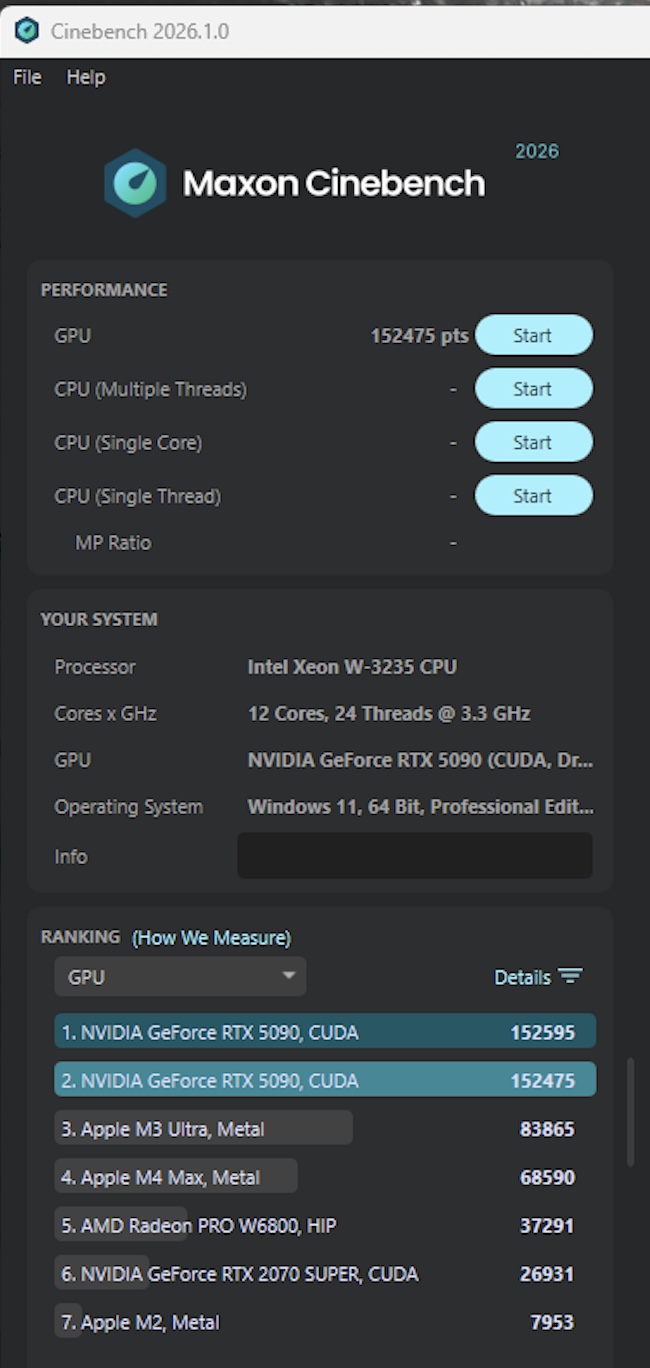

I installed the new Nvidia Studio driver, automatic settings, and tested the GPU only in Cinebench 2026.
The temperatures are not excessive for my tasks.
I installed the Amphetamine sleep utility on MacOS.
Any tips on debugging and settings, as well as cable fire safety, are welcome.

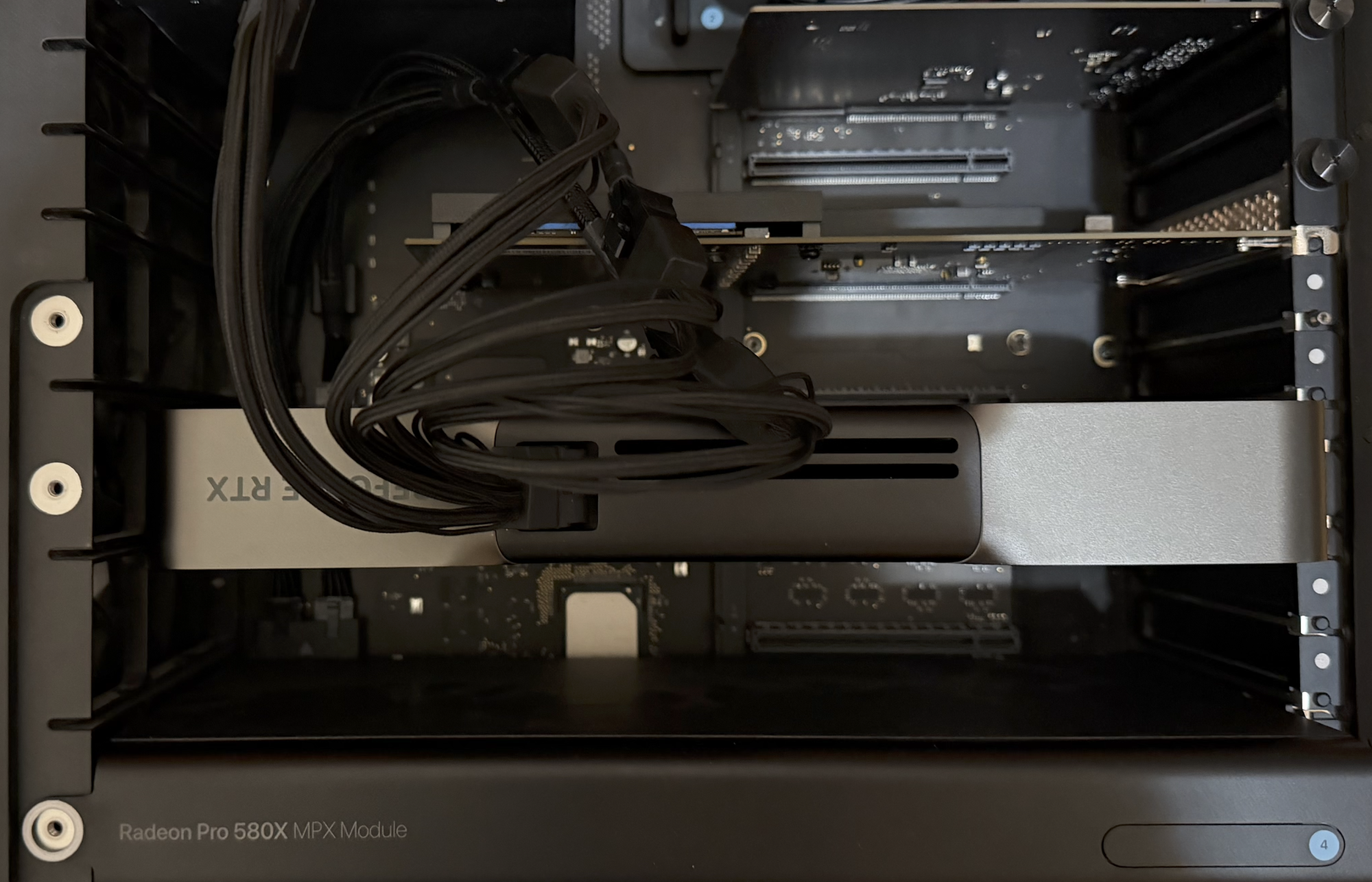

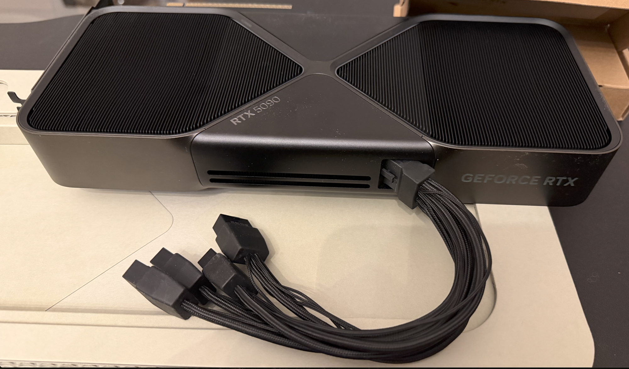

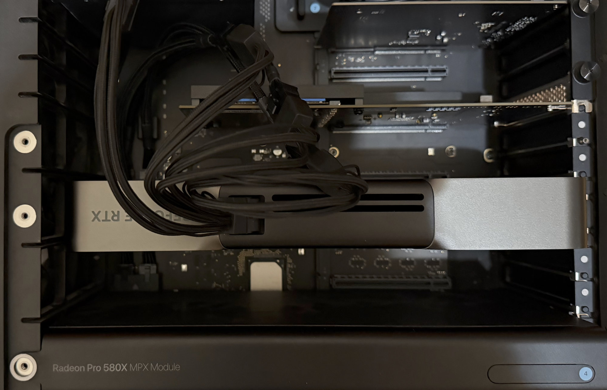

UPD: I used the original cable from the box + four cables from the Belkin Mac Pro kit. It might be a questionable decision, but I couldn't find any definitive information about which cable is safer for the Mac Pro.

BTW which AUX/power cables did you use? Have you run GPU stress tests?
Thanks for the question. I used the original cable from the box 5090 + four cables from the Belkin Mac Pro kit (I'll add to the first post). It might be a questionable decision, but I couldn't find any definitive information about which cable is safer for the Mac Pro.
I didn't run any stress tests; I immediately started exploring ComfyUI, and only last week I ran Cinebench. What tests should I run?

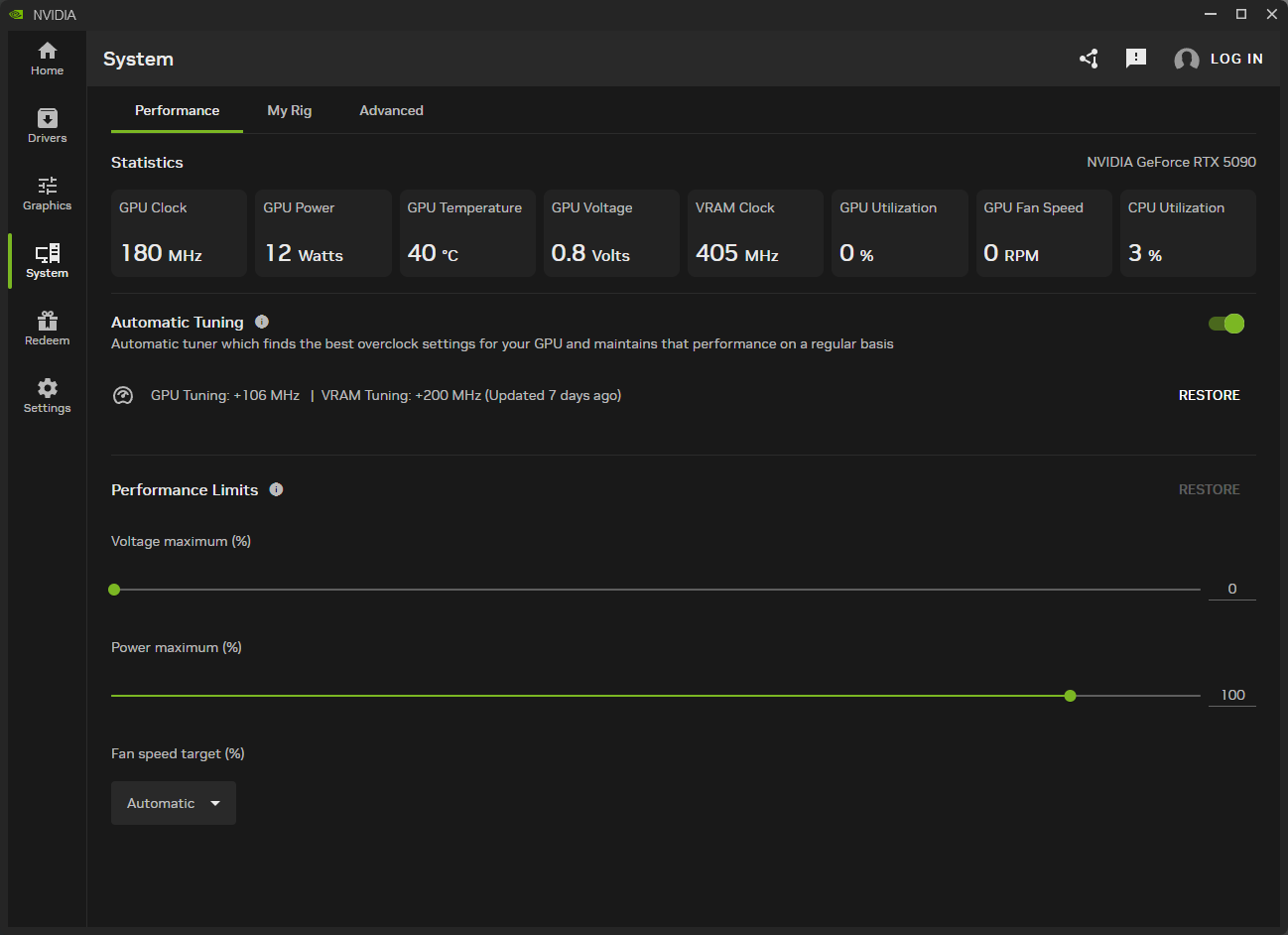

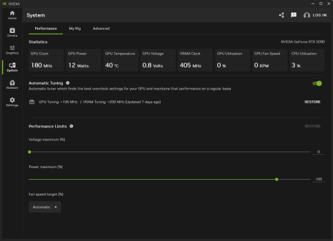

Probably some undervolting is also possible to save some energy.
Thanks, I'll look into undervolting.

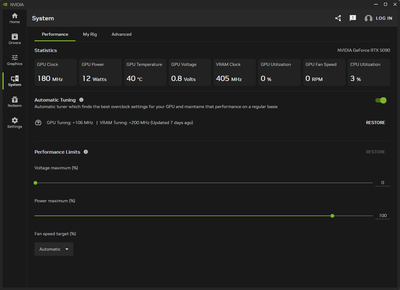

I saw that you can also reduce power consumption in the Nvidia App, but maybe that will also reduce performance?

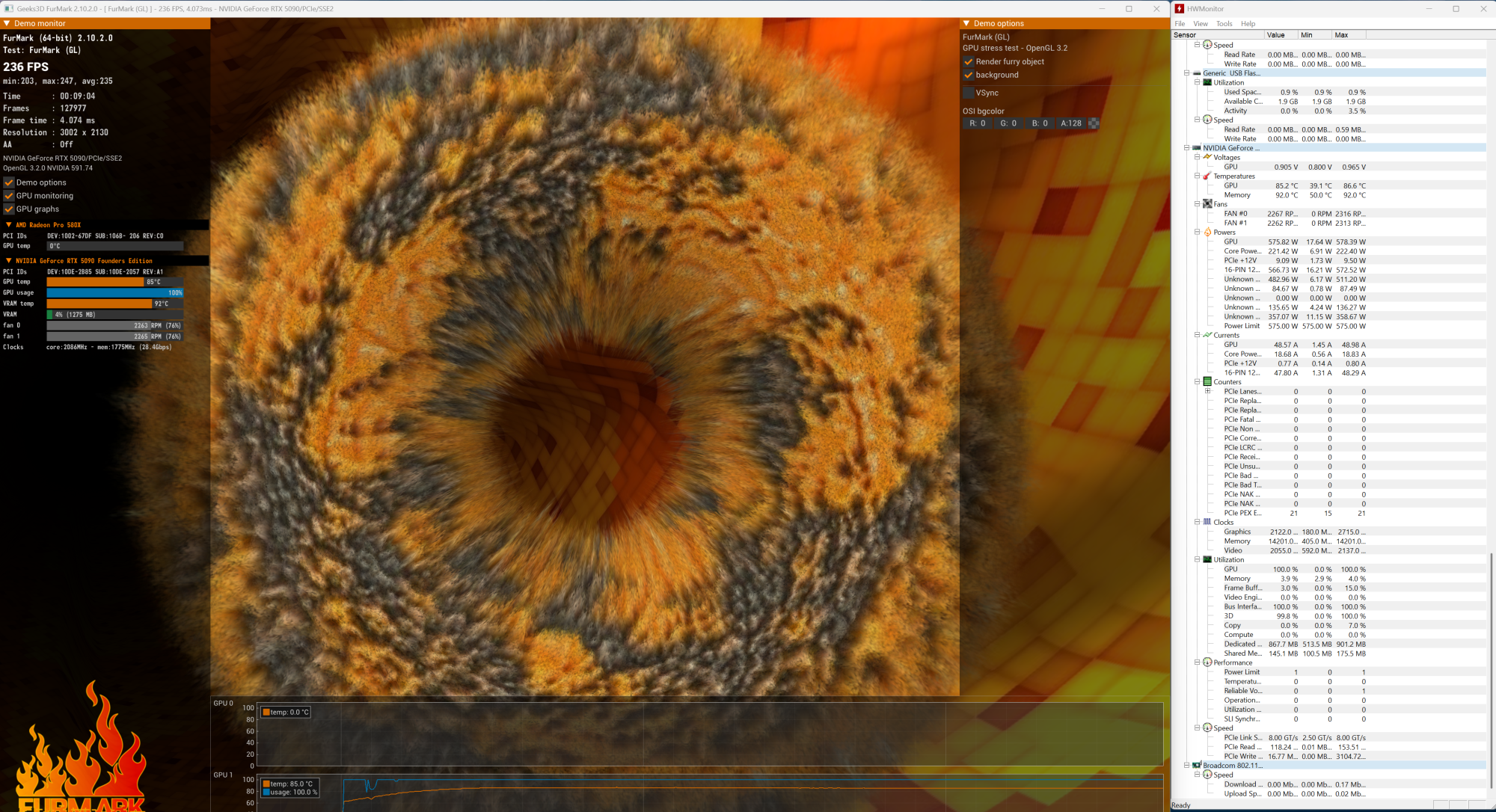

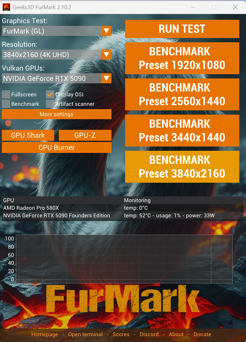

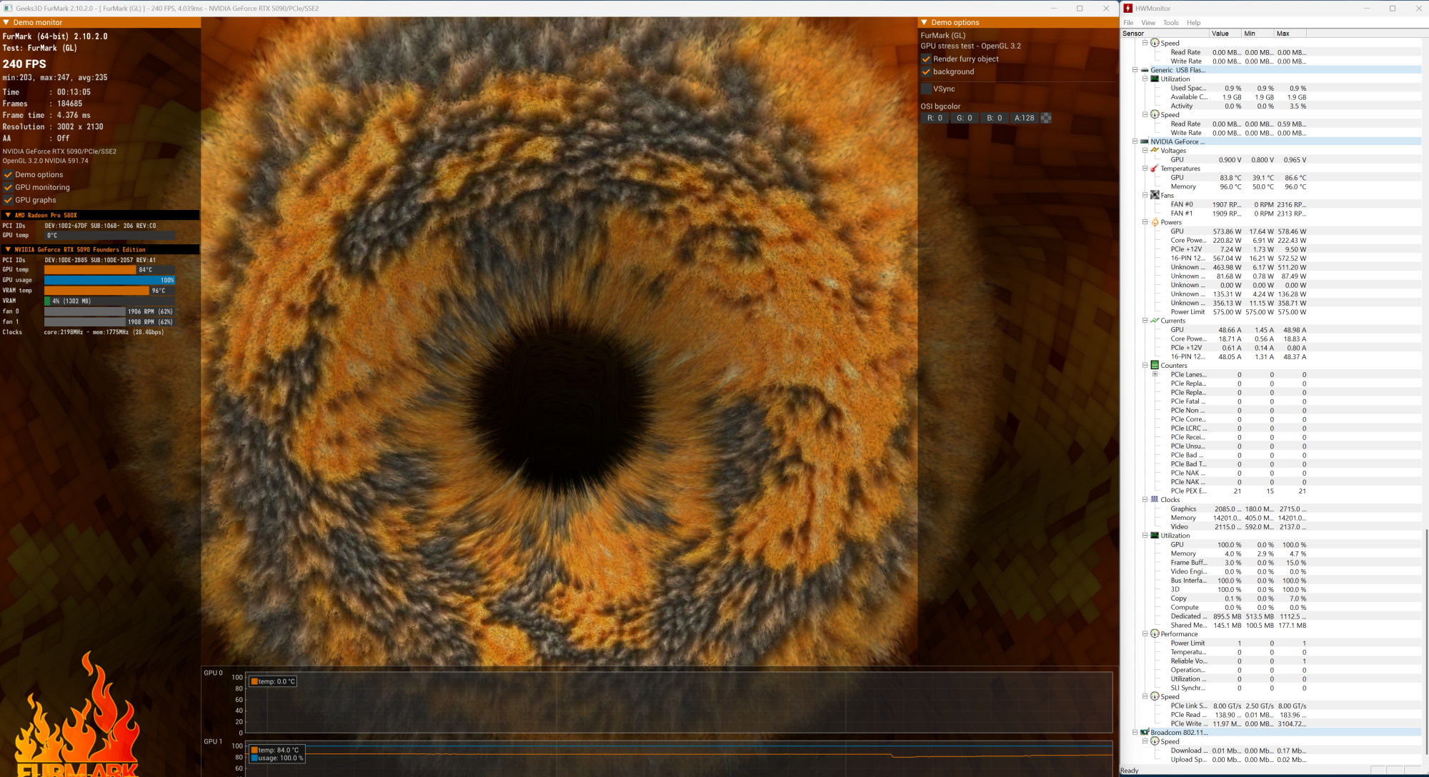

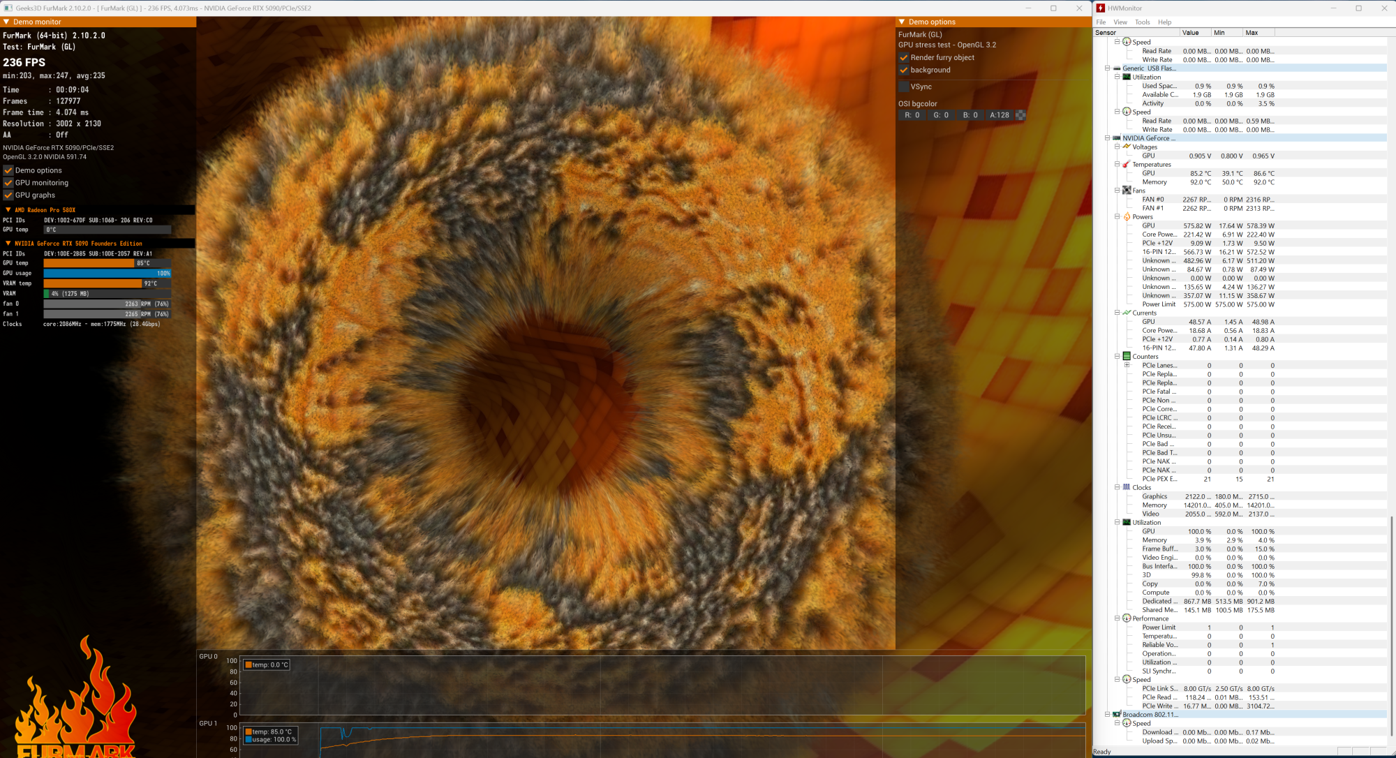

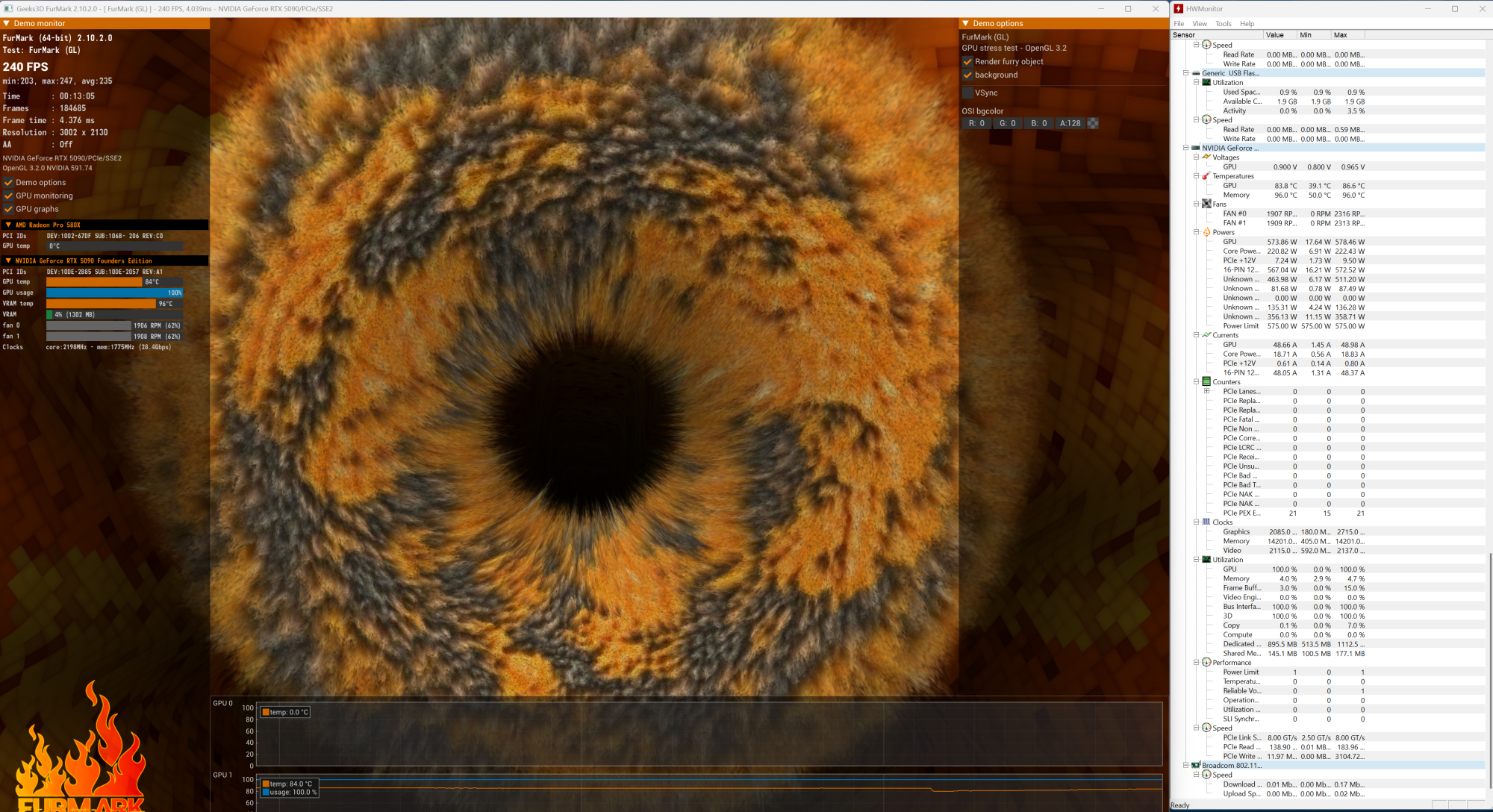

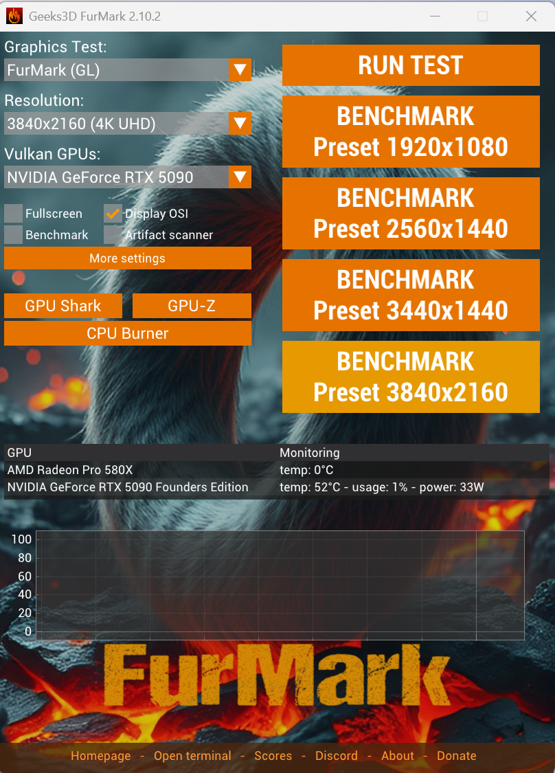

Furmark test, 15-minute. Check the temperature. Should I continue testing?
I selected 3840x2160 4K resolution in the settings, but for some reason it's displaying 3002x2160 during the test...
Upd: Got it, I should have opened Furmark full screen for full resolution. I'm a terrible tester.

See if you can run it for some hours and keep an eye on the temperatures in HWMonitor
From the looks of it, you are hitting 85C on the GPU and ~90C on memory, which all looks ok. I bet the system fans kick in and it gets louder, correct? It also seems to be pulling more than 575Watts from the AUX pins, which seems pretty normal, since it's a beefy card. The max from each 8pin AUX is 150 Watts so there's plenty of head room.
The point here is to maximize the power pull from MP Power Supply and see if it freezes the system or shows any glitches. I used to do heavy benchmarking when I used to build PCs, this is the best way to see if your GPU is not playing well with the system. FurkMark heats up the GPU

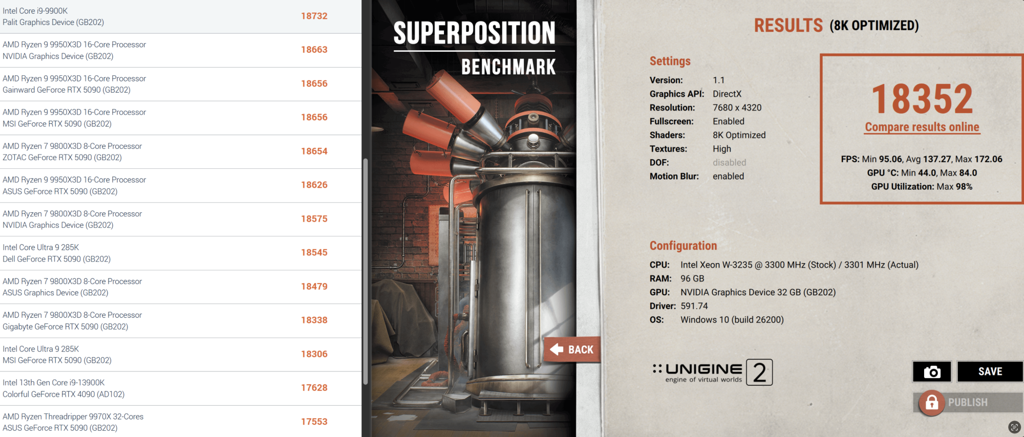

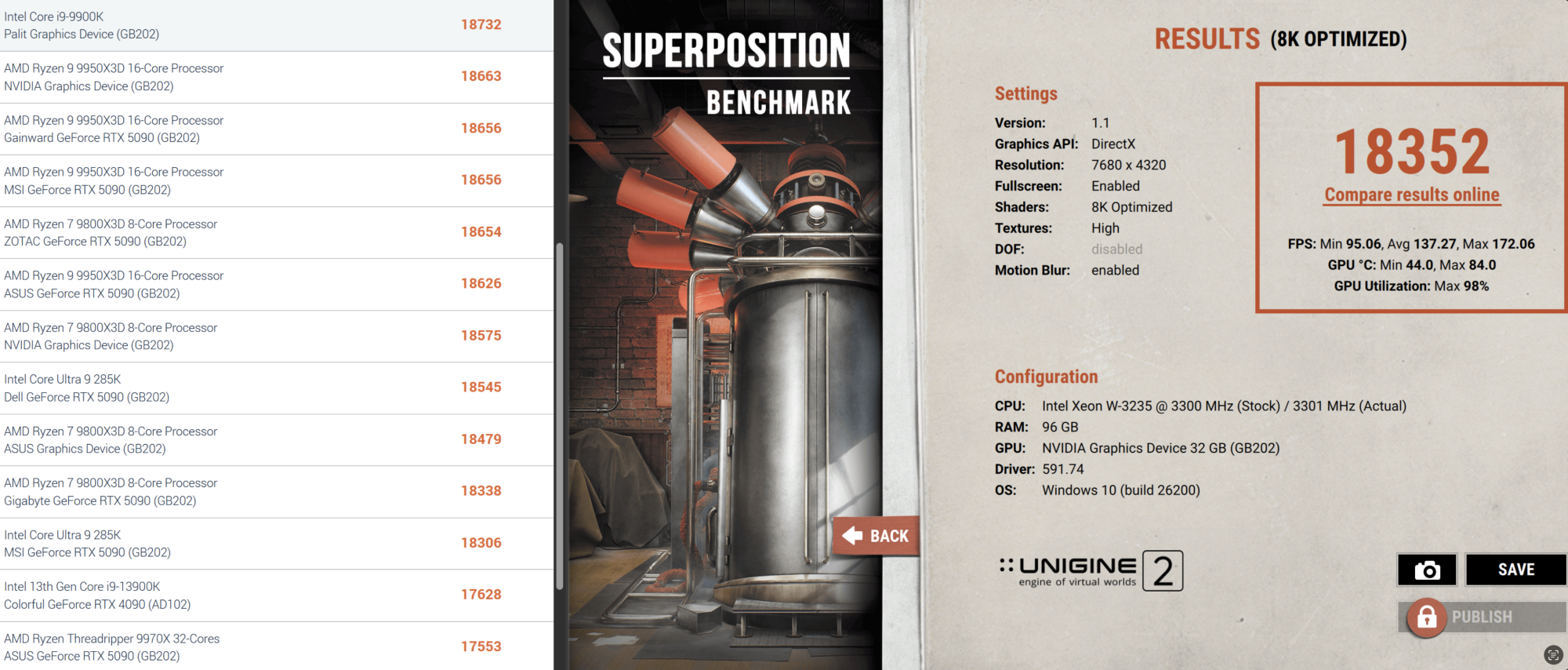

Unigine Superposition 8K benchmark.
Online comparison with other PCs:
There's a free version of 3dMark:
Also if you have any games you purchased already, especially recent AAA games, worth trying to see if it causes any glitches in continuous gameplay, I don't see it causing any issues tbh.
My biggest concern for you is PCIe 3.0, I think in certain scenarios you will see -10/20% of performance drop especially with the lower RAM speeds that these systems come with. But I think these cards are so fast that that drop is negligible.
Remember that the higher the resolution you game in, the less your game relies on the CPU. So let's ray you're running something at 4k vs 1080p, you will see GPU utilization more so than the CPU.
