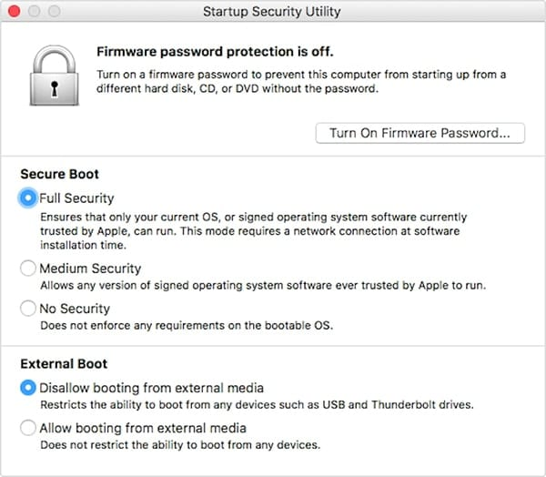

You have to disable Secure Boot in Recovery Mode if you do it this way, and Secure Boot cannot be re-enabled after installing Windows 11 (you can actually re-enable it, but you won't be able to boot into Windows anymore).
If you want Secure Boot enabled, the workaround I used was to install Windows 10 using Boot Camp Assistant while Secure Boot was enabled in macOS. The newly installed Windows 10 should then be signed and trusted.
In Windows 10, create a Windows 11 USB using Rufus. Once that's done, run the .exe file from the USB. I recommend using the clean install option ("Keep nothing").
Your newly installed Windows 11 should have Secure Boot enabled. Before reinstalling the Boot Camp drivers, make sure to turn off all settings under Windows Security → Device security → Core isolation, since some drivers are outdated and Windows 11 may block their installation.
Good point forgot about that. Can just set it to Not Security or Medium Security (I forgot if this will allow Windows booting, but it should) and then set external boot to "Allow booting"
However the way I personally did it was I had Windows 10 already and just upgraded to Win11 (without TPM2.0 enabled) all worked fine.
