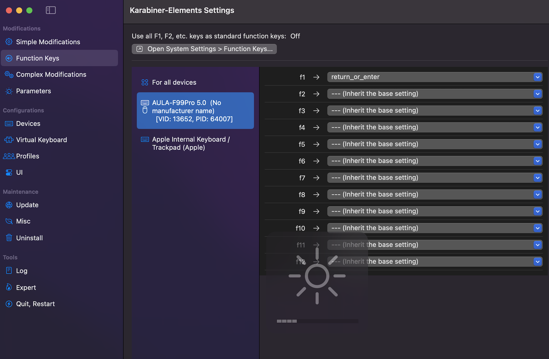

Unfortunately Karabiner doesn't help with the issue on my current keyboard. It has "hard-wired" F1-F4 part and doesn't change whatever I'm trying. :-(

What keyboard were you trying that allowed the change?

Oh that's bummer. I never tried it myself to be fair. I just assumed it would work since I've never read about people having that particular issue. I was pretty sure it would do it. Maybe drop an email to the developer and see if they have a solution.
