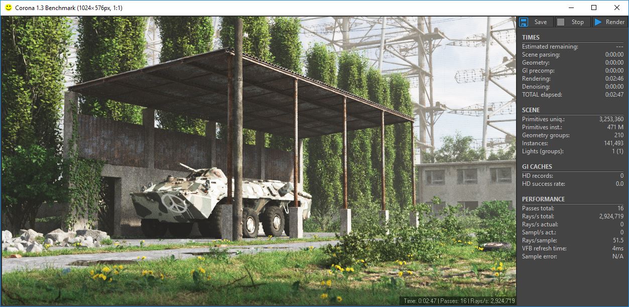

No your not your just trying to be smart, and playing with semantics. The 2018 MBP's may technically not throttle, equally they are not capable of reaching max performance, just like you were bragging how the 2016 model could hold full Turbo indefinitely, now the 2018 MBP has issue the narrative is a full 180...
Bottom line is the 2018 MBP design forbids maximum performance of the CPU, as under load it will roll back the CPU frequency to as much as base clock or less in some circumstance. The more pertinent question "is the performance on hand adequate for the users needs?". Like it or loath it the Windows systems will offer more performance due to better cooling solutions and simply more thermal headroom.
8th Gen 8750H with adequate power & cooling solution. This is a 17" equally many 15" notebooks accomplish the same, nor are they 10lb behemoths.
The 2018 MBP isn't a bad design, equally it's not a performance centric notebook by todays standards...
