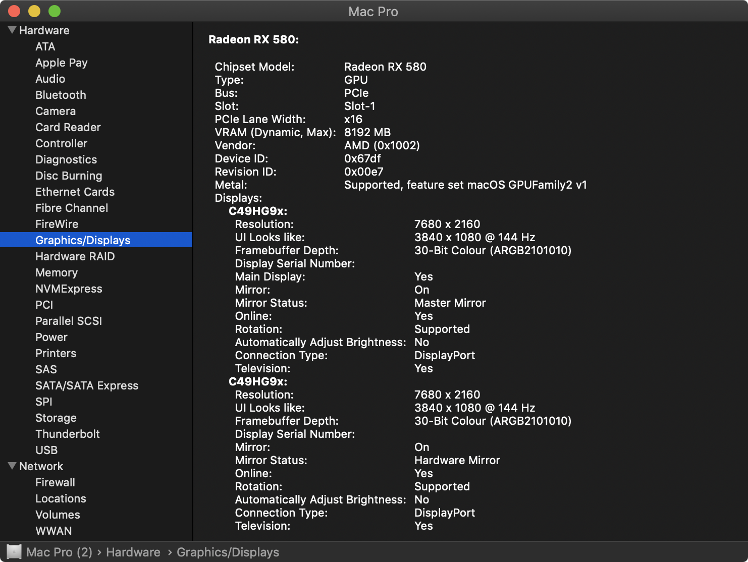

For example, the following is from my own cMP. As you can see, a RX580 can output 7680x2160 @144Hz (it's 87.5% more demanding than 6k 60Hz). There is no such monitor exist on the world when I made this screen capture. But it's because I enabled the HiDPI function, which makes the rendering resolution went beyond my monitor's resolution.
macOS can take this kind of order, and it is entirely normal. e.g. Many people use 2560x1440 HiDPI on a 3840x2160 monitor. So, macOS will actually render the screen at 5120x2880, then downscale back to 3840x2160, and send it to the monitor. But in macOS system report, you will only see rendering resolution (5120x2880), and UI resolution (2560x1440), and it won't show you the signal is actually transmitting at 3840x2160 (which means the monitor is fully utilised).
Also, different macOS version may have very different behaviour on those "non standard" resolutions. In some OS, everything shows up for user to select. On some other OS, you may need something like BetterDisplay to select what you want. In some extreme cases, you may need to build the entire profile in SwitchResX in order to use the exact resolution you want.
