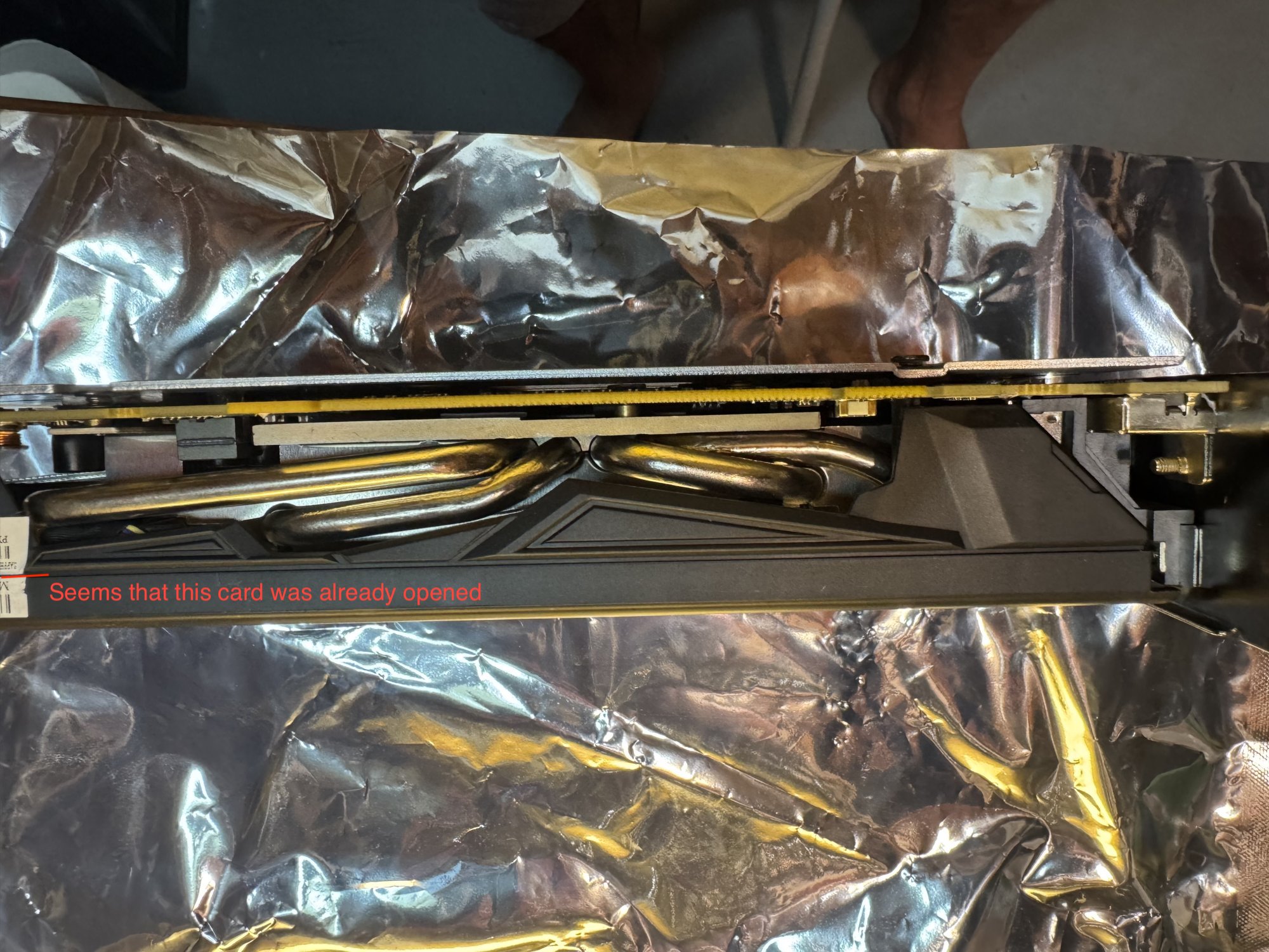

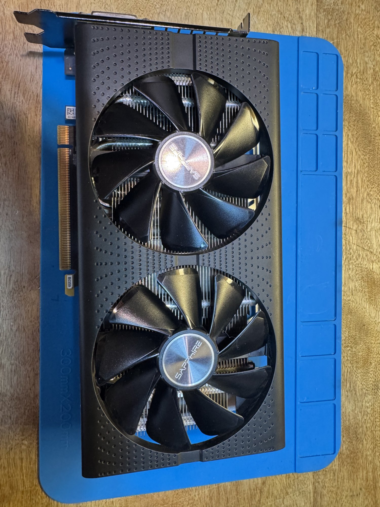

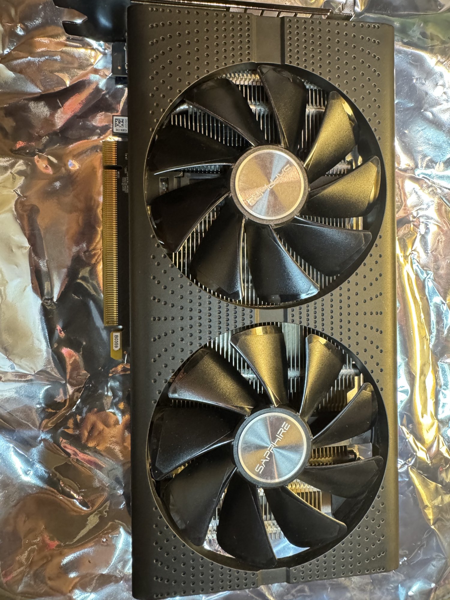

Dear friends, this is a little off topic and I don’t even know if this is the right place, so I apologize before hand. I just received my Sapphire Radeon 580 RX Pulse. I was able to buy one from Amazon as a refurbished, I could not afford a new one. It looks very nice but I’m still waiting for the connectors to arrive so I can install on my Mac Pro 5.1. I It will replace my old NVIDIA gtx 680 Mac edition. My question is, I’m not sure how much this gpu was used, it does look clean but still don’t know. Should I replace the thermal paste just on the safe side? Not sure. I have the NVIDIA for maybe 10 years and never had a problem but I always kept dust free. Thanks as usual.
Not until you are sure that the GPU works correctly, for now just clean it with compressed air.
Reactions: Marcosmg
Thanks, you have helped me a great deal throughout these years with my Mac.

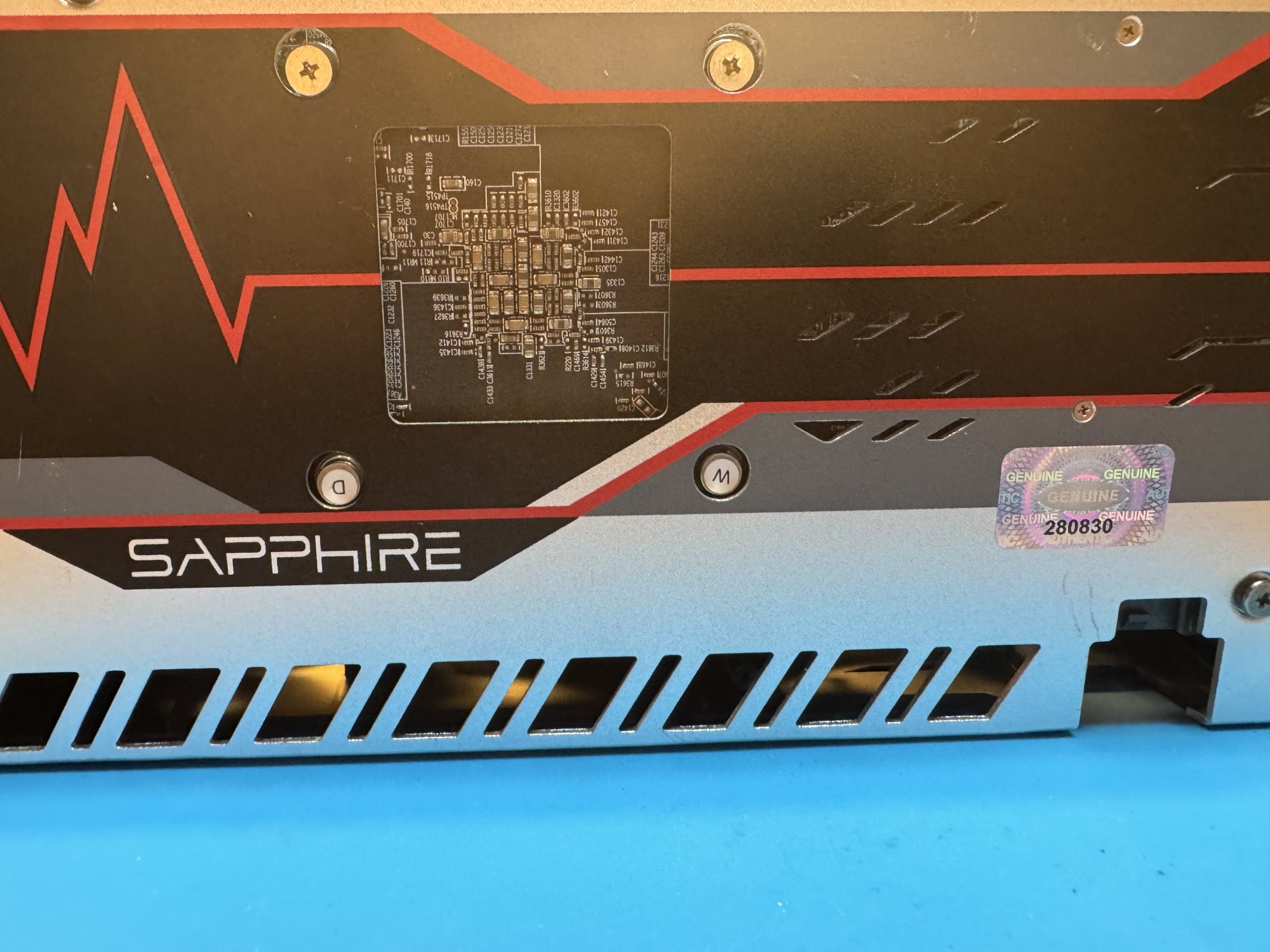

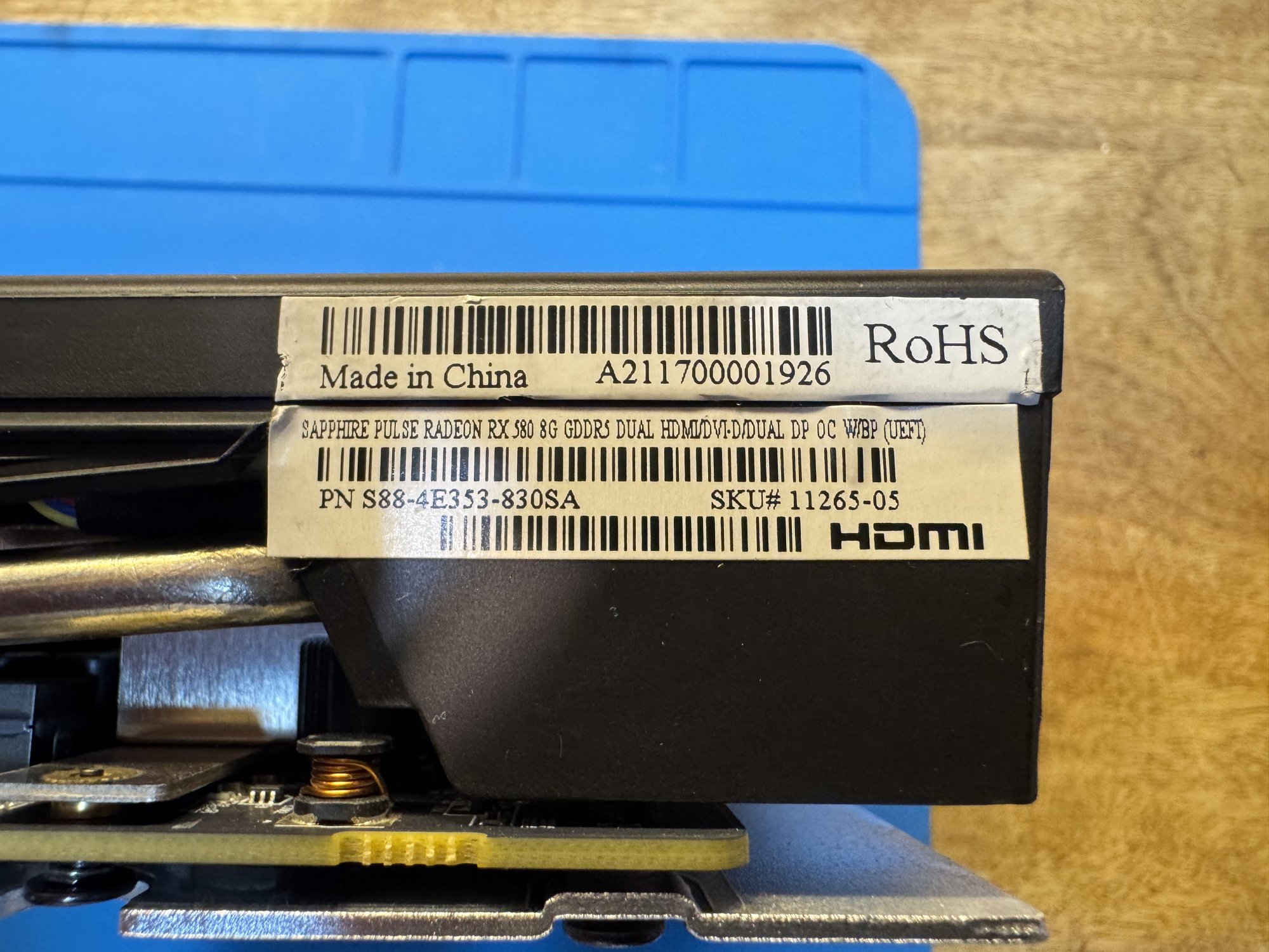

Btw, post a full picture of this label, seems that this card was already opened:
Sometimes there are two labels there, mostly on older Sapphire Pulses, but on more recent ones have only one label that rips when you remove the heatsink assembly.
Dang! You are right, it seems it was opened before. Everything looks really good just a little scratch on the back plate. The top and fans look new. I paid $119.00 for it and I have 30 days in case it doesn’t work. Not sure what to do now, the ones from eBay are about the same price. New ones are outrageous expensive.

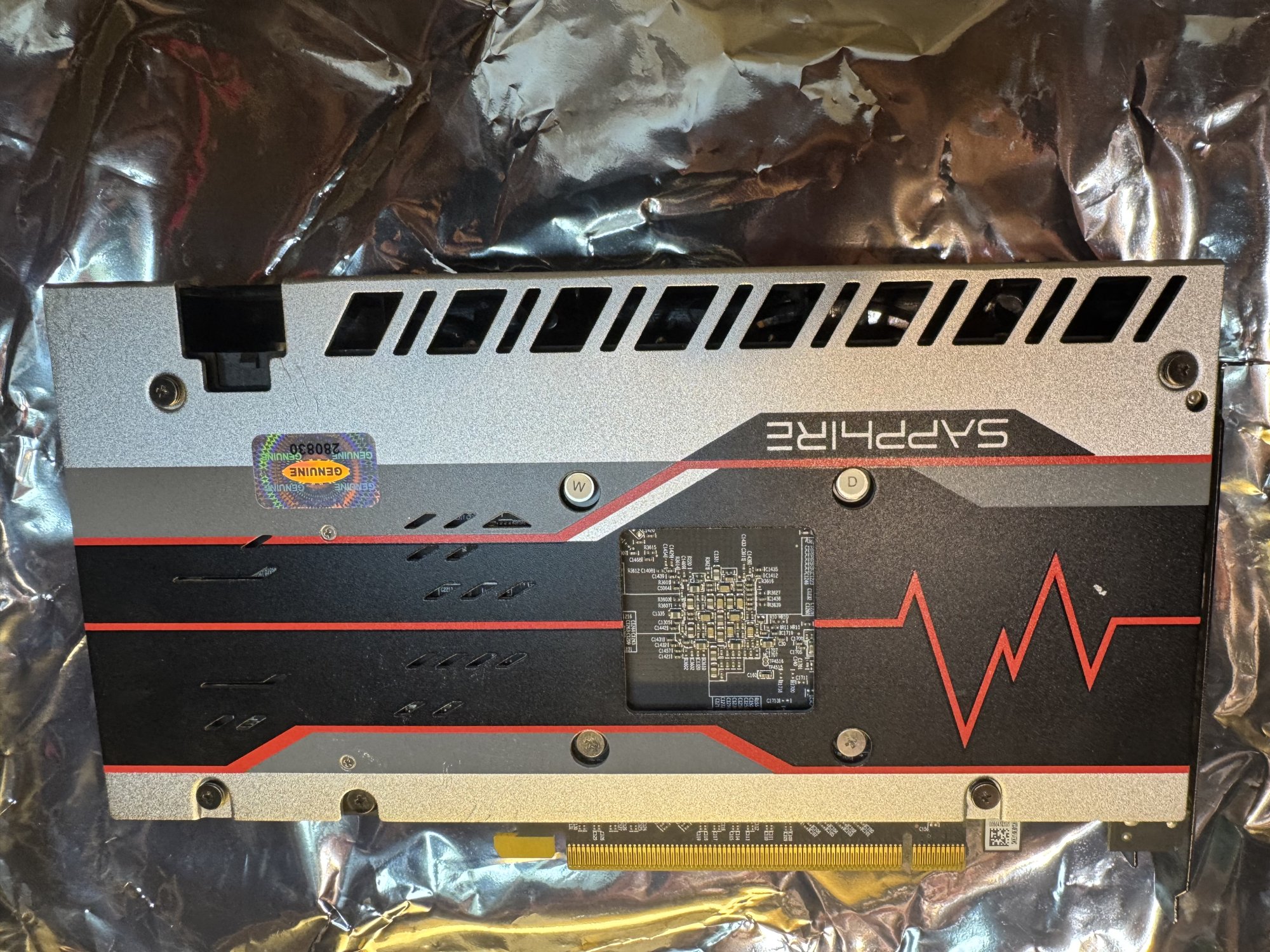

This is a older Sapphire Pulse with DVI connector and still with the two labels.
So, not so easy to say that it was opened like the newer ones where the label rips when you open the heatsink assembly.

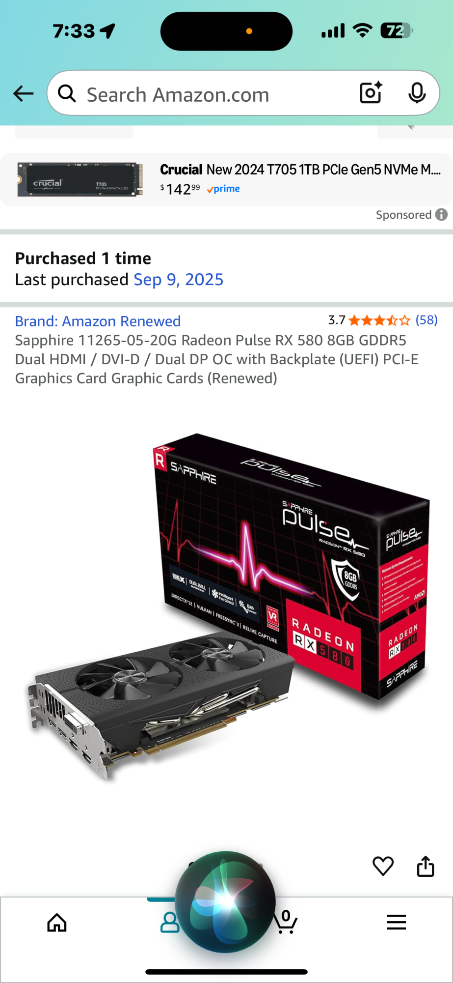

From the Amazon page, the card is a renewed one, so is very probable that it was opened/inspected, replacement tamper-proof adhesives applied, but the GPU seems in very good shape for a second hand or open-box one and from the label, is a 2304 SPs and Mac Pro compatible.
Test the hell out of it and only open it when the warranty expires.

I’m sad, installed the card, but it doesn’t work. At one point it started on Monterey but not in Ventura. Pressing the option but nothing shows. Reset the SMC twice, PRAM multiple times, tried hdmi and dvi, nothing.
I woke up today so excited about the installation but now I’m feeling pretty bad. Maybe the previous owner flashed the card for something else. I don’t know. I don’t have PC at home to check or reflash this card. Spent about 3 hours. Going downstairs now and eat some Taco Bell to see if I feel better
OCLP does not allow you to change the GPU, drivers for any other GPUs are removed.
You need to test with a clean install of Mojave, without OC or OCLP, completely vanilla.
Just one last question, should I remove the 580 and put the 680 back and than install Mojave and install the the 580 back?
