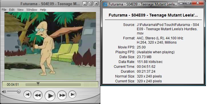

I just convert everything with quicktime
@152Kbps H.264 [2 Pass] & 64Kbps AAC and I get about 22 min of video at under 25MB and it looks fine to me. A little but blurry at certain times, but totally watchable, and not to mention I got all four seasons of Futurama at under 1.75GB

Yes, I use my Vista machine for rendering, my Mac laptop just isn't fast enough [Still love it more though...]
