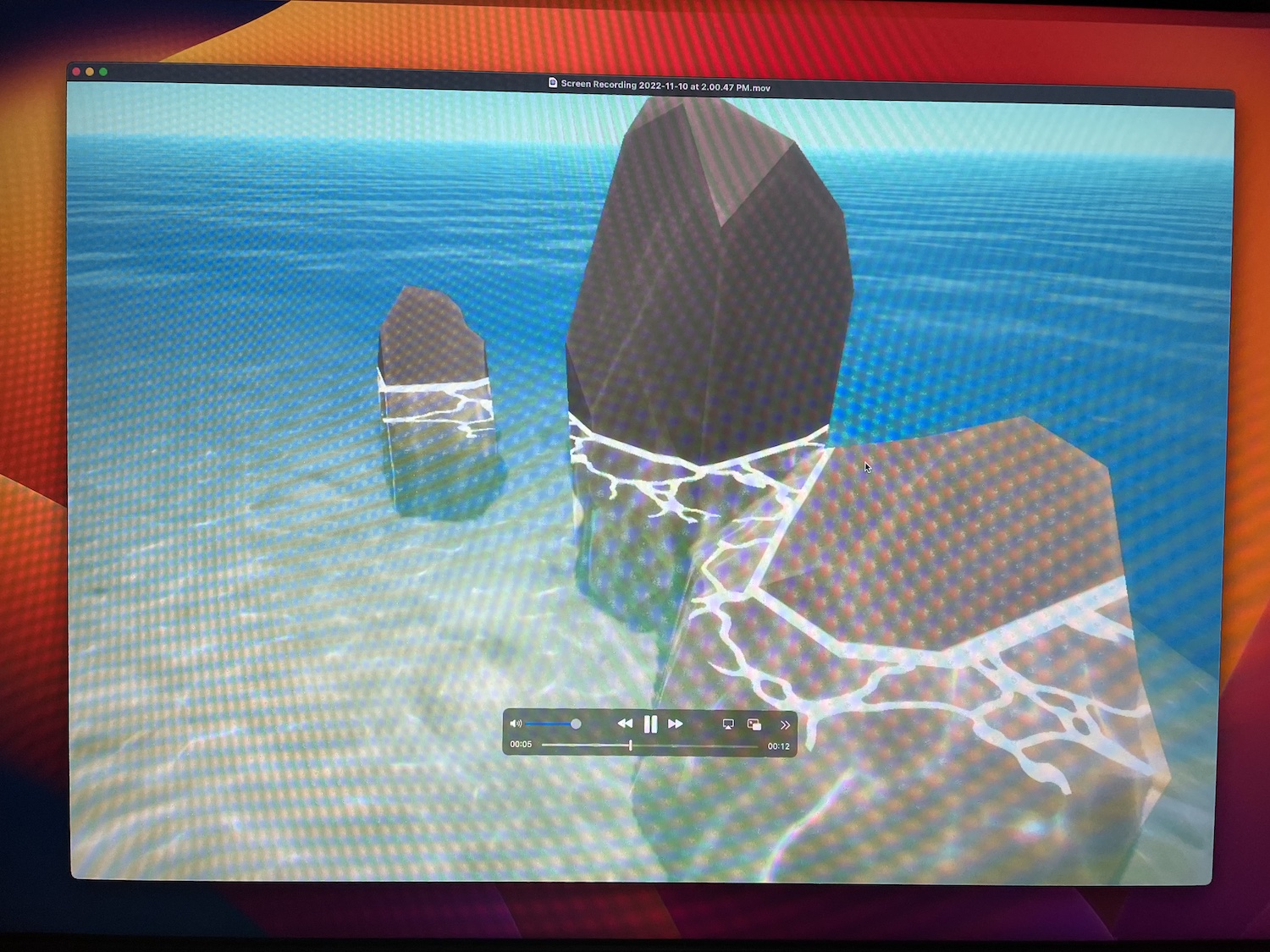

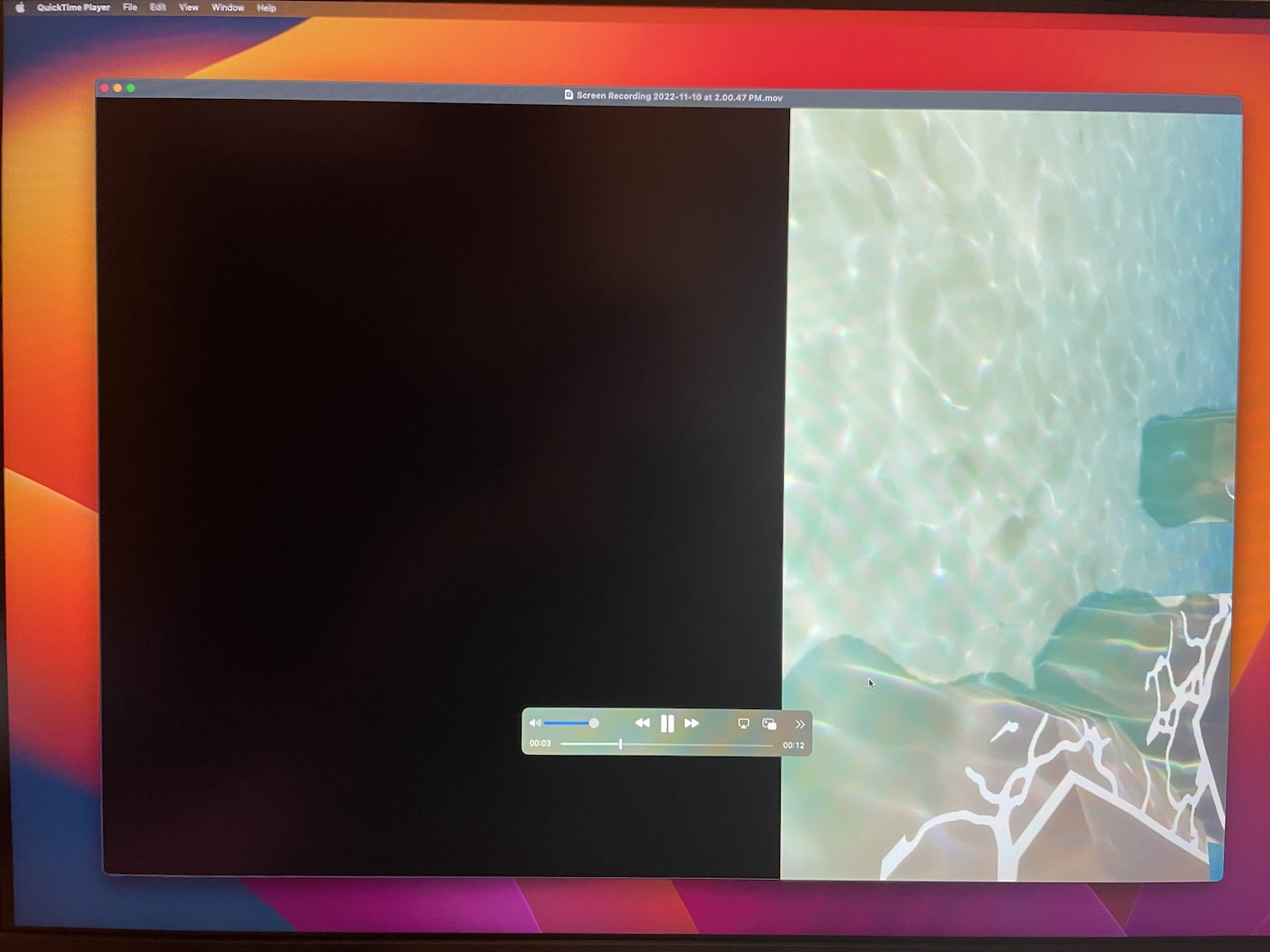

This is a strange bug that popped up after updating to 13.0.1 - videos (whether played in QT or in Safari (like YouTube)) all rotate 90 deg clockwise and clip outside of the player!
Moving the mouse will immediately correct the video, only for it to glitch again a few frames later. What's more interesting - taking a screenshot does not show the effect, so I had to take a picture of my screen with my phone. Using an external monitor, but it happens both on the laptop screen as well with no monitor attached. Very weird!
Anyone else experiencing this? (M1 MBP)

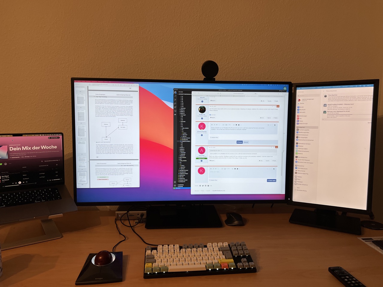

Same problem on my MacBook Pro M1 16 inch on 13.0.1 with two external Monitors connected.
Addition: one of the two external monitors is vertically rotated!
Here is an image of my setup. But the fix posted here seems to work. I have to rotate the vertical display output to horizontal and then back again to vertical which is annoying but better than having to reboot the system.
That's my setup currently! MacBook closed with two external monitors (one vertically rotated). I did the rotate trick mentioned above and since then it's been fine! Hope it helps you too
