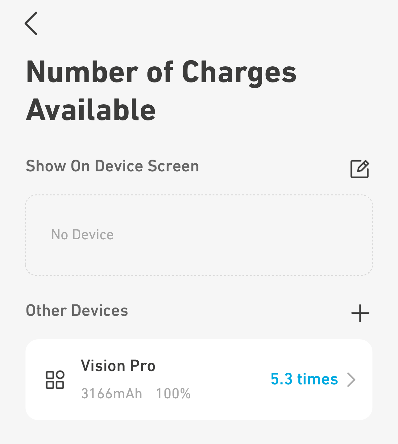

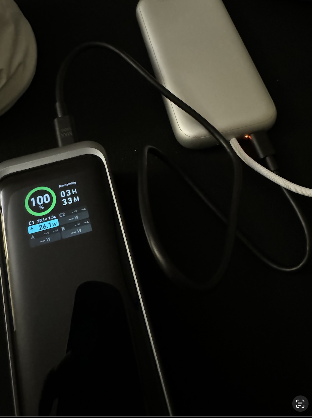

Am successful in charging the battery on the avp with the anker prime 27650K battery. Also according to the anker app for this model power bank, based on the mAh of the avp battery, it can charge it just a bit over 5 times with a 100% battery.
the avp battery was plugged up to the goggles for about 8 hours in the puffy bag case in standby, so some battery power was deleted -- i just don't know how much. when i plugged up the power bank to it, it was about 26w going into it.
Hate to be the bearer of bad news. It that maker batter will not charge your avp anywhere close to 5 times. Not even 2 times.

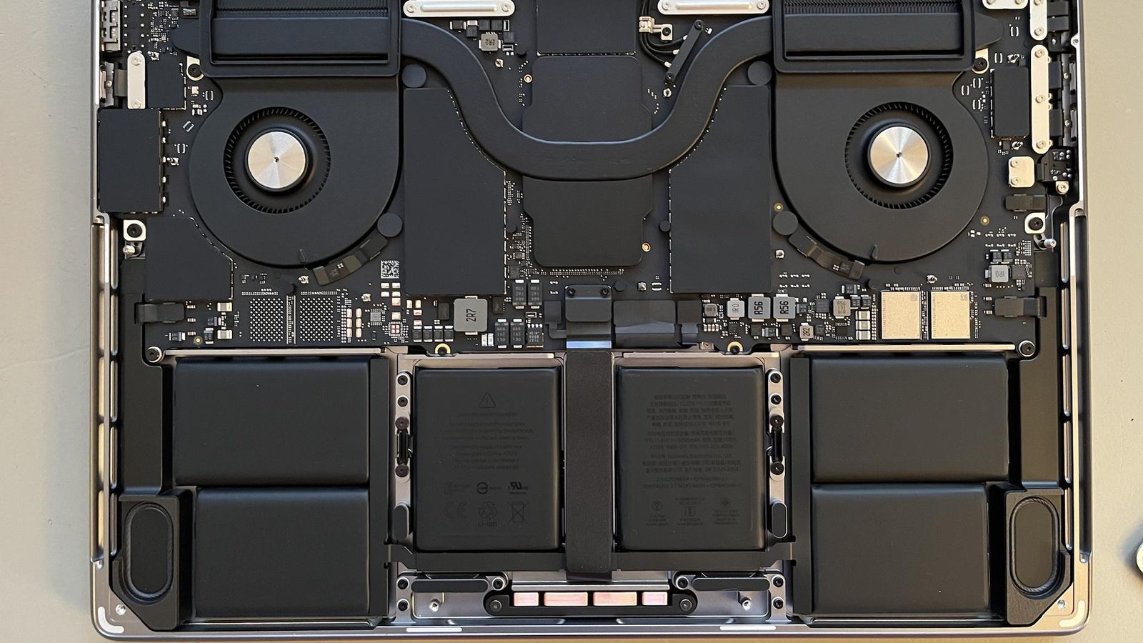

It's not as simple as calling it "3x iPhone batteries" - in that case, my MacBook Pro 16 uses "6x iPhone batteries" - that's just what batteries look like. They're wiring them in series, not parallel, because they need the voltage. If they had made it a USB-C port on the battery, the battery then has to be designed to work like a regular power bank for other devices, most of which will malfunction when exposed to 11.4 volts. It's not Apple's job to design you a general purpose power bank - it's Apple's job to fold up a MacBook Air M2 battery, retain the exact voltage, and use it for AVP whose specs are very close to the MBA M2.

It's not as simple as calling it "3x iPhone batteries" - in that case, my MacBook Pro 16 uses "6x iPhone batteries" - that's just what batteries look like. They're wiring them in series, not parallel, because they need the voltage. If they had made it a USB-C port on the battery, the battery then has to be designed to work like a regular power bank for other devices, most of which will malfunction when exposed to 11.4 volts. It's not Apple's job to design you a general purpose power bank - it's Apple's job to fold up a MacBook Air M2 battery, retain the exact voltage, and use it for AVP whose specs are very close to the MBA M2. View attachment 2346835
It's just 3x iPhone batteries. Do you know what 3rd party batteries are using? They are using bigger battery cells.

I can get my MBP to consume over 100W globally pretty easily. Third party power banks are not using 11.4v setups.
