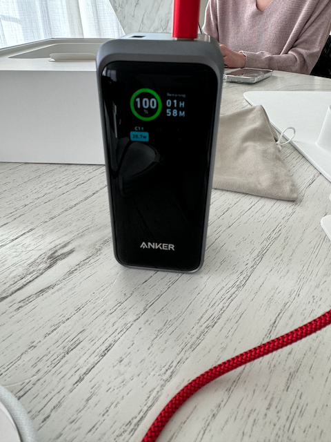

Not sure how charged the AVP battery comes out of the box but plugged mine into my Anker power bank and is charging just fine. It's drawing around 30W from it.
For safety reasons, batteries are shipped at a "low" charge, and so it's probably shipped in the 20-50% charge range. Whatever your charge level was, it's nice to confirm that the AVP battery uses 30W.
My AVP battery went down to 20%, so I pugged it into an Anker Power Bank with the capability of outputting 140W. The display on the Anker went to around 49 watts.
Was the AVP in use at the time? I wonder if the extra ~19W went to the AVP instead of the battery.

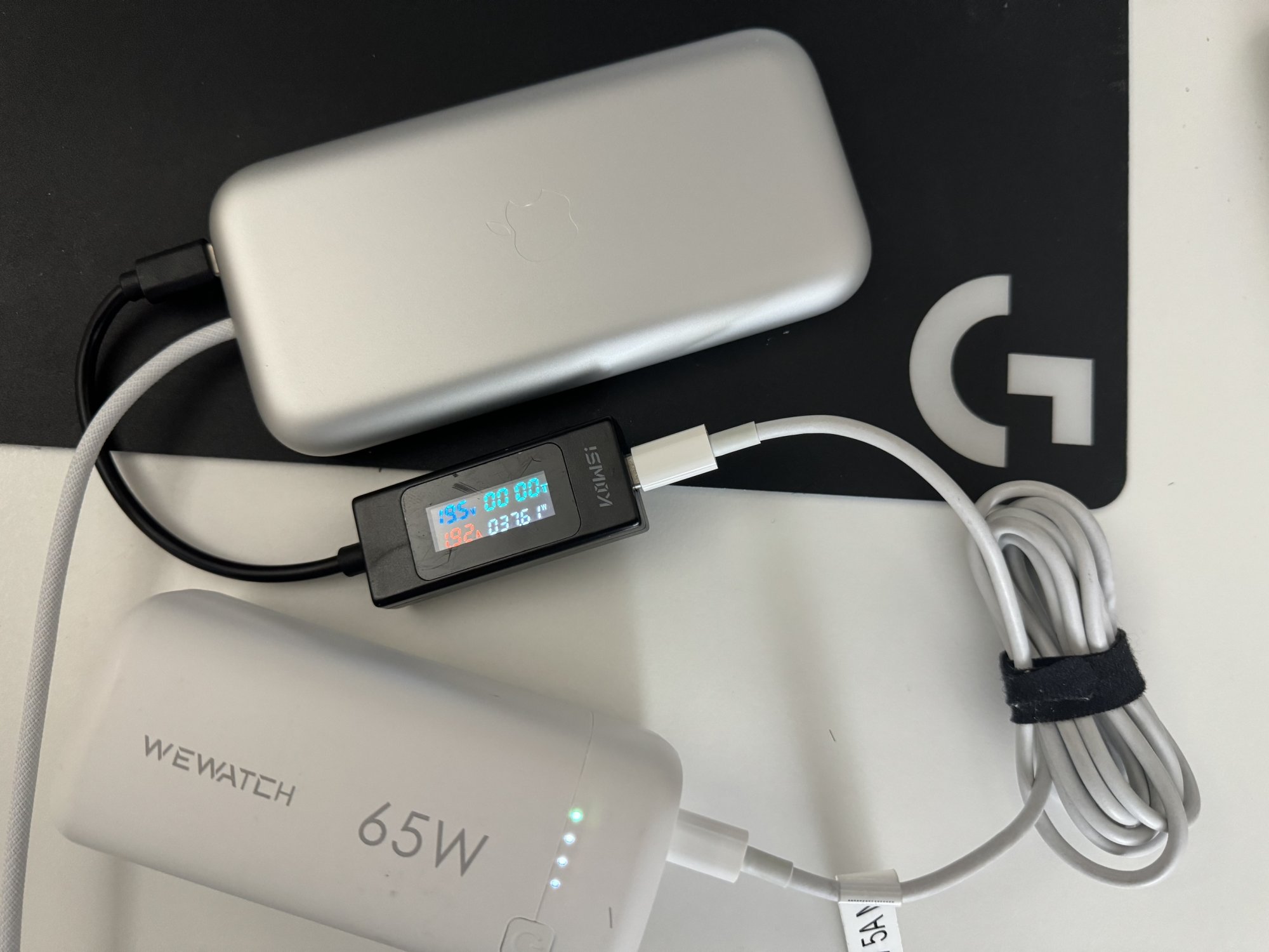

Here's a photo of the AVP battery at roughly 57% being charged by a USB-C PD power bank with a maximum output of 65W (I am not endorsing this power bank! It just happened to be within reach).
The glare makes it a bit hard to read, but it says 19.5V @ 19.2A. 1.92A (sorry for earlier error)
It definitely supports the 20V USB-C PD spec, and it seems there's a lower bound for the maximum charge rate at 40W.
Was the battery connected to the AVP? Any power measurements need to be done while the battery is disconnected, otherwise you have some unknown amount of power also going to the AVP.
19.5V at 19.2A can’t be right. That’s 374W — the battery would probably be burning up ….
Just because a battery can output 30W doesn't mean the rate at which it can be charged is limited to 30W (or alternatively, just because Apple provide a 30W charger doesn't mean the battery is limited to that wattage input when charging). The Anker power bank is probably just charging the Vision Pro's battery charger faster than were you to plug it into the wall socket.
While that’s true, the numbers are misleading if the battery is connected to the headset. if it is connected, we don’t know how much went to the battery and how much went to the AVP. We only know that the total was 49W (and I did make a bad assumption that the battery was using 30W).
No it wasn't connected to the AVP.
Sorry yes you're right, my bad. I was lazy doing the math, it's 1.92 A.
