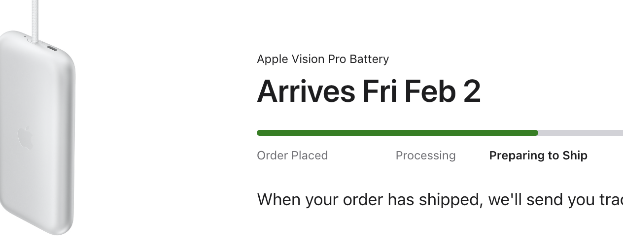

Or you spend $200 for an extra battery like I did.
Too bad it does not offer hot swappable design.
I'd have to shut down and then restart with the extra battery...
