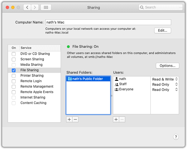

Yes, I have File Sharing turned on (although it is only showing the default Public folders - but I can change that). Also, I see this "Computers on your local network can access your computer at:
XXXXX-MacBook-Air.local"
on the file sharing panel so I wonder if that's needed and if so, how to do it.

Make sure you have the latest version VLC for iOS/iPadOS, as well as Big Sur. On your Mac bring up "System Preferences" and tap on "Sharing"(add the folder you want to share if its not just the Public-folder of the user you want to use).
Tap "File Sharing" to uncheck it wait a couple of seconds then tap it again to re-enable it.
Now try to connect again with VLC.

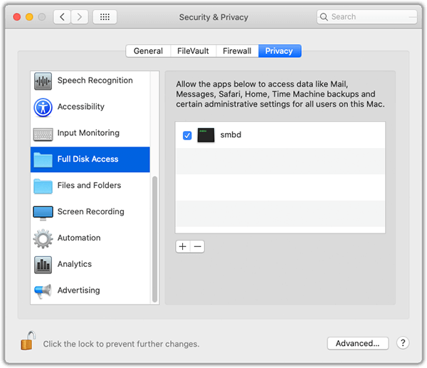

On your Mac bring up "System Preferences" and tap on "Security & Privacy" then tap Tap "Privacy" and then select "Full Disk Access" from the list on the left.
Tap "smbd" to uncheck it, wait a couple of seconds then tap it again to re-enable it.

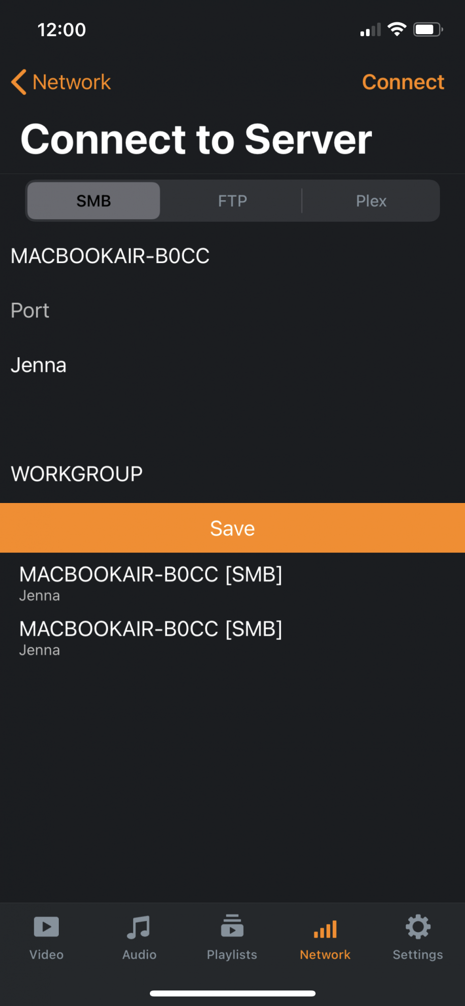

Hi again. So the first time I tried your suggestions, Slartibart, doing both steps, it was a little different, it went on to the connection step but the little orange clock icon kept on going round and round and round..... for 10 mins. So I restarted the iPhone, restarted the MacBook, ensuring that the VPN was off. Removed and re-installed VLC for Mobile from the App store and tried again. First time I got the SMBv1 again. Did this all again and still SMBv1. The odd thing is that the removed/ replaced app seems to have remembered the 2 connection settings I entered originally (one with user and password, the other with that long file sharing name and password) and I can't get rid of them as maybe that is now causing the problem...(you would think that VLC would allow me to clear or reset them?). Don't know how to make this image smaller.
Sorry, very large image - screen capture from phone. If only Onkyo would ignore the lock screen I would give up on VLC and just use that. I paid the extra $ and it plays my hi-res 96/24 files really well.

Hey! Guess what, I did it. Here's the solution. In File Sharing, click Options and select the account to allow sharing. It will prompt you for the login password. Then, when SMBv1 Auth comes up on the iPhone VLC app, enter your username and password. I did that and can now see the shared folders on my MacBook through VLC on my iPhone.
