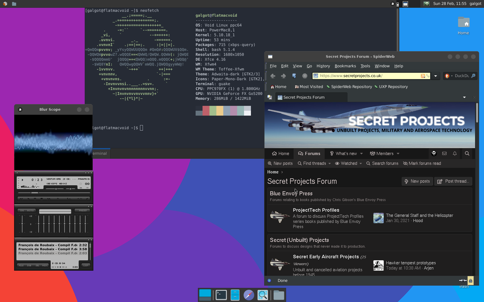

Have no idea what was happening here. Anyway, a screenshot for celebration :
My impression about Void PPC so far. I find the install to be very easy and simple even if very different from debian like systems which I'm more used to. It's a bit more BSD like. I use XFCE4 now, but find window redrawing quite slow. Have to reinstall LXDE cause I have something broken there.

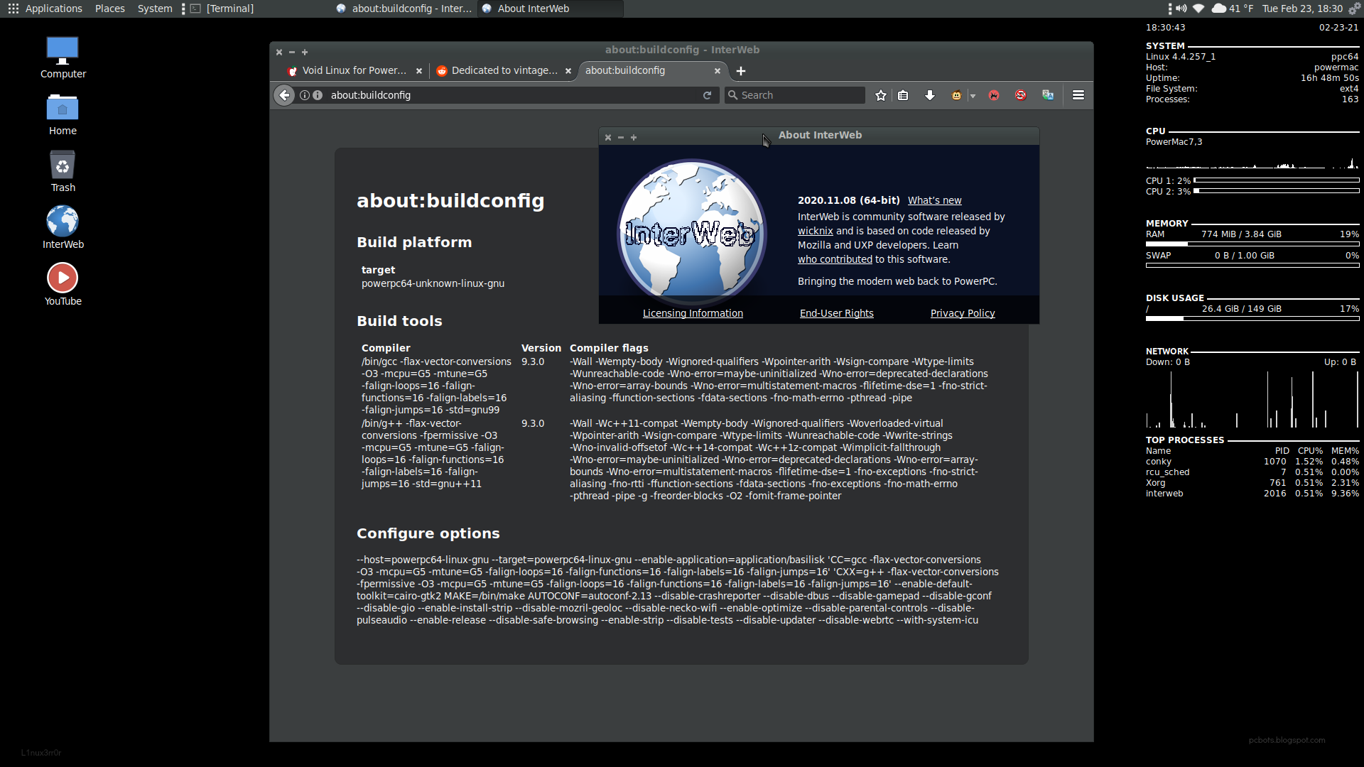

I've found Mate and IceWM to be the most stable. Xfce has issues, KDE plasma has issues, and Lxqt has issues in my testing. I've also noticed window drawing is laggy on my dual 2ghz G5. Doesn't matter if the compositor is turned on or off. Better with it off, but still not perfect. Probably due to the nvidia geforce fx5200 (but its fine in ubuntu/debian). As it's a rolling release it seems not much is really tested. If it builds it gets added to the repo. I've run across a few packages that just crash on startup (gnome-twitch for example). I've had to reinstall 3 times now after updating, then powering down. Upon reboot, same issue. Black or white screen, fans on high. Sometimes i can get it back by booting the old 4.4 kernel, but sometimes even that doesn't work. Sometimes resetting the PRAM fixes it, others it doesn't. I've finally got a stable system, and i will no longer do full system updates. I locked my current kernel in place, and if i need to update a package, say firefox, i just install that with it's deps, and nothing more. So far so good. Luckily that machine also has ubuntu on it so i've been able to retrieve any documents, music etc from a broken Void before reinstalling. Oddly on my 32bit systems, it's been rock solid. Go figure.
The only real downside to you using the musl build, is that you have no access to arcticfox, interweb, or spiderweb. All of which display properly with no graphical glitches. I only use firefox for 2 websites that give the others the finger. Epiphany only renders 3/4 of a page with the entire right side cut off on both my 32 and 64bit installs, and it's slow as molasses anyway.

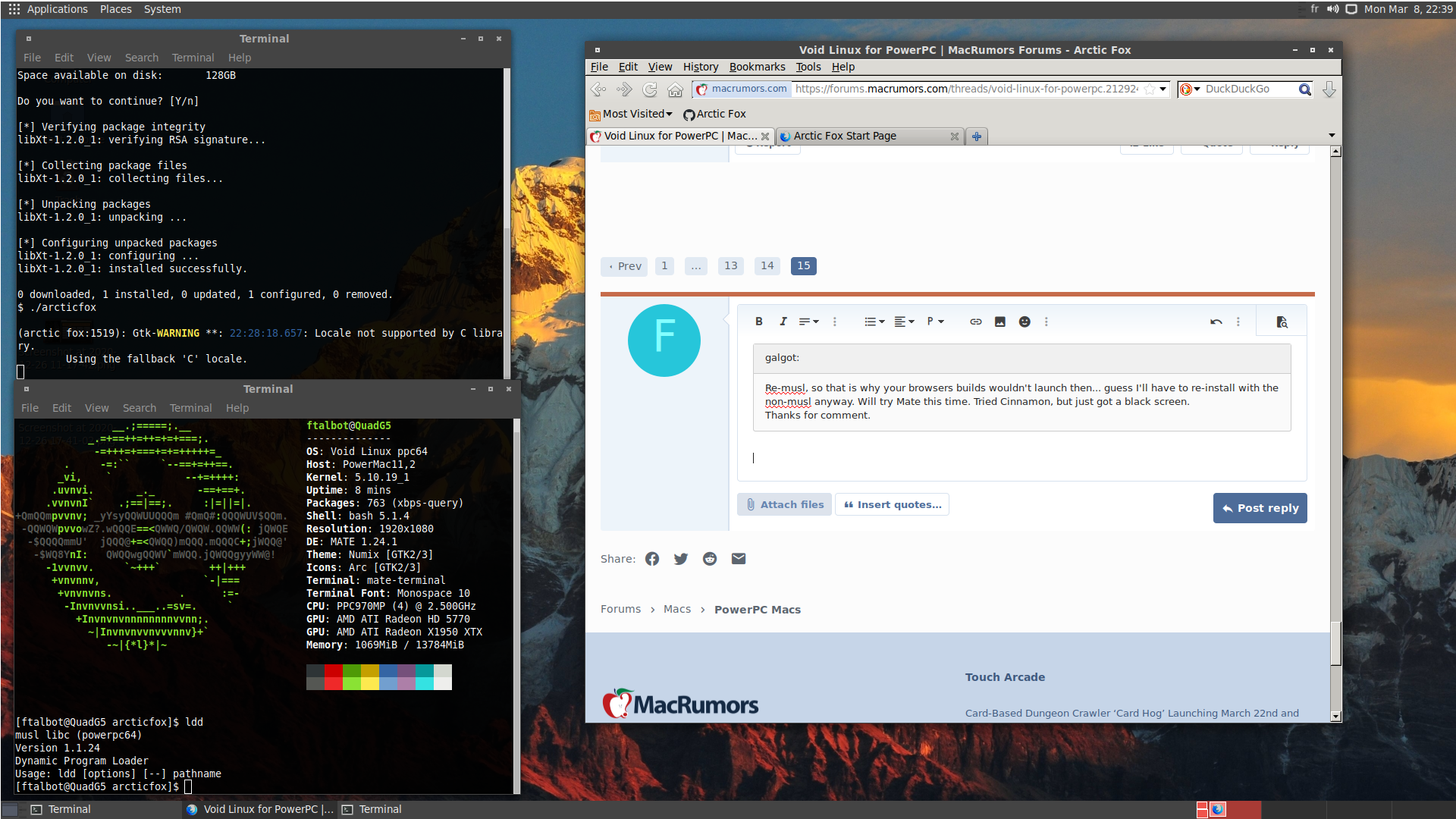

Re-musl, so that is why your browsers builds wouldn't launch then... guess I'll have to re-install with the non-musl anyway. Will try Mate this time. Tried Cinnamon, but just got a black screen.
Thanks for comment.

Yep, currently i only have builds for 32/64bit glibc versions available. Here's my minimal Mate desktop. I didn't install all the extra bells and whistles available for Mate though. Trying to keep it somewhat lightweight.
Cheers

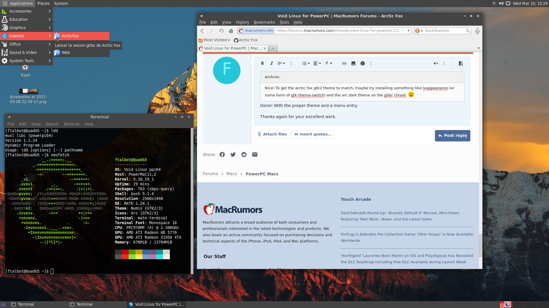

Hi. I was too lazy to reinstall a non-musl Void (and a bit affraid I would mess something), so I went the chroot way. It still needs some ironing, but I'm writing this in Arctic Fox (thanks wicknix!) on musl Void.
I used this guide.

Nice! To get the arctic fox gtk2 theme to match, maybe try installing something like lxappearance (or some form of gtk-theme-switch) and the arc dark theme on the glibc chroot. 🙂

Done! With the proper theme and a menu entry.
Thanks again for your excellent work.
