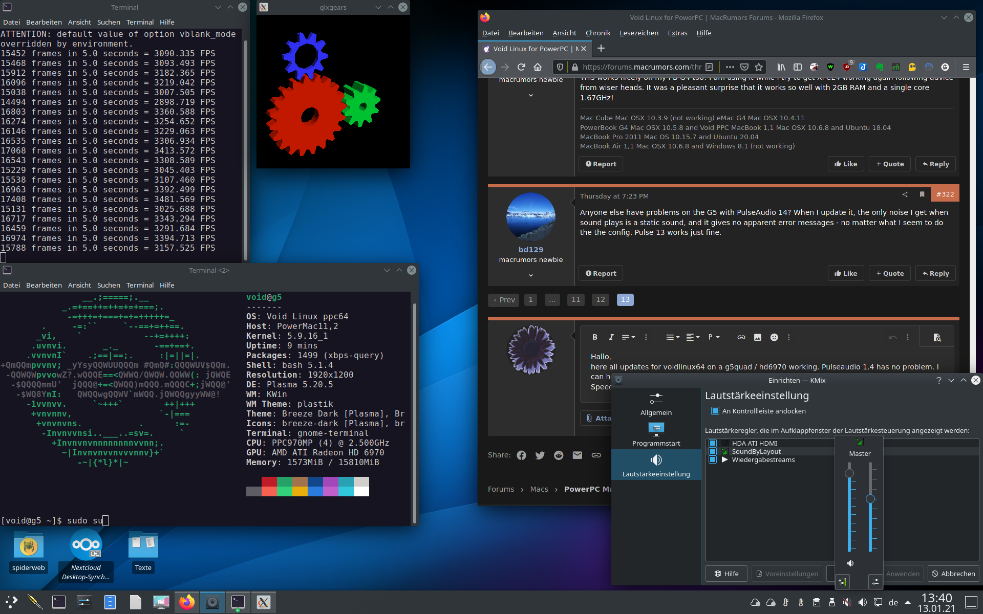

Hallo,
here all updates for voidlinux64 on a g5quad / hd6970 working. Pulseaudio 1.4 has no problem. I can hear onboard-sound.
Speed with Firefox 84.02 is ok, but colours (pictures and videos) still are not correct.View attachment 1711945

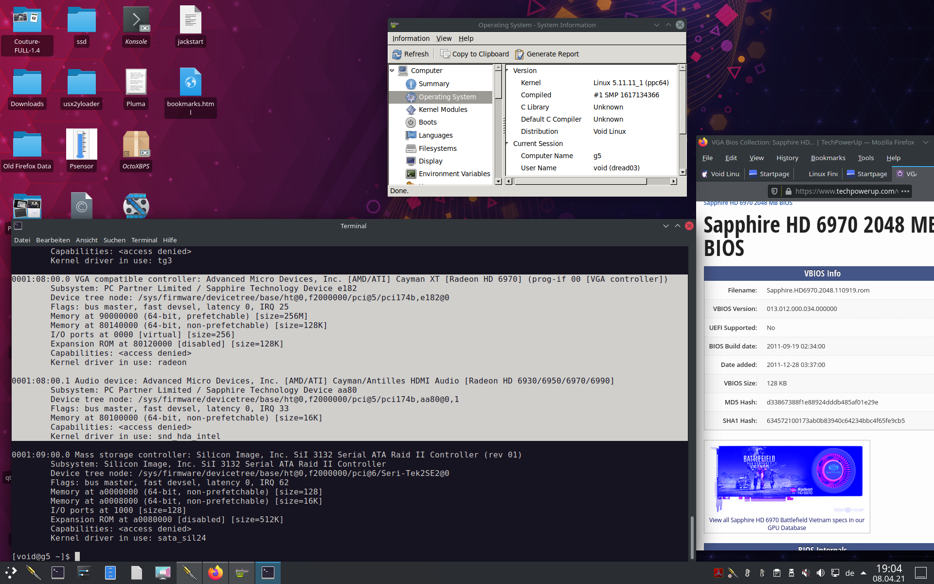

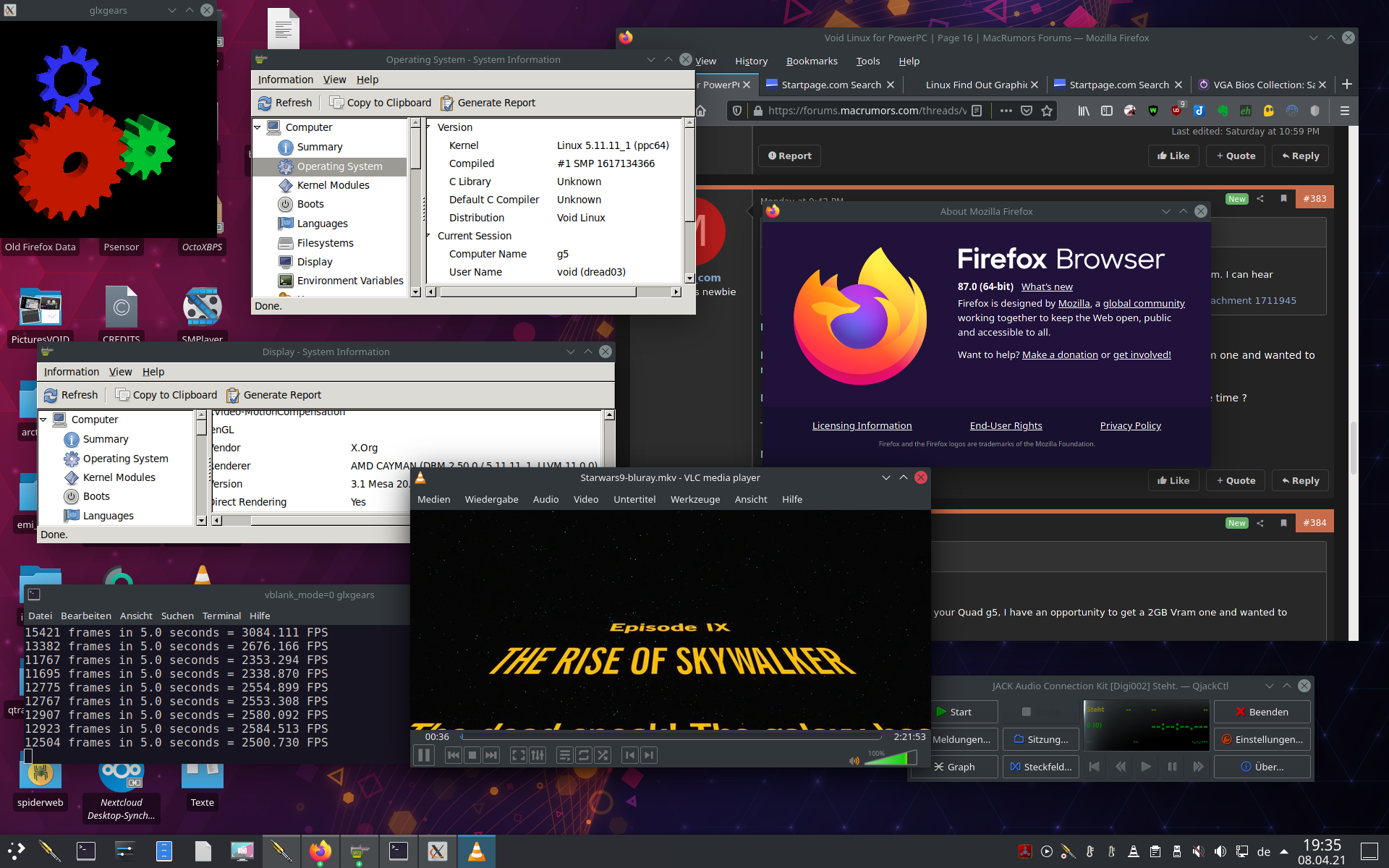

Hi,
i am using only a Sapphire 6970 2048MB in the quad, but for the installing the original 6600 was in the lowest pcie slot. After finishing the installation, i removed the original card, but leave the amd-card in the second pcie slot. I think, you can use nearly all 6970 cards with void.
At the moment i aḿ trying to boot from the sata2 card (seritek 2se2-e; bootable in a G5), but i am not able to get it working.

Hi,

Ok, i found all information about installation void64 on a G5 here in this threat. Also i read all the linuxthreats here on powerpc / macrumours. That helps.
And so: use the last void installer dvd; nvidia6600 in lowest slot and amd above. AmdCard needs a lot of power (6pin and 8pin). Take it from cdrom device; powercabel via adapter.
And if voidppc is installed, install amd firmware.
And with a nvidia6600 card, i had a bootscreen all the time.
