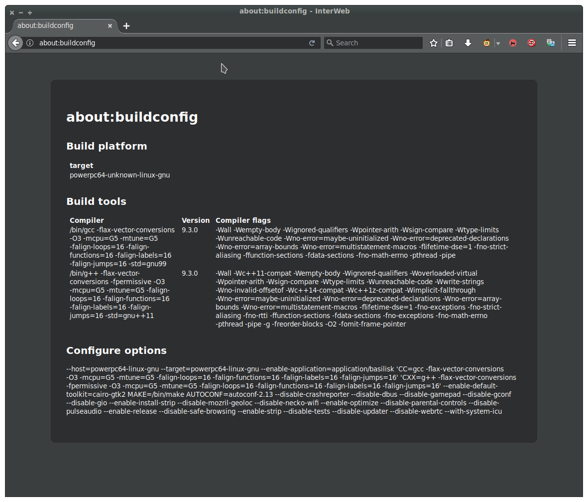

Hi, I'm again having a little more time to play with my iMac G5 with void 64 bits. And I tested the SpiderWeb and worked just fine, ArcticFox worked as well, but I tried the InterWeb that you made available in your github (https://github.com/wicknix/SpiderWeb/wiki/Download) but when tried to open have an error
Code:
error while loading shared libraries: libatomic.so.1: wrong ELF class: ELFCLASS32
This kind of error should only happen when trying to open an 32 bit application on a 64 bit only environment, right? I double check and downloaded the right file (interweb-20201108-voidlinux-powerpc64-glibc.tar.bz2), how can I fix it? And I realized that your awesome SpiderMail isn't available for 64 bits. What are your instructions for compiling, or there's some requirements for do it right?
The SpiderWeb have some peculiar add-ons that work, but I don't understand what are the requirements, because I use the Open With (https://github.com/darktrojan/openwith) in the PaleMoon and other Browsers on Windows, Linux x86_x64 and OSX Leopard to send YouTube and other videos to open on mpv or downloading with youtube-dl (on PPC Linux mpv won't work resolving the links but I'm trying some workarounds and OSX I still don't have any idea). I tried many versions but none worked on SpiderWeb, so there's any secret that you can share to help solving this?
Thanks

Thanks for the reply.
That's strange some people have problems with Void updates. I installed the XFCE image and updated on 1 of my machines and the other 2 I installed the base system and configured like I like, and so far not a single issue. (except the PulseAudio that came installed in the XFCE ISO that I can't uninstall, but I specified the ALSA output on the applications that matter) What kind of problems you have?
I know that void64 have Thunderbird but it's getting heavier by the day (In my Windows T430 I still have the v68 and the UI I really have a problem with the design language) and for managing my emails I don't need the latest but a reliable email client as the SpiderMail has proven in my PowerBook.
About the error I think that's curious how only 1 of 3 of your browsers could have this kind of error, but I will wait for your tests / findings.
I'll try my best to follow your instructions and compile, but I have some questions:
1)In the moment my iMac only have 2,5GB of Ram, (The 4GB stick it's on the way to upgrade and some other parts. Thanks @Project Alice for the findings) so this could be an limitation for compiling?
2)It have the most recent versions of all your projects, so all of them could be compiled in 64 bits?

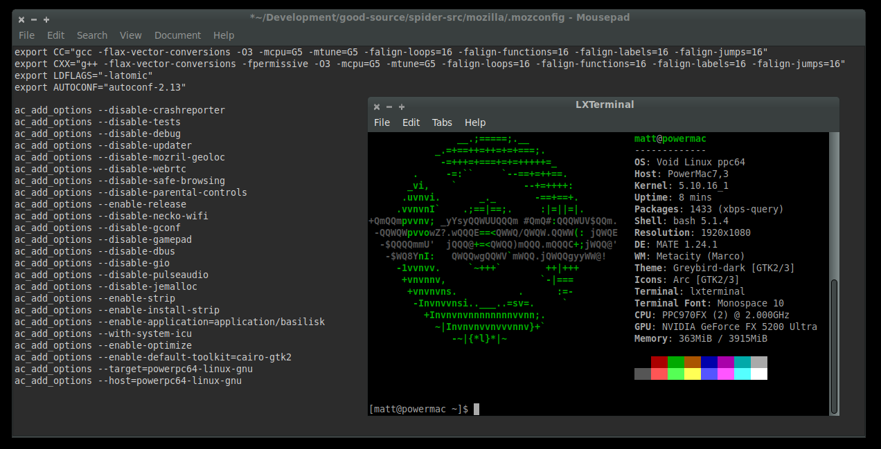

@wicknix
Hi, after spending almost 2 days learning the tricks to compile your applications and failing to compile SpiderWeb and InterWeb I decided to document the progress in case of anyone decide to do the same, and if you could point or help to solve I'll be grateful. So let's start!
After downloading your 2 files (wicknix-ppc-browser-src.tar.bz2 & UXP4PPC32-2.2.tar.gz) I opened the terminal and installed many packages (I didn't knew this whole list from start, but after many missing dependencies I think that's requirements to compile)
Code:
sudo xbps-install -S rsync gtk+-devel python-devel autoconf213 yasm gcc glibc-devel ccache autoconf automake clang clang-analyzer clang-tools-extra libgcc-devel  make zip libconfig++-devel bzip2 perl tar  xz fakeroot gnupg  dpkg-devel binutils-devel doxygen  librpm-devel libatomic-devel GConf-devel libvpx-devel alsa-lib-devel libXt-devel python-dbus-devel wget cairo-devel cairomm-devel python-cairo-devel python3-cairo-devel libvpx5-devel libvpx-tools libpulseaudio pulseaudio-devel
Next let's extract both files
Code:
tar -xvf wicknix-ppc-browser-src.tar.bz2
tar -xvf UXP4PPC32-2.2.tar.gz
Since your instructions specified to copy from UXP4PPC32-2.2 I used rsync since it's much faster than using GUI file manager and mv couldn't merge folders if necessary.
Code:
cd good-source/spider-src/
rsync -av /home/dextructor/UXP/UXP4PPC32-2.2/ /home/dextructor/UXP/good-source/spider-src/
Next editing the .mozconfig file replacing with the ones that you provided in the folder "/good-source/spider-src/"
Code:
nano /home/dextructor/UXP/good-source/spider-src/.mozconfig
But some random c compiler errors appears and need to replace the following lines in the InterWeb mozconfig
Code:
export CC="gcc"
export CXX="g++"
ac_add_options --target=powerpc64-unknown-linux-gnu
ac_add_options --host=powerpc64-unknown-linux-gnu
Then what's left it's to finally build
Code:
./mach build
But since I failed with both SpiderMail and InterWeb, I try to understand the errors as much as I could. Begining with the SpiderMail

It appears that don't have the target build to beginning compilation and I don't know how to solve it.

For what I searched it appears that lacks multilib to proper compile 32bits instructions and since the Void builds don't have this different packages in the PowerPC it's a dead end I guess.
Can you help with your knowledge to advance in this matter?
Thanks
Reactions: fra9000
Yeah, 2.5gb ram with at least 1gb swap will be enough to build it. However i can't seem to replicate your build error. To me it looks like your system is missing some dev headers yet. Here is my .mozconfig for interweb and a screenshot of interweb working on void-ppc64 (built with gcc-9.3).
I'll start a build of spidermail tonight. Hopefully it completes successfully as i haven't touched that code is ages. Will let you know if it completes. If so, i'll upload it.
Cheers
Reactions: dextructor
Ok, I already edited the .mozconfig file and about the headers I already had the "kernel-libc-headers" and just installed "linux-headers" and "python3-cppy" but I don't know if I'm missing something. In the meantime I'll just compile. Thanks for the help so far. =)
It's possible that some update broke it, or possibly i packaged the wrong version.
Did you check if you package the right version?
Yes, I also verified that it is the correct upload. My spidermail build failed with a font error. I'll look in to that soon. No issue building AF/SW or IW though on void64.
Cheers
Well after more testing I still get the same errors even with your .mozconfig settings. The bright side of all of this experimenting it's the InterWeb it's now working, I suspect that might be some dependency that I installed to compile all of this (I will test it thoroughly when I have more time available in the next weeks) but I still wanna to be able to have this more documented for "the future generations" when someone has the will/needs to experiment/learn to do it.
Thanks

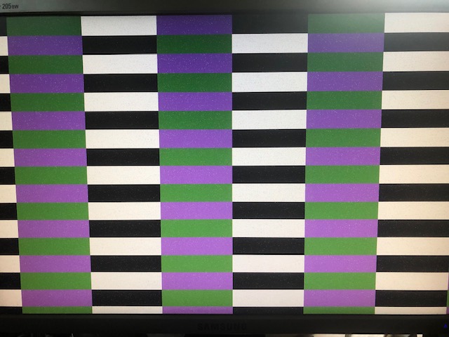

Im going crazy
Is it possible to install Void64 (with GUI) on a PowerMac G5 with a 6800 Ultra?
The GUI of the Live CD ist hanging with this:
I couldn't find exactly the answer but musl and nouveau aren't good friends and @wicknix Lubuntu thread have instructions for your card using yaboot and older kernel (lower than 5.x):
Code:
'live video=TV-1:d video=TV-2:d video=offb:off nosplash'
Other alternative it's to download the ROOTFS iso, then boot in the CLI and install a minimal system to troubleshoot your problem. The Official PPC FAQ mention that this cards should work. And this was posted by Adélie Linux developer that worth the shot.
Please try this solution for yaboot and kernel 4.X and also if this "works" on GRUB with the 4.X and 5.X kernel to help other with the same problem.
