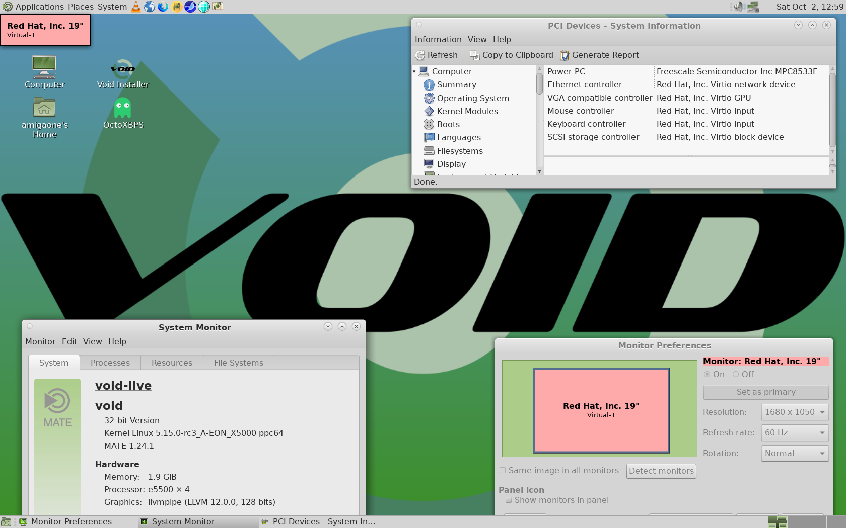

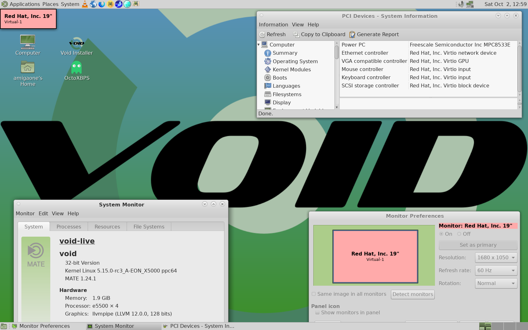

Hi All,
I successfully tested the RC3 of kernel 5.15 with Void PPC in a virtual e5500 QEMU machine today.
Void starts very fast because of the runit init system in this virtual machine.
QEMU command:
Code:
qemu-system-ppc64 -M ppce500 -cpu e5500 -m 2048 -kernel uImage-5.15 -drive format=raw,file=void-live-powerpc-20210822.img,index=0,if=virtio -netdev user,id=mynet0 -device virtio-net,netdev=mynet0 -append "rw root=/dev/vda2" -device virtio-vga -device virtio-mouse-pci -device virtio-keyboard-pci -smp 4
Screenshot:
Cheers,
Christian

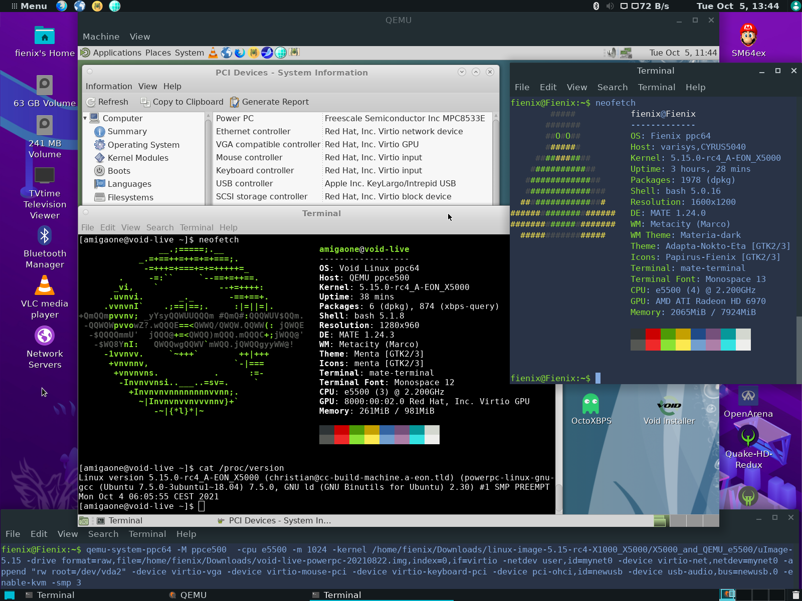

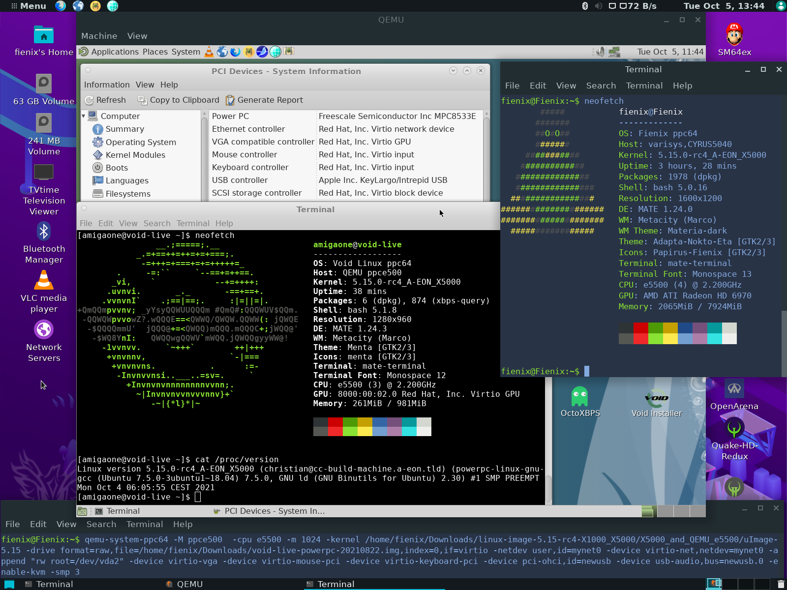

Hi All,
I successfully tested the RC4 of kernel 5.15 with Void PPC in a virtual e5500 QEMU machine today.
This time with KVM-HV! ;-)
QEMU command:
Code:
qemu-system-ppc64 -M ppce500 -cpu e5500 -m 2048 -kernel uImage-5.15 -drive format=raw,file=void-live-powerpc-20210822.img,index=0,if=virtio -netdev user,id=mynet0 -device virtio-net,netdev=mynet0 -append "rw root=/dev/vda2" -device virtio-vga -device virtio-mouse-pci -device virtio-keyboard-pci -smp 4 -enable-kvm
Screenshot:
Cheers,
Christian

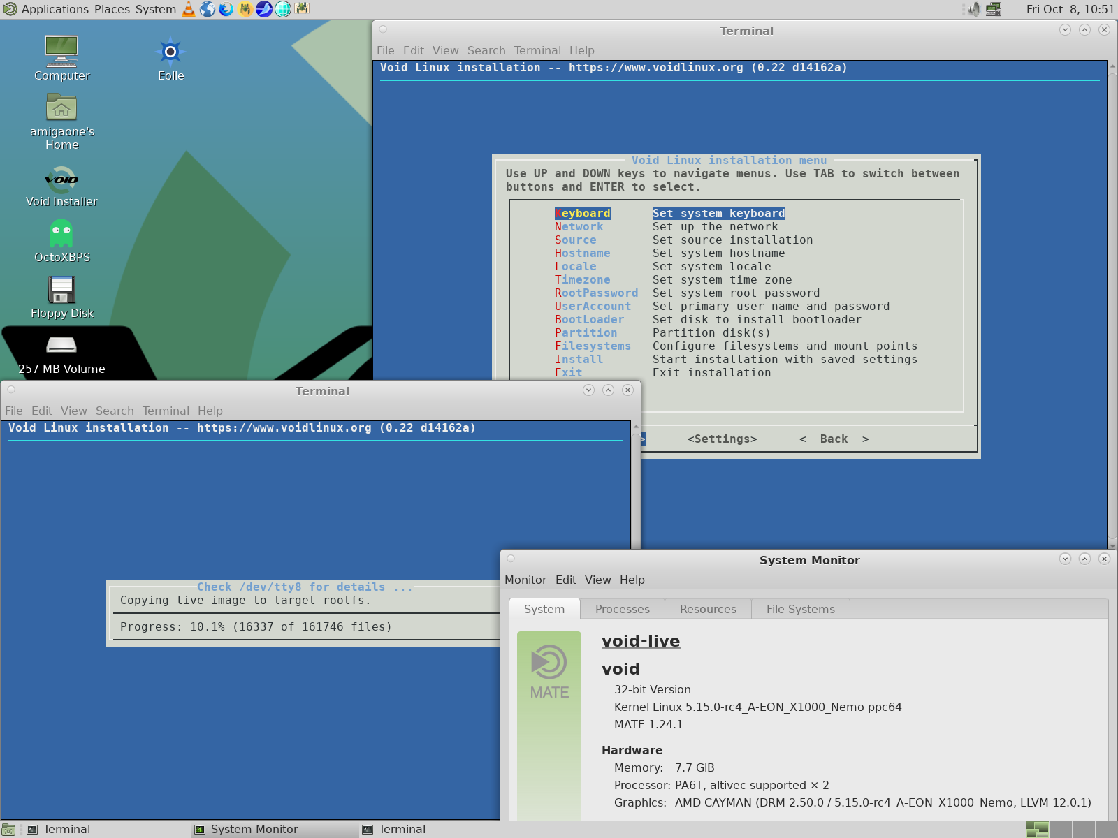

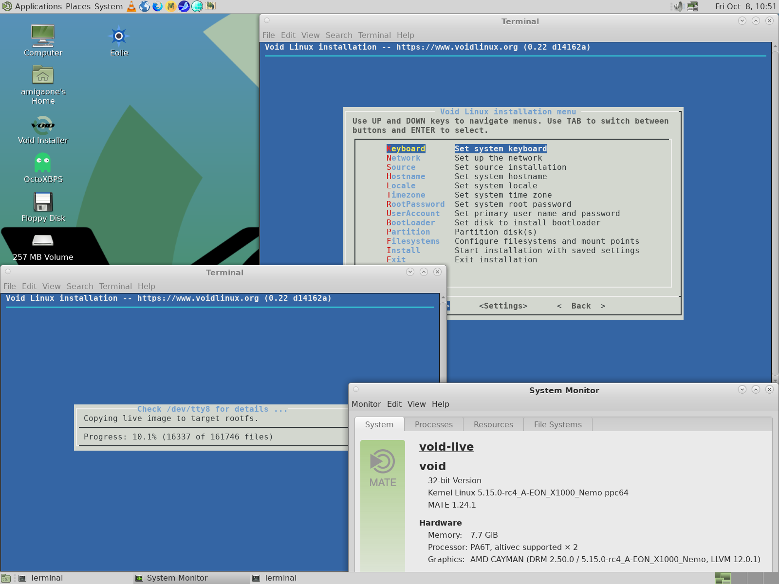

I released a new Void PPC img with a boot and root partition including the void-installer for the A-EON AmigaOne X1000 and X5000 today.
Download and instructions for installing and booting Void PPC on the AmigaOnes: https://forum.hyperion-entertainment.com/viewtopic.php?p=54209#p54209
Screenshot:
Many thanks to the Void PPC developers for this great distribution. It works really well on our AmigaOnes.
Cheers,
Christian

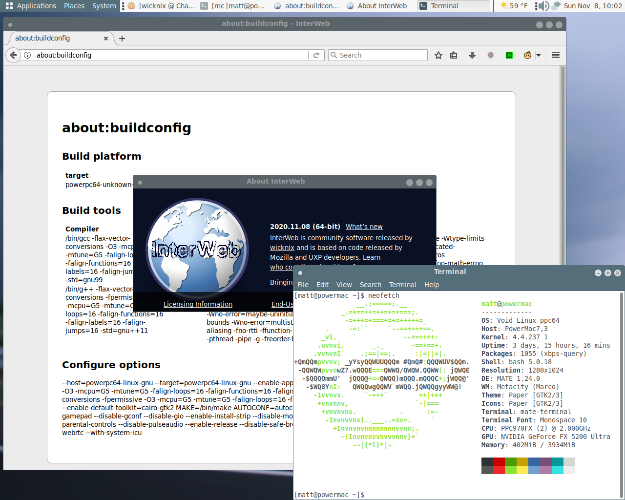

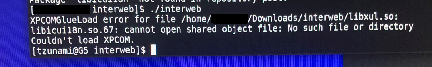

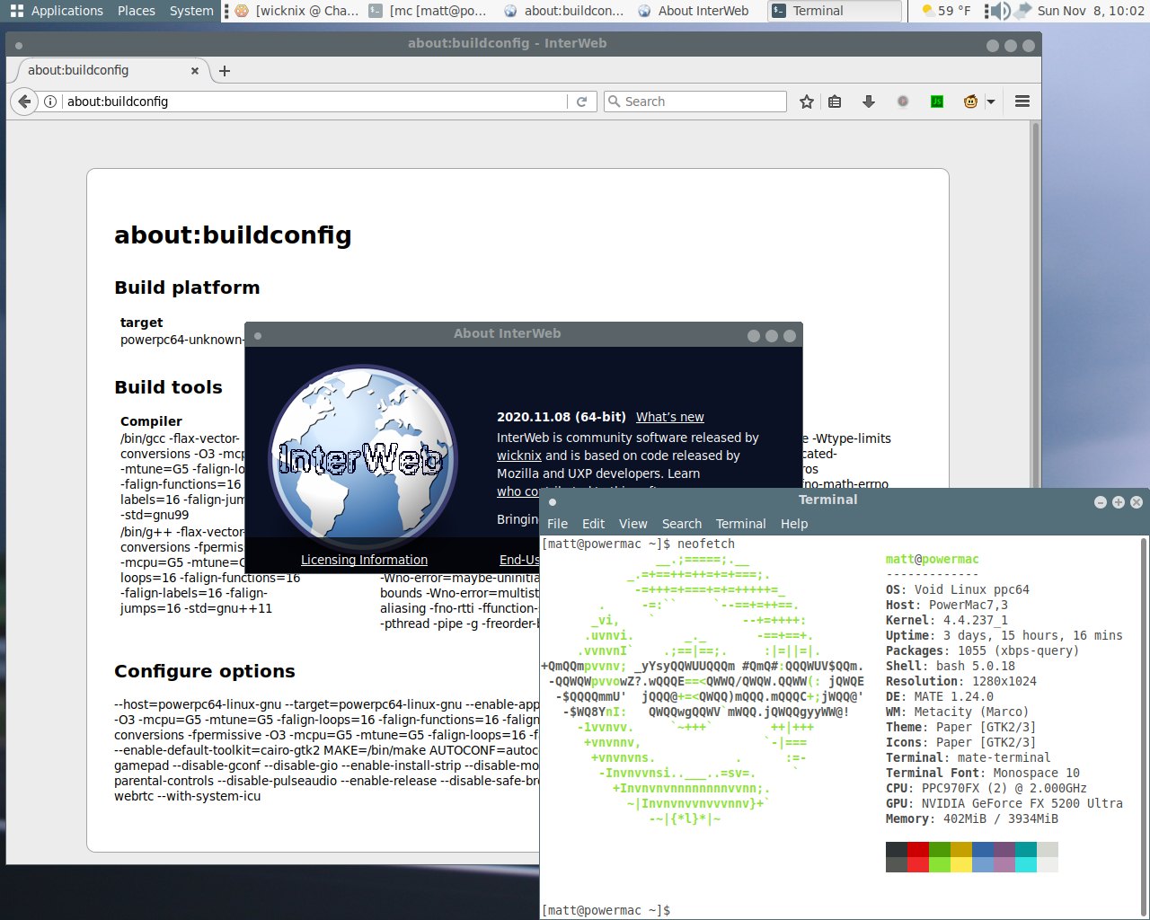

InterWeb is now available for Void-PPC 64-bit (G5/BE glibc) from here and/or here.
No installer. Just extract anywhere and run the binary, or manually install it and create a .desktop file for it.

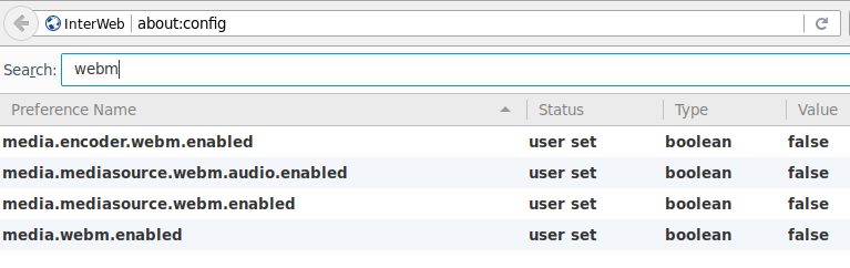

Edit: YouTube will lock the browser up until you make these changes in about:config. The video colors are reversed still, but this will prevent a lockup.
I recommend using gtk-straw-viewer if you want to watch youtube videos. (xbps-install gtk-straw-viewer)
Also, to make github work again you'll need to install this extension: https://github.com/JustOff/github-wc-polyfill/releases

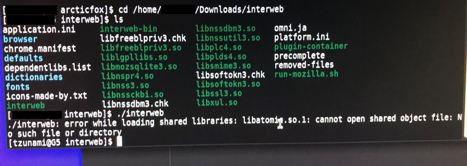

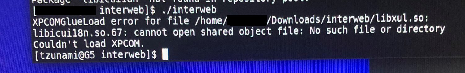

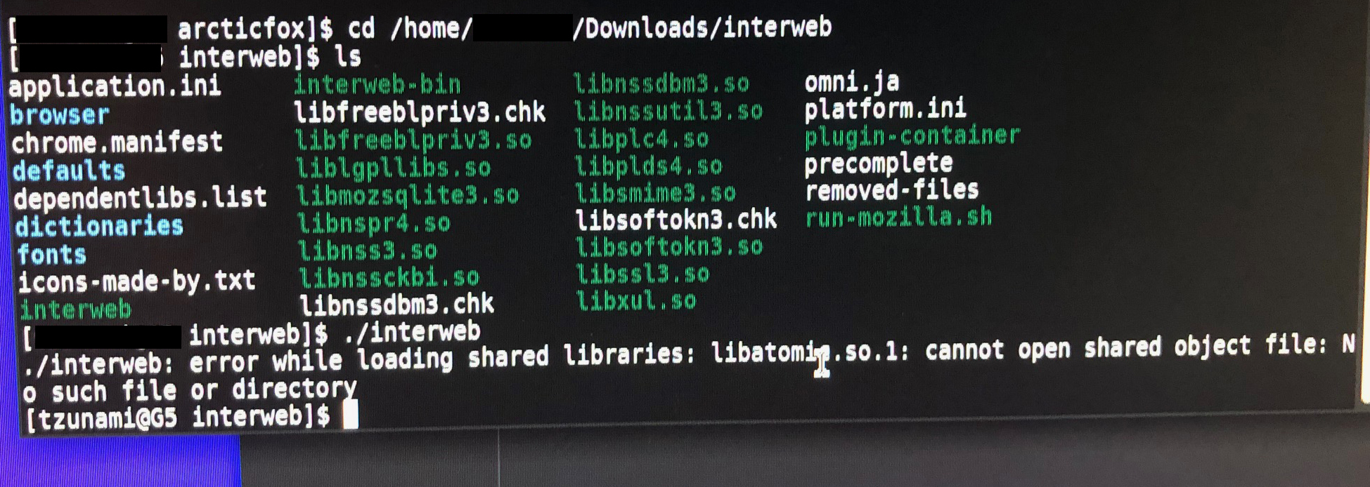

I don't get interweb G5/BE glibc to work noting afer double klick interweb or interweb-bin
i know, i click it wrong 😉
Arctic fox is running well.
Ahh ok. I'm rusty on xbps commands, but search for libatomic and install it. Should work after that.
