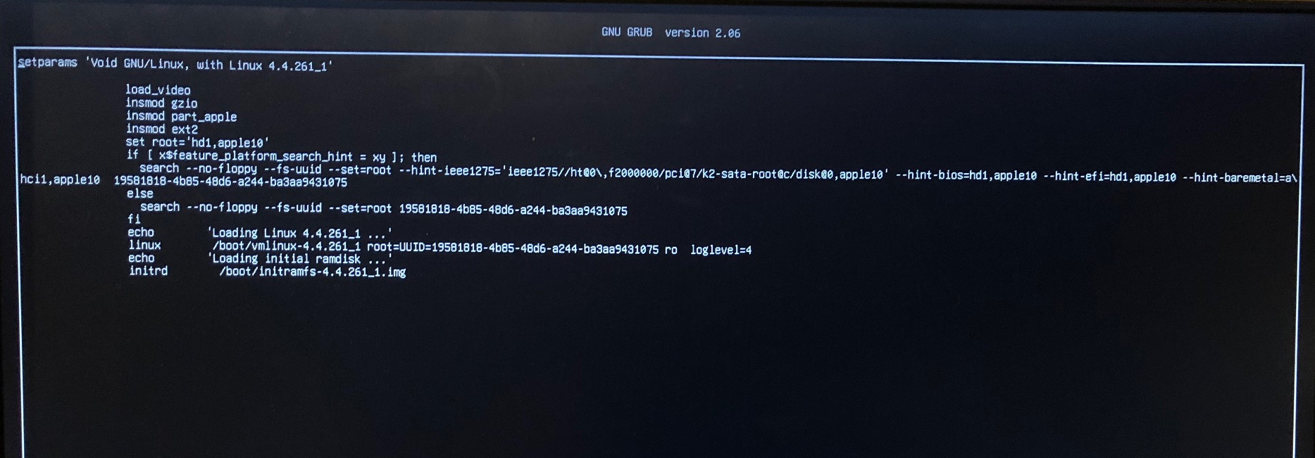

So I have been trying, desperately, to get Void PPC onto either of my Powerbooks, to no avail. I've read through most of the thread, but a lot of it has been successful installs and helpful hints.
I have a Powerbook3,2, 500MHz Titanium; maxed RAM (1GB) and mSATA to IDE 60GB SSD. And a Powerbook5,6, 1.67GHz; also max RAM (2GB) and mSATA to IDE 60GB SSD.
The TiBook will sort of boot using either the 4.4 or 5.13 kernel. It will get to the point where you can login, but then the screen starts flashing and you can't do anything. I try to login, in case the screen or framebuffer are having conniptions, but if I press the power button it goes through the shutdown sequence. There, I can see some kind of error when previously typing at the login prompt, but it actually shuts down before I have a chance to read what it says.

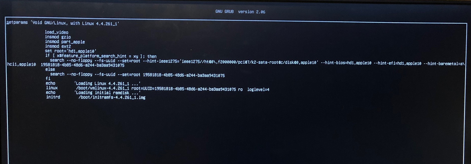

I have used several variations of adding to the long string in GRUB: video=aty128fb:vmode:x I have tried 6, 8, 9, 10, 11 from this page also to no avail. Different resolutions and framerates don't seem to matter.
I did get into the installer once but I have no idea how, and I dun did f'ed up something with the install, so I've put that whole thing to the side for now.
For my PB5,6, no matter how I switch the slashes, no matter which of the 2 USB ports I use, no matter how I write the Void PPC ISO (either XFCE or plain CLI), this thing just starts loading for about 2 seconds, then the 'no smoking' or 'prohibitory' sign pops up. There is some code popping up just before that, but it's too fast for me to read.
That's it.
I know Linux will kinda work on it, as I installed an old Ubuntu PPC on it a long long time ago. But it's running OSX right now, and refuses to boot from the USB drive.
I have used both void-live-ppc-20210825-xfce.iso and void-live-ppc-20210825.iso on a 16GB Sandisk USB3 drive that I've literally had no issues with booting modern x86 Macs from. Not sure if that's the issue, but I don't have too many smaller capacity, or USB2-only drives lying around.
I've tried good ol dd (with the recommended wipefs -a /dev/sdX prior), Rufus on Windows, BalenaEtcher on both Windows and Linux. I haven't tried from OSX as yet, from the one Powerbook still running it, but I could definitely try.
I believe both will boot from DVD, but I haven't really tested that (yet) as I don't know if I have any RW discs. Plus both have had issues in the past loading and ejecting discs, so I am not sure I want to go that route.
Any ideas? I'm not at my wits' end, just....kind of confused after seeing others in the thread having great success, sometimes on similar enough models to mine.
