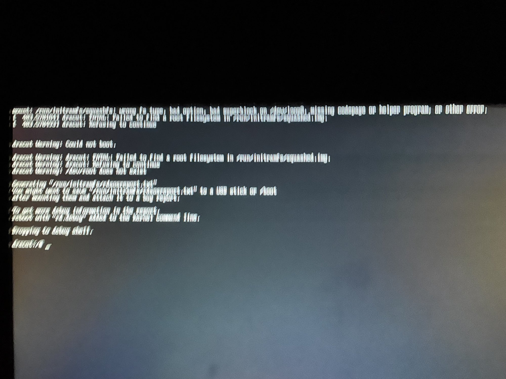

View attachment 1922809@wicknix , as it turns out, I did just that. Being paranoid, I added “nomodeset” to the boot Kernel and upon startup received a message that a root file system couldn’t be found and, some message about dracut and the final message being “will not continue” and a flashing cursor. I went to shut down the computer by pushing the power off button and more verbiage popped up and it took me to a dracut# shell. It was late so I shut down the computer and will try again later. The next attempt I will boot the 4.4-126 kernel without modifying the boot kernel to see if that makes a difference.
A terrible picture of what the screen showed is above:
Thanks,
MacMav
How did you burn the DVD? I read wrong fs (file System)
On Mac: Simple right klick to image in the Finder and select "burn to media".

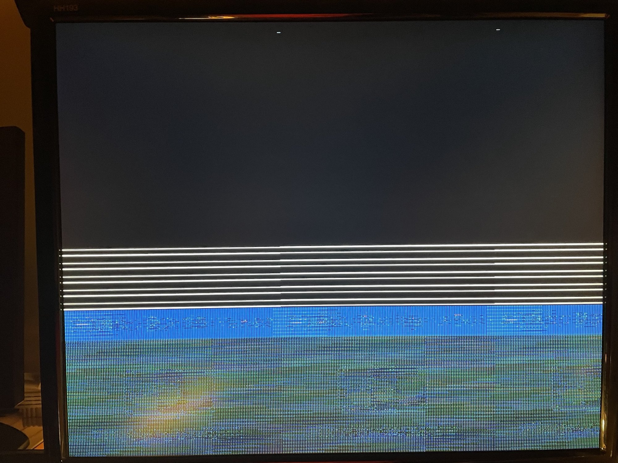

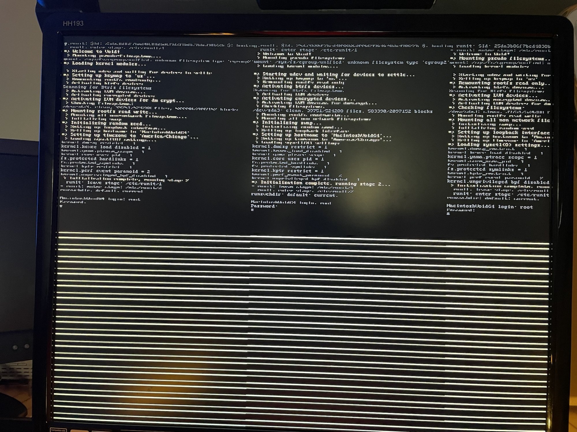

@wicknix, @TzunamiOSX, I burned https://repo.voidlinux-ppc.org/live/current/void-live-ppc-20210825-xfce.iso to a DVD and booted to kernel 4.4-261 with no kernel modification on my part and this was the result:
Then I booted to kernel 5.13-12, again no kernel mod, and this was the result:
I am going to try to boot from 4.4-261 and mess with some stuff but I thought you might like to see what I’m dealing with.
MacMav
Definitely a video driver / resolution issue. Can you force it to use the generic slow fbdev driver by chance?

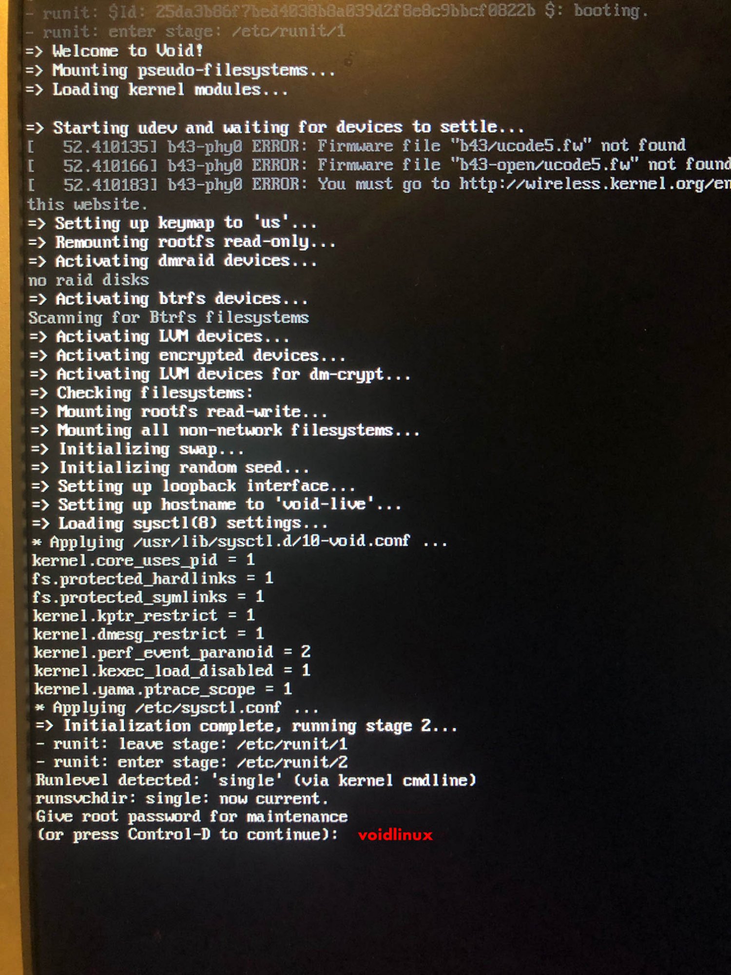

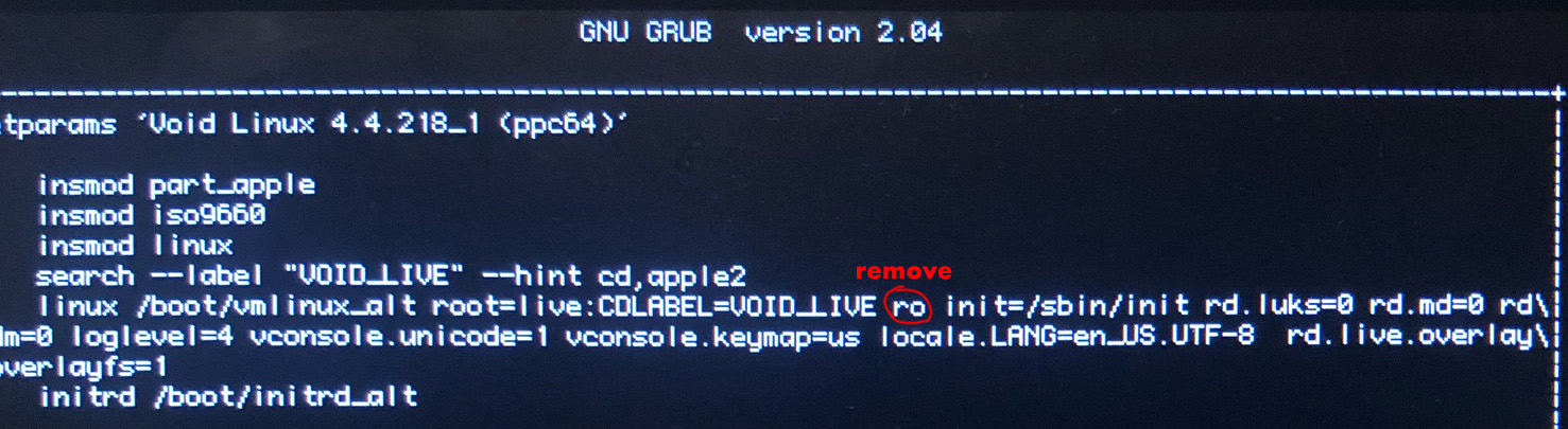

Boot CD
select Void Linux 4.4.x and press the "e"
go to line linux, after the "ro" add "fbdev"
press ctlr+x

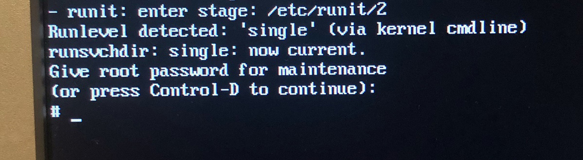

If this does not work (like on my GF 6800) you must install in single mode
Boot CD
go to line linux, remove the "ro" and add "single"
press ctlr+x
password is: voidlinux
void-installer
then #493

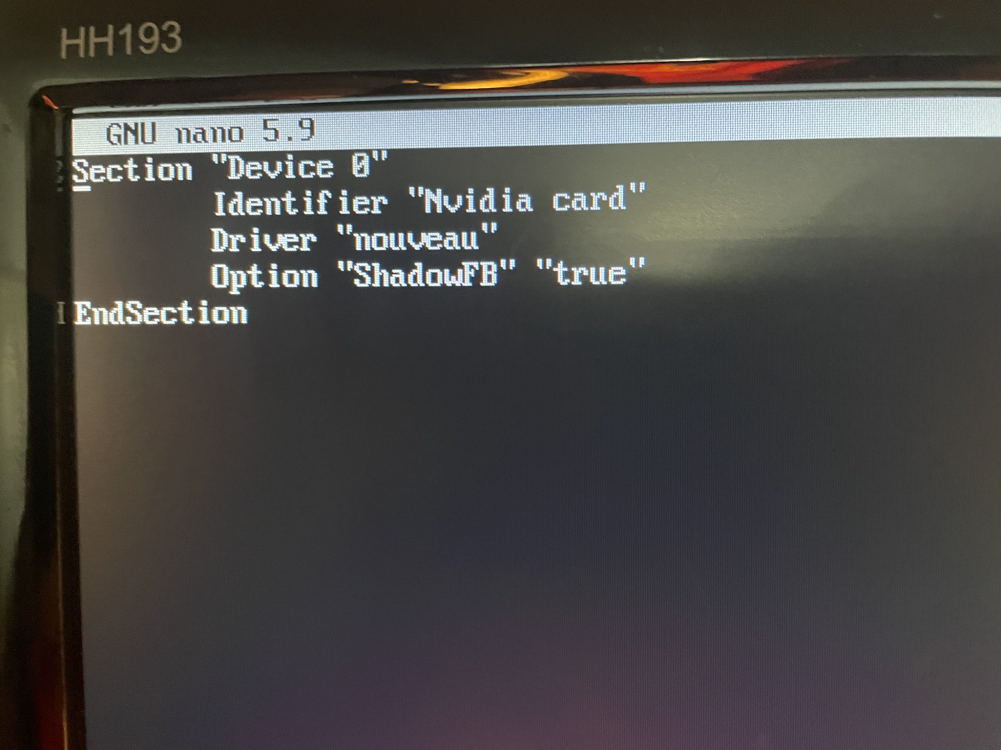

ah ok, install has finished

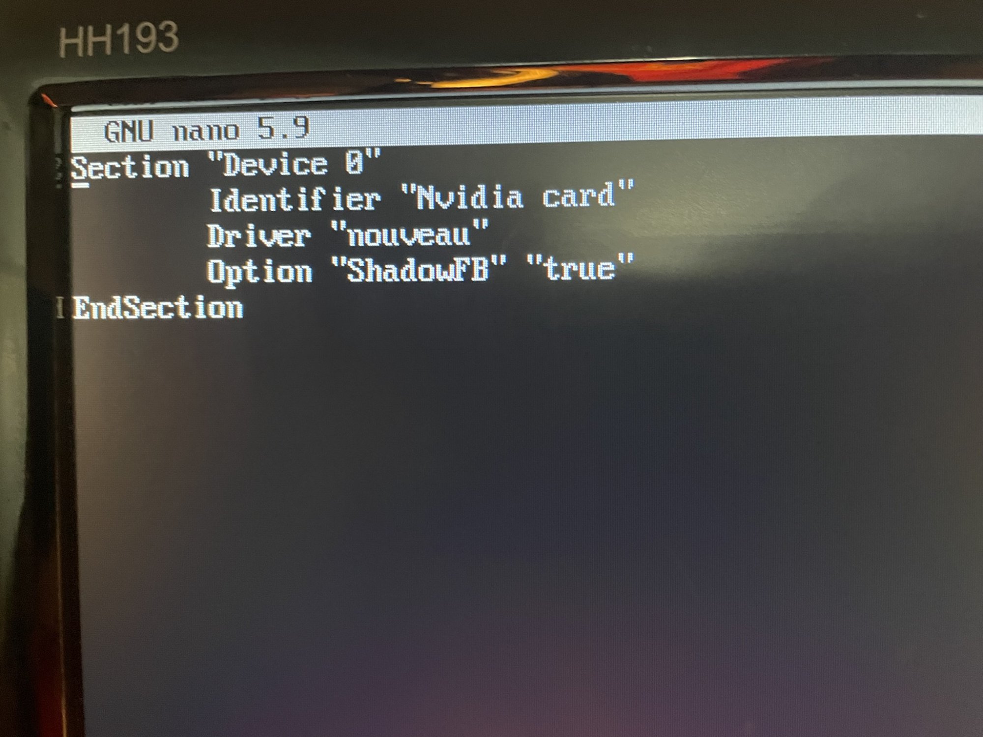

picture of the 20-nouveau.conf file in editor please
When I nano’d the /etc/X11/Xorg.conf.d/20-nouveau.conf file, the was nothing in it. So I entered the information provided into the file, saved it and rebooted. No change. No graphical desktop. I will look at it again. My Nvidia card has an Apple Cinema Display and a DVI port. Also, how do I edit a directory? At one point there were two 20-nouveau.conf files in it and I wanted to get rid of them and start over.
with this command you create the folder xorg.conf.d
Code:
mkdir -p /etc/X11/xorg.conf.d
With this you create an empty file inside this of xorg.conf.d
Code:
nano /etc/X11/xorg.conf.d/20-nouveau.conf
add this to that file
Code:
Section "Device"
    Identifier "Nvidia"
    Driver "nouveau"
    Option "ShadowFB" "true"
EndSection

This is NOT what I modified /etc/X11/Xorg.conf.d/20-nouveau.conf to say. Your instructions stated the Identifier should be NVIDIA. Would this make a difference. I saw the above info on a VoidLinux Reddit thread.
Section "Device"
Identifier "Nvidia card"
Driver "nouveau"
EndSection
Not sure that "Nvidia card" is working. A simple "Nvidia" is working on my G5 and iMac.
Also imortant is the
Code:
this activate the framebuffer for old Nvidia cards
@TzunamiOSX, I modified the /etc/X11/xorg.conf.d/20-nouveau.conf file including the ShadowFB and true entries. I saved the file. Screen was as shown below:

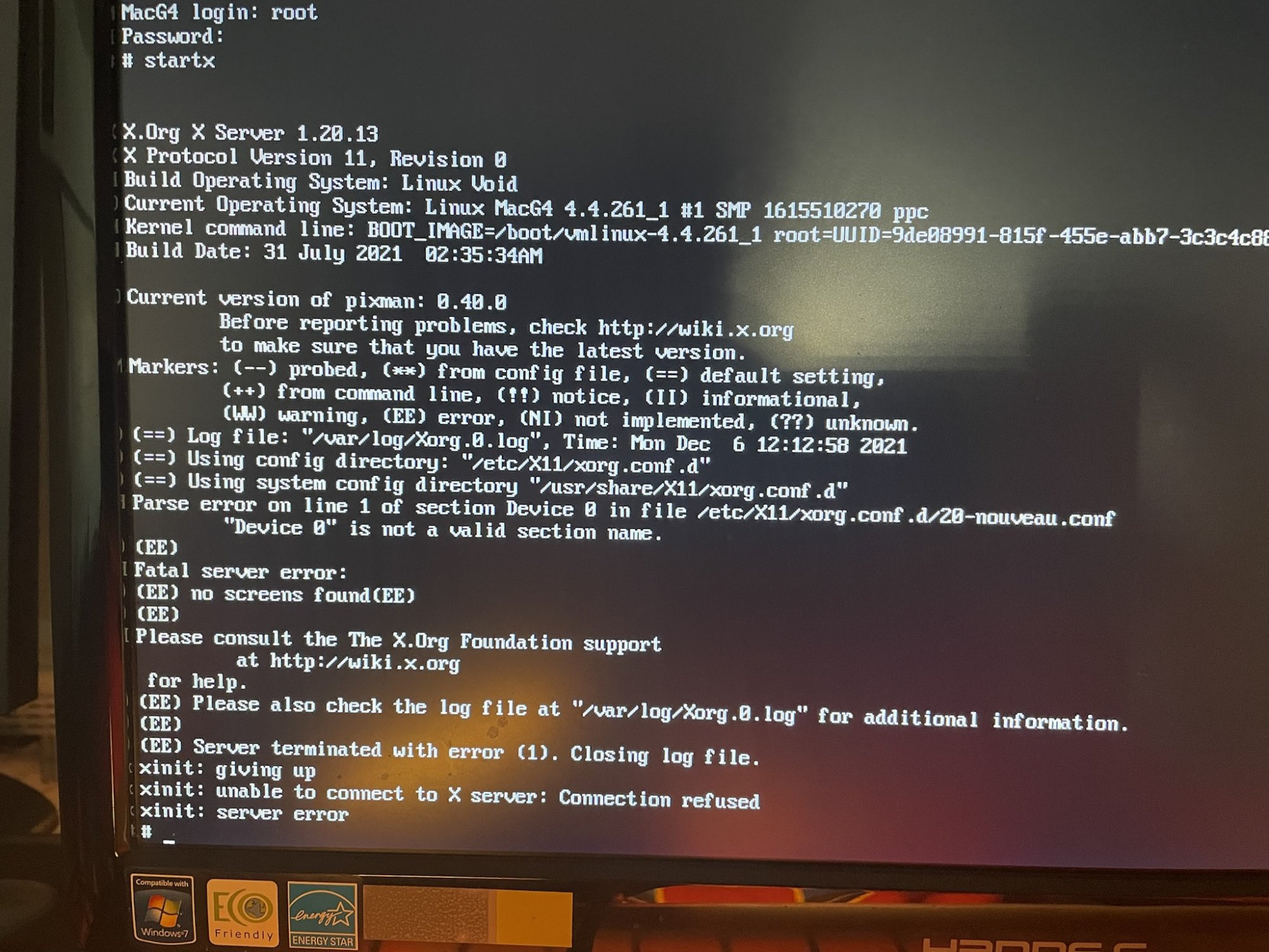

Here are the contents of /etc/X11/xorg.conf.d/20-nouveau.conf

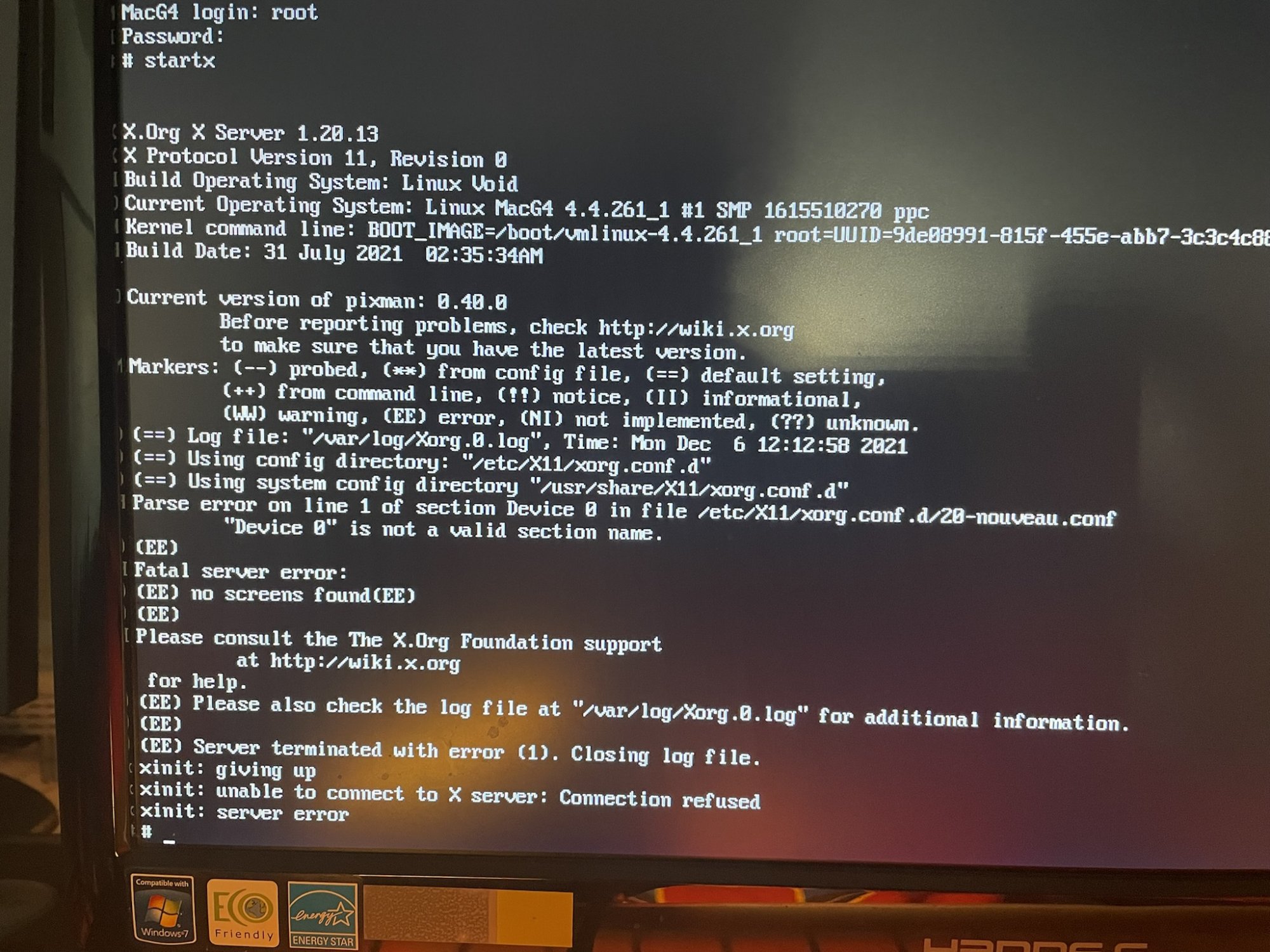

I entered “nomodest” into the boot kernel so I could read the error messages. This is the result of the reboot:
Two key things to note:
Device 0 is not a valid section name.
The “Using system config directory “user/share/X11/xorg.conf.d” is interesting.
I went to the /user/share directory and found several entries, and.conf, radeon.conf. and a few others but nowhere in this directory was a nouveau.conf or Nvidia.conf. Should there be?
I will now go back and remove Device 0 and just use Device to see what transpires.
Any thoughts @wicknix ?

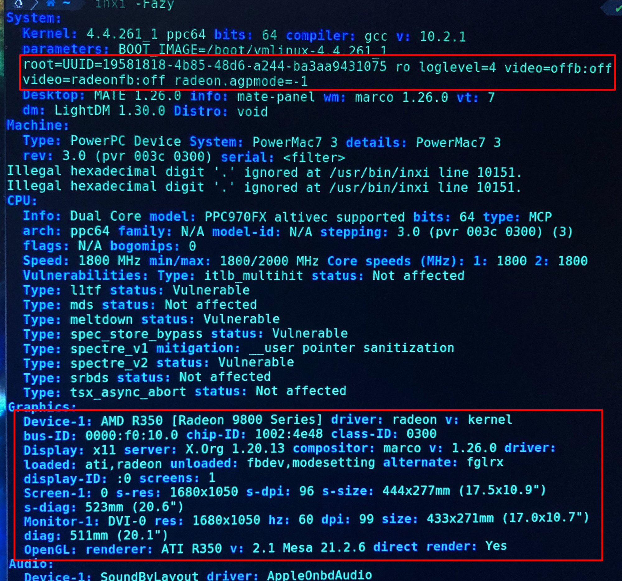

Radeon 9800 Pro GUI interface reactions slower as with my GeForce 6800 with LLVMpipe sotware renderer?
For testing i have installed a Radeon 9800 Pro inside my G5. Videos are running much faster in fullscreen, but the GUI has some slow reactions/lags when moving/opening a windows or opening the menu. i this situations the mouse is hannging shortly
Perhaps i have a wrong setting or something is missing, so i add a picture of my settings.
Try turning off the compositor (marco) in Mate's settings. Then log out, and then log back in.
Cheers
Under Mate-Tweak/Windows/Window Manager i have 2 marco options
marco
marco-no-composite
I also have installed mutter and metacity but they are not selectable in the menu, don't know why.
