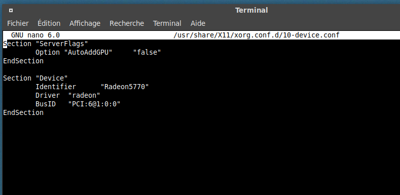

Then, use your favorite text editor to create a new conf file for Xorg with the fowling command :
Code:
sudo nano /usr/share/X11/xorg.conf.d/10-device.conf
Fill the new blank file with the following informations. Make sure that you write the proper PCI address.
Save and reboot.

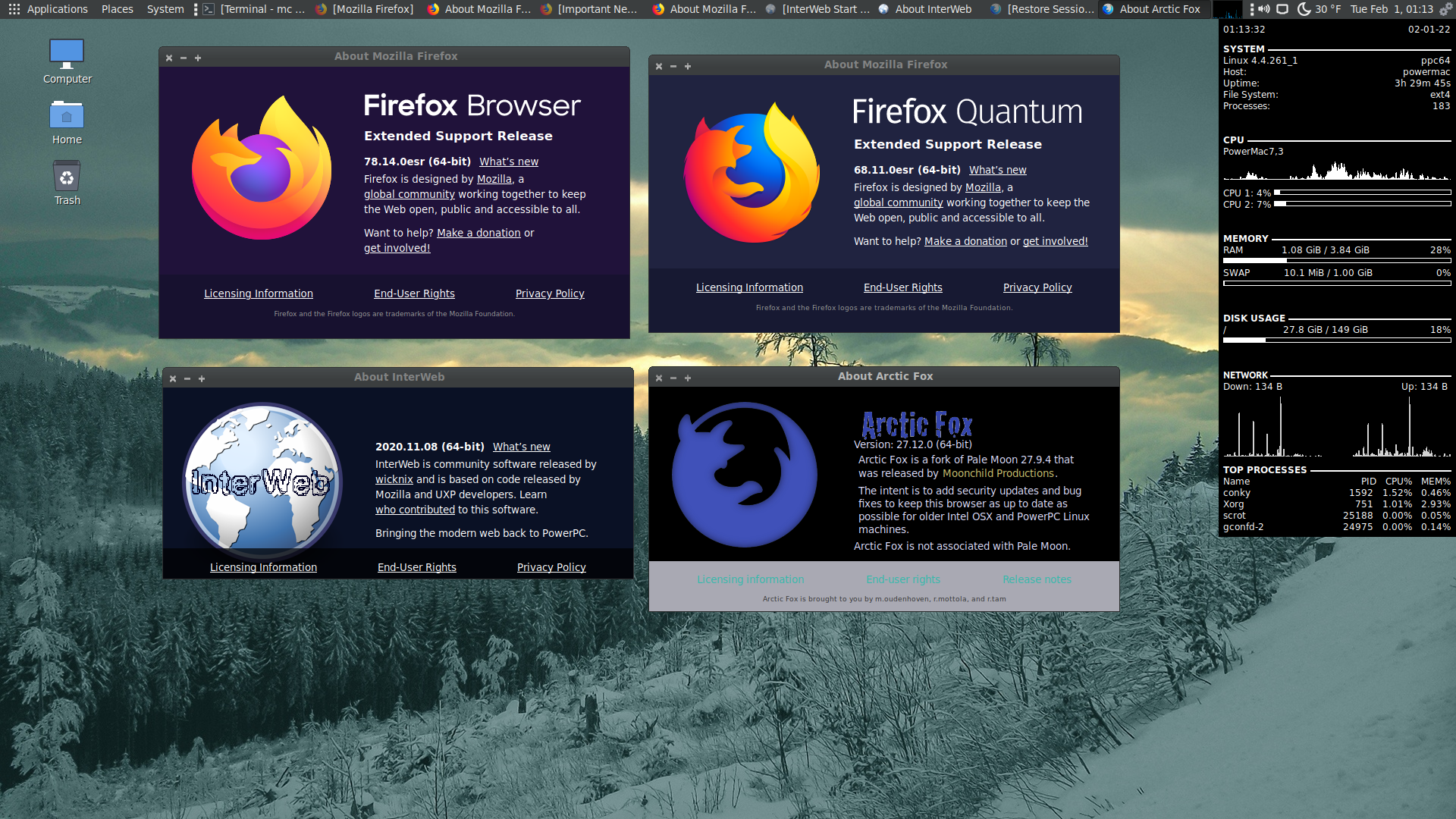

I created an xbps package that installs 4 web browsers for ppc64 glibc Void. It's a bit hackish, and probably frowned upon by the void devs, but whatever. You'll have 4 good working browsers that display proper colors with menu entries. Download link and info found here.
Cheers

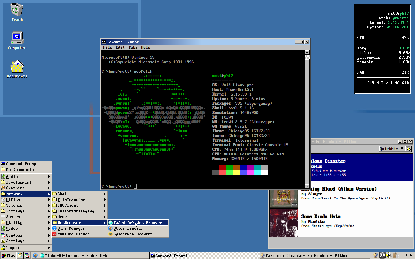

So since the unit i created this on is running void i figured i'd post here, however it'll work on any machine using icewm. I rounded up a bunch of themes, icons, fonts, etc and finally got my machine to look like a relatively authentic win9x/2k. I rolled it all together in an archive if anyone is interested. It's an icewm theme with the usable extra bits pulled from chicago95. Grab it here: https://ufile.io/q3k4uof7
That link is only good for 30 days. Just an FYI.
Screen shot of 17" powerbook. The fonts really do make a difference.
The fonts i used are as close as i could find that weren't copyrighted. I didn't dig too deep as these are close enough for me. 😉

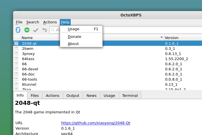

Problem with drop down menus
I have Problems with some drop down menus like the menus in OctoXBPS. After drop down the menu is only usable by keyboard but not with the mouse.
I have the same Problem on 2 different Void installations(Void64), but same computer (G5 2x2 AGP 2004). Can anyone confirm this problem?

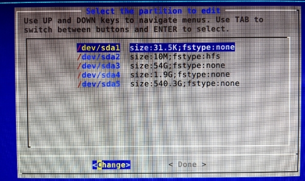

Hi,
I have a g5 quad I'm trying to install void on
If there is a step by step guide in this thread, any body happen to know what page it's on?
It's from the disk partioning onwards where I'm a bit clueless, there is stuff on the void site, but it's showing bits of info for various platforms, and I can't quite make heads or tails of it right now
Thanks
It is not Void, but the commands are the same to create/delete partitionsin pmac-fdisk and help to understand how it’s working.
