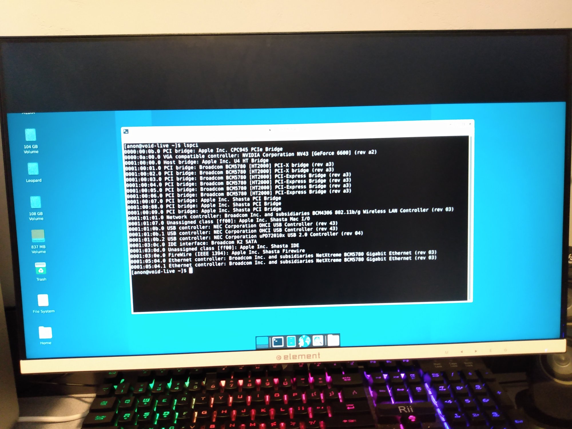

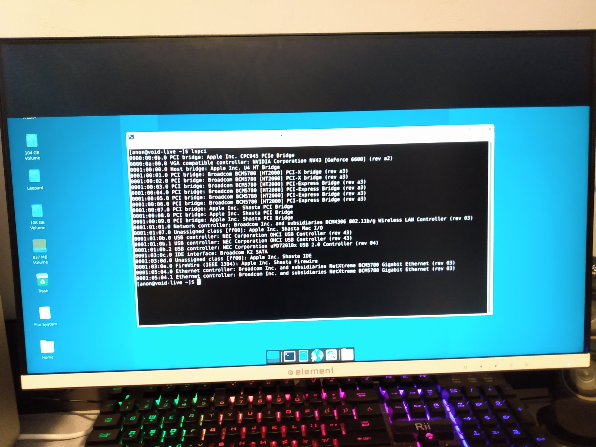

Not really just a Void issue, but any linux I've tried on my 11,2 does this. I swapped out the radeon 1900 for the nvidia 6600 for obvious reasons (1900 not supported). All distros boot to desktop, but they all only show 80% of the screen. The proper 1920x1080 resolution is detected. Changing resolution results in the same problem. Top part of screen is not shown. Display is fine in tiger and leopard. Anyone else with a 6600 ever run in to this? Cant find much info online.

Did you test an other environment like KDE or LXDE?
Tested Adelie Mate & KDE, Ubuntu 12 & 16 w/LXDE, and Void XFCE. Same issue with all of them. Resolution reports fine in all of them. 1920x1080, and I have 2d/3d, 32bit color, etc. Top of screen is just black. Cant see task bars or icons above that point. It's odd.
So... would you believe this? All these weeks of dinking around looking for solutions, using different GPU's (even random PC cards) and they all had the same issue. I was about to give up but then i figured i'd try a different monitor. Had an old 17" 4:3 Acer lcd laying in the closet. Plugged it in. Booted. 100% displayed desktop! Why my 27" 16:9 lcd didn't display properly is beyond me as it displays fine on my dual cpu 2ghz with all flavors of Linux. Anyway, i'm happy even if i have to use a smaller monitor for now. This 11,2 really cruises. Puts the dual 2ghz to shame on Linux.

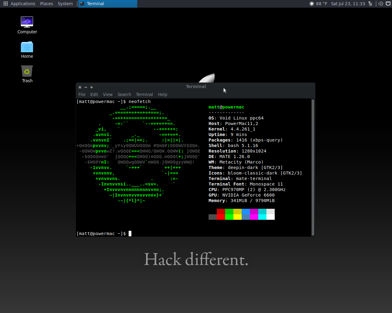

Obligatory screen shot
@wicknix, yes, i remember having problems with graphics card when 2xdvi present, like with 6600. one solution was to use right dvi port instead of left one, may sound silly, but helped. (could also have been vice-versa)

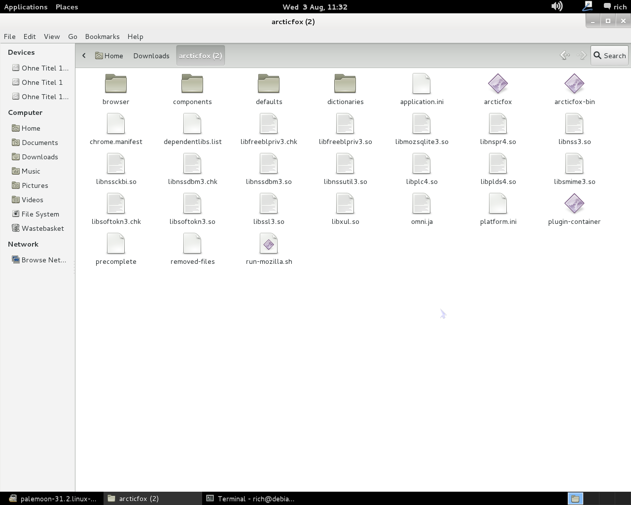

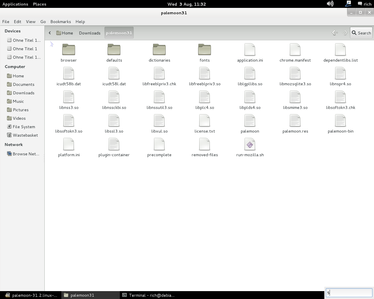

sadly, for one reason or another, the palemoon31 does not show up as executable on debian 7. maybe it is finally time to upgrade.

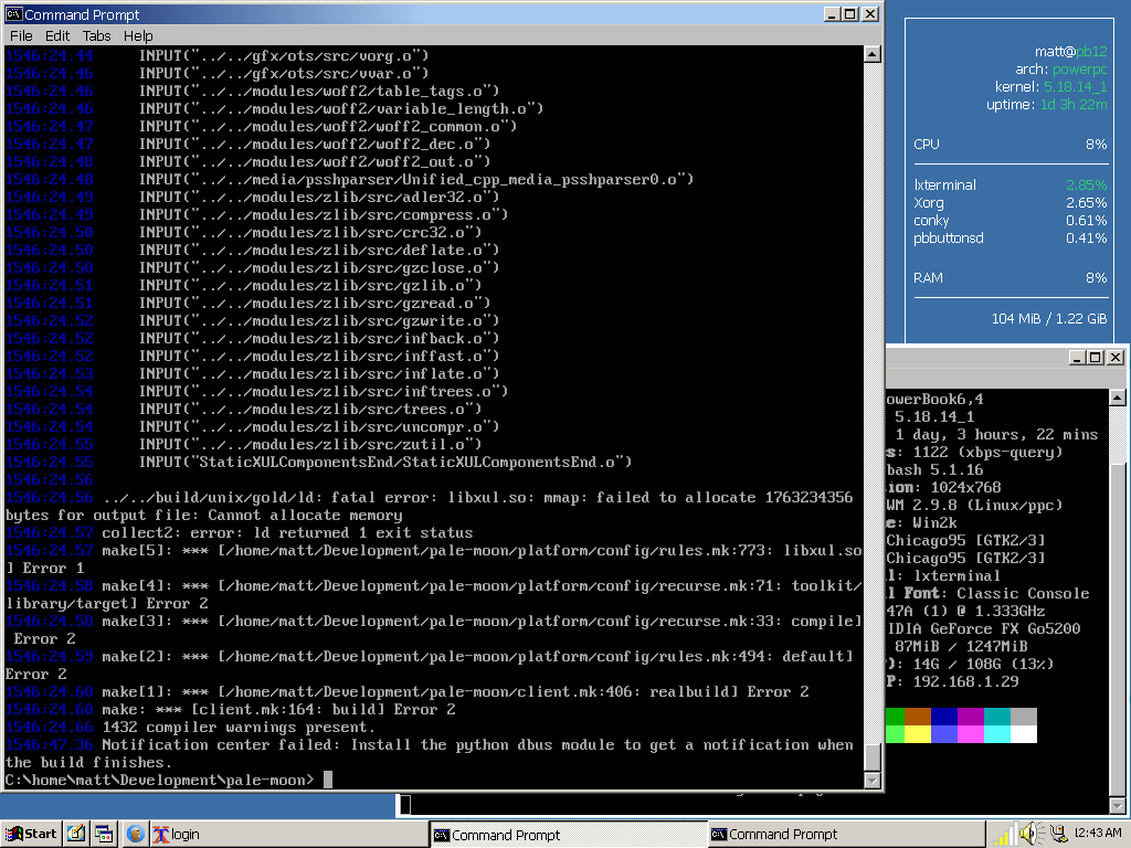

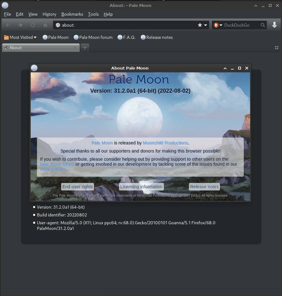

It took fixing 2 files in freebl but i got current Pale Moon to build on VoidPPC64. My only oops... I left official branding enabled so i can't share it.
That's impressive. I have some questions:
1) How that differs from any of your browsers? Ok, the code base should be slightly ahead with some fixes, but anything else? It's better? What's your opinion of using it until now?
2) Do you still have the instructions of how to build it for future generations sake?
Thanks
Newer patches, security updates and some other goodies like improved javascript. So some sites do render again that were broken before.
I started a 32bit build on my 12" powerbook when I left for work this morning. If it successfully builds there as well i will upload that binary and the files i changed.
Cheers
Well... the powerbook didn't have enough memory, even with swap, to link libxul.so. 16 hours this poor machine screamed for nothing. Lol. The good news is i know it'll build on 32bit since it got that far in to the build. I knew killing ubuntu off on the DP G5 would bite me in the arse some day.
Anyway, if someone else wants to give it a shot my fixed source is here.
Build instructions here.
