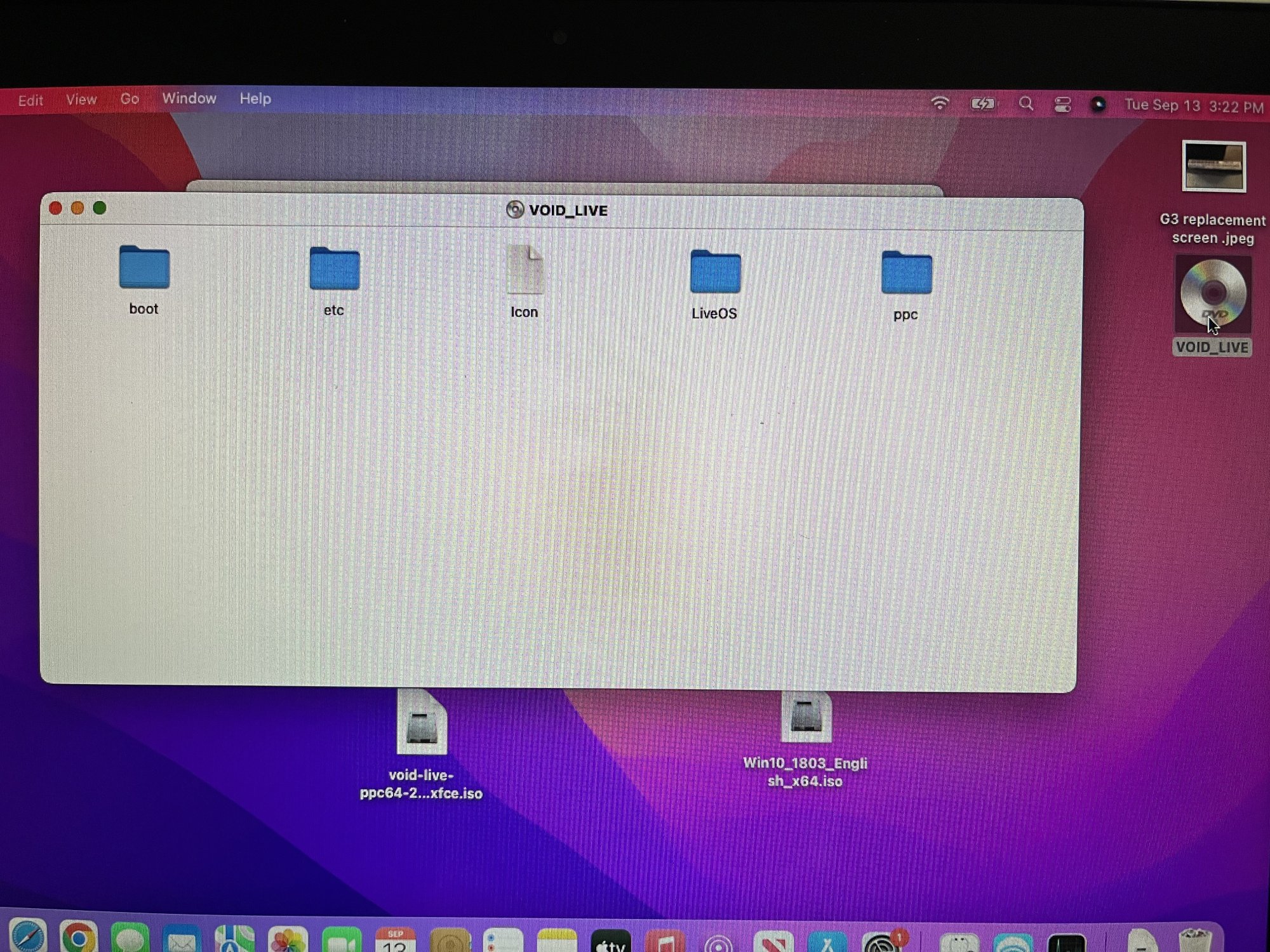

I have never used Linux or installed it. I am finally ready to install Void Linux PPC on a second drive in my Power Mac G5 7,3 DP 1.8 w/ 4 GB of RAM.
I created an installation DVD using PPC64 XFCE. As you can see, the disc is recognized on my 2010 MacBook running 12.5. However, I cannot boot off of the CD on my G5. I tried holding down C during boot and help Option and it doesn't show up in the boot loader. When booted into 10.5 the CD is not recognized.
Any ideas?
Did you use the correct big endian ppc64 iso?
Is the G5’s DVD drive OK? Can it read other burned discs?
The full file name is- void-live-ppc64-20210825-xfce.iso
I assume that is the correct one.
Yes, the drive doesn't have issues with reading other burned discs.
You have the correct iso. However G4/G5 cd/dvd drives can be picky. Best advice: download and burn the iso from tiger/leopard using the slowest speed to burn. Should work then.

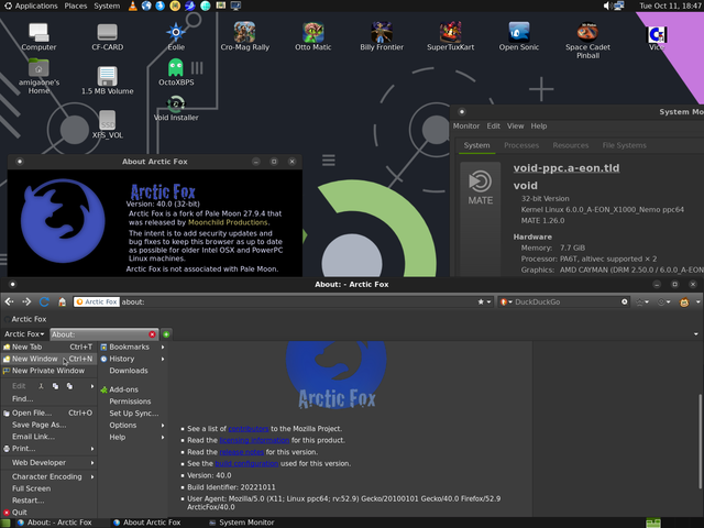

Hi. I'm trying to build the latest version of Arctic-Fox for Void PPC64 (first time I'm trying to build Arctic-Fox). I edited the .mozconfig file to use gcc-6 instead of the current gcc. Running ./mach build ends quickly with a missing dependency error. The culprit appears to be libatomic missing ("/bin/ld: cannot find -latomic" and "collect2: error: ld returned 1 exit status").
Since libatomic.so.1 is already in /usr/lib64/, how do I properly let ./mach build use it?
Thanks.
EDIT Nevermind... libatomic was installed, but not libatomic-devel... It compiled with current gcc without a hitch.

I compiled Arctic Fox 40.0 with the following mozconfig for Linux PowerPC three days ago.
.mozconfig for 32-bit userlands with 64-bit kernels:
Code:
# This Source Code Form is subject to the terms of the Mozilla Public
# License, v. 2.0. If a copy of the MPL was not distributed with this
# file, You can obtain one at http://mozilla.org/MPL/2.0/.
export CC="gcc -m32 -flax-vector-conversions -O3 -falign-loops=16 -falign-functions=16 -falign-labels=16 -falign-jumps=16"
export CXX="g++ -m32 -flax-vector-conversions -fpermissive -O3 -falign-loops=16 -falign-functions=16 -falign-labels=16 -falign-jumps=16"
export LDFLAGS="-latomic"
mk_add_options MOZ_OBJDIR=@TOPSRCDIR@/obj-ff-dbg
ac_add_options --disable-crashreporter
ac_add_options --disable-tests
ac_add_options --disable-debug
ac_add_options --disable-updater
ac_add_options --enable-mozril-geoloc
ac_add_options --disable-webrtc
ac_add_options --disable-safe-browsing
ac_add_options --disable-parental-controls
ac_add_options --enable-release
ac_add_options --disable-necko-wifi
ac_add_options --disable-eme
ac_add_options --disable-gamepad
ac_add_options --enable-dbus
ac_add_options --disable-gio
ac_add_options --disable-pulseaudio
ac_add_options --enable-strip
ac_add_options --enable-install-strip
ac_add_options --enable-application=browser
ac_add_options --with-branding=browser/branding/arcticfox
ac_add_options --enable-optimize
ac_add_options --disable-jemalloc
ac_add_options --disable-gstreamer
ac_add_options --target=powerpc-linux-gnu
ac_add_options --host=powerpc-linux-gnu
Download: arcticfox-40.0.linux-powerpc.tar.bz2
It works on Void PPC, MintPPC (Debian Sid), Fienix and also on an old Ubuntu 10.04.
Screenshot of Arctic Fox 40.0 on Void PPC:
