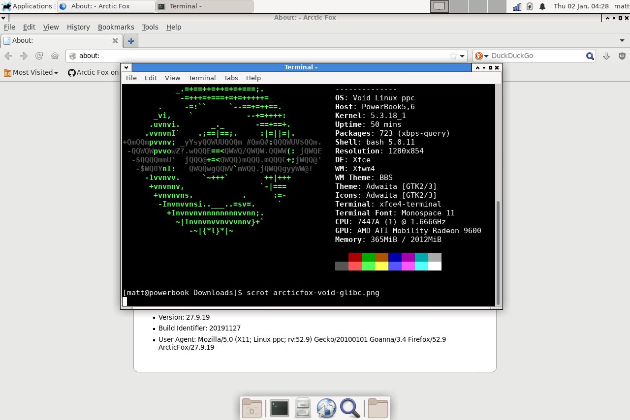

ppc32 void only has epipihany/midori webkit browsers and they are oddly slow
Chromium-based browsers are unavailable because chromium refuses to build on 32-bit ppc. According to some online conversations the void ppc maintainer has posted, it appears that 32-bit builds of gecko-based browsers (namely Firefox) will build cleanly but then proceed to segfault very early in initialization.

Void is getting there. Another few months and it may be a usable daily for me, but lack of audio on my powerbook, no backlit keyboard, no working volume keys, no working right click with the touchpad are a no go for me. I put Ubuntu back on for now as everything above works.
