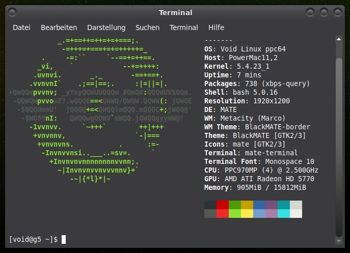

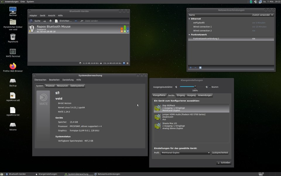

Hallo again, seccond time i installed void on a g5 quad.
Hardware: bluetooth, wifi, audio (firewire digi002) works. A hd5700 graphiccard is working, but i think no acceleration. Is it possible? How to do that?
Software: Ffox 73.0 (colorprobs), LibOff6.4, Thunderbird, Gimp are working. Ardour is installed, but doesn't work. Maybe someone can help?

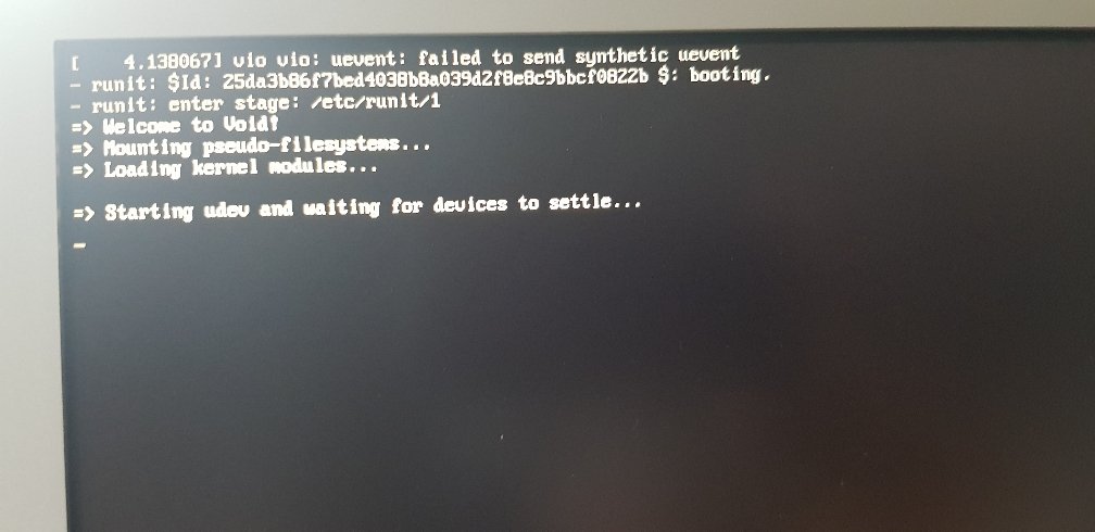

I also tested a hd6970 graphiccard. The g5 booted, at the beginning i saw text, but the loginmanager was spoilt( s. pic.). Maybe someone know to solve this?

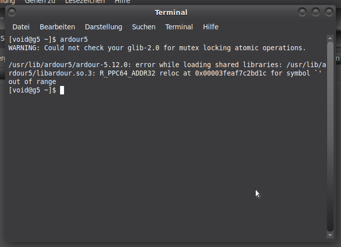

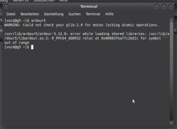

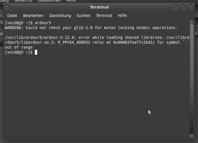

For Ardour, i got a (glib2.0-) error message (s. pic).
For the hd6970: i have 6-pin and the 8-pin connected to the power supply. In the Amiga-Fienix-Linux forums, i read, that suchlike cards could be possible with a powerpc....?
could be a power management issue, the card is pretty hungry, and the PCIe slot might not be able to give out enough juice for graphical output to work correctly
The X1900 GT in my DC G5 requires a 6-pin power cable, small end attached to the logic board, behind the plastic PCIe guiderails, big end attached to the GPU. It uses the same power cable as at least the '06, '07 and '08 Mac Pros.
If power management works fine like that, it should work fine via the same method with newer, hungrier cards.
@dreadone how do you check that the acceleration doesn't work? Also, are you on glibc or on musl?
@z970mp i mean the power supplied by the PCIe slot itself, only x16 is required to be able to provide full 75W, and the one x16 needs to have the original GPU in it.
@q66_ Why does the original GPU need to be in x16? I've run a 6600 in x8 with the X1900 GT in x16 with zero problems.
Bandwidth availability is the only difference, to my knowledge.
@dreadone I fixed the ardour problem; the package was using bundled libraries and those were somehow miscompiled. I switched it to use external libraries and it works fine:
The issue was also affecting little endian. Either way it should work once the next batch gets uploaded.
(the glib related message is a red herring and completely unrelated btw)
