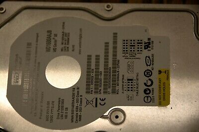

@victoria99 I've found another hard drive of a suitable quality. Unfortunately, they seem to be getting sparser by the week:

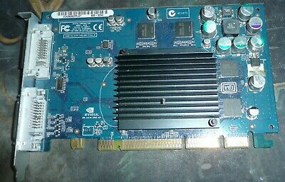

And here's another GPU:
Please be aware however that if you decide to buy the above GPU, you will need to tape two very small pieces of scotch tape over two specific pins on one side of the connector contacts before installation, otherwise you will not get a picture out of the display upon boot. If you feel that this is a doable task, then by all means go for it. Otherwise ... there are ways to minimize the VRAM consumed by the system so that the existing GPU does not have to be strained to the same extent. Although this is obviously a comparatively un-ideal solution.

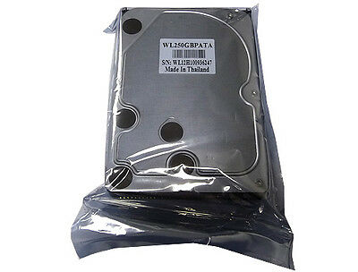

I found this HD on ebay. It's a little more than I wanted to spend, but when I see that most of sellers are charging $7-$10 for shipping and the HDs are used I thought it might be a good deal? They call it a white label. Seller is Apethouse...any experience with them? Cost is $19.99.
250GB 7200RPM 8MB Cache ATA/100 (IDE) PATA 3.5" Hard Drive w/1 Yr Warranty - New​
FREE SHIPPING, Sealed in Bag, 3.5" Desktop Hard Drive​

The FX5200 is a piece of garbage not worth bothering with.
The only time I've ever felt any difference in performance changing the GPU was when I changed from a Radeon 9600 to the FX5200 (for ADC compatibility) and the reduced performance was notable - I soon switched back to the 9600.
In this context at least it has more VRAM than her current card - though my opinion is any GPU within the range of that MDD is a waste of money.

@Amethyst1 Compared to literally every other offering in its generation, yes. It is not up to snuff, to say the least. But, it is still a superior card to the GeForce4 MX in use now, is currently the only affordable upgrade option, and there will be some relative improvement after switching to it (considering the display resolution it has to pull), if no further upgrades are to be had again.
That being said, considering the fact that a 9600 would require the same amount of work to prepare while still offering far more bang for the buck, that remains an alternative option, albeit not an immediately accessible one. But of course, the final decision is up to Victoria.

@victoria99 - I have a Radeon 9650 (9600) that might even be taped already. That would be a huge upgrade over your current card. Shipping to the US would be a little on the expensive side though.
Still not worth wasting 20 bucks (or any money, for that matter) on. My point is - any money spent on that MDD should be spent wisely.

@victoria99 Let's see ... good cache, good rotational speed, good seek time, good transfer rate, and good platter density ...
Looks good. Go for it!
