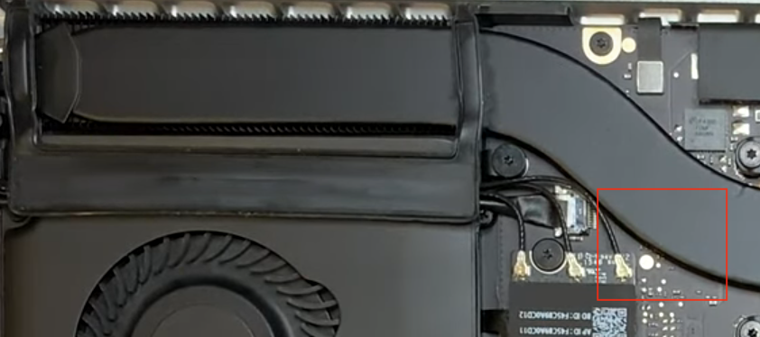

Yes I do! Sorry for the delayed response. I haven't opened the back of my Macbook in a while, but here's a photo of where that antennae plugs in. It's the cable that is shown in the red box. That red box will indicate the location of where the antennae plugs in.

Sorry for the double post; I'd like to also mention that I've tested Bluetooth, and I think because of this issue (i.e., antennae cable not sticking on), even my AirPods Pro (connected via Bluetooth on this issue-stricken Macbook Pro) are not connecting or emitting sound properly. There's random connecting and disconnecting that's going on. The same AirPods Pro are connecting perfectly fine on my iPhone 8+.
