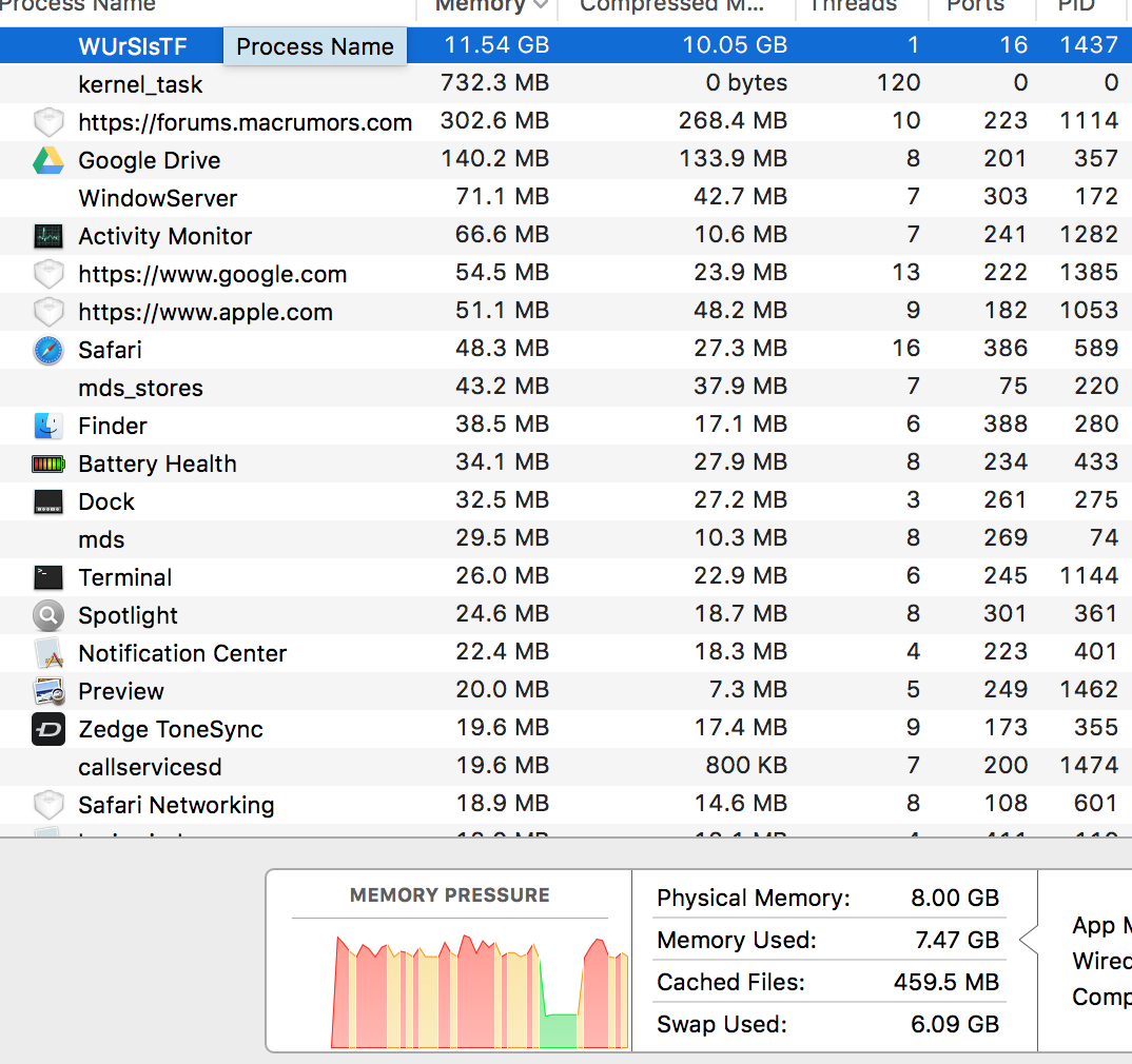

So I have been trying to diagnose my battery issue because I am not getting much on just safari with 50-70% battery life (2015 rMB m5). I opened activity monitor and discovered this unknown process name that when I google it there is NOTHING on it. It takes up on average 30 gb of processor memory and around 50% total of cpu usage.
The only questionable thing I may have download was a rom for the openemu emulator which I thought I deleted (it was sonic the hedgehog 1). Other than that, anyone have any advice?

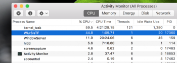

I haven't heard of it either. You might be able to find out more about it with some Terminal commands:
top -u
will display in a manner similar to Activity Monitor. Find that process and look at the PPID (Parent Process ID) column and note if it's any process other than 1. If so, you can search for that parent process using (replace x with the number):
ps axu | grep x
Ignore the extra "grep" process it finds.
In any case, you should can try killing the process with:
sudo kill -9 17360
Reactions: Eggtastic
Forgot to add: you exit 'top' with a Control-C. That will make the results disappear, so write down the PPID first (or open a second window with Command-N).
Before you kill it, another command that's useful is 'lsof'. It shows which files the process currently has open:
lsof -p 17360

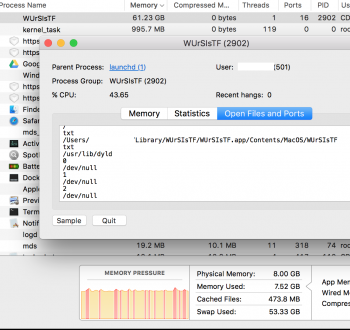

Just an update, I ran malware bytes as a first line of defense and nothing killed that weird activity. Second I took your advice MC6800 and nothing happened either.
I included some screen shots as to what is happening as it runs and once I close it the significant dip in memory pressure. Of course once I force kill this it pops right back up. Should I take this to an apple store or can anyone else recommend software or other ways to figure out what this is?
Select the item like you have there in Activity Monitor then hit command-i (both keys at once) and you will get a window like this where you can click on Open Files and Ports to see what files are making that process appear.
Reactions: CoastalOR
Alright here is what I found, what do you think?
Your screen shot shows the location of that app. Drag it to the trash, then restart.
If it immediately re-appears in that same location, despite being in the trash - download and run EtreCheck.
Post the results here, and someone may help you determine if that is something that is reported there.
You may even find that EtreCheck helps you remove it, or may even give you some information that it may not be safe.
Or - restart in Safe Boot mode, then remove that file, and restart once more.
I think you have installed the malware called Pirrit or VSearch.
The big clue is searching Google for an app called "wursistf.app" finds nothing. That is because the malware makes up a random name for that app when it is installed.
See this thread and this thread for more info.
Look in the folder /Library/LaunchDaemons/ and I bet you see a plist there called wursistf that is launching this.
Do a safe mode boot by restarting while holding the shift key, then run MalwareBytes to get rid of the Malware.

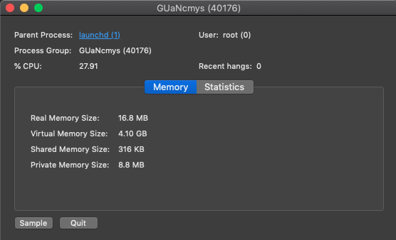

Can anyone tell me how to get rid of this process that keeps taking all my CPU? If I quit it, it comes back about three-five minutes later.
