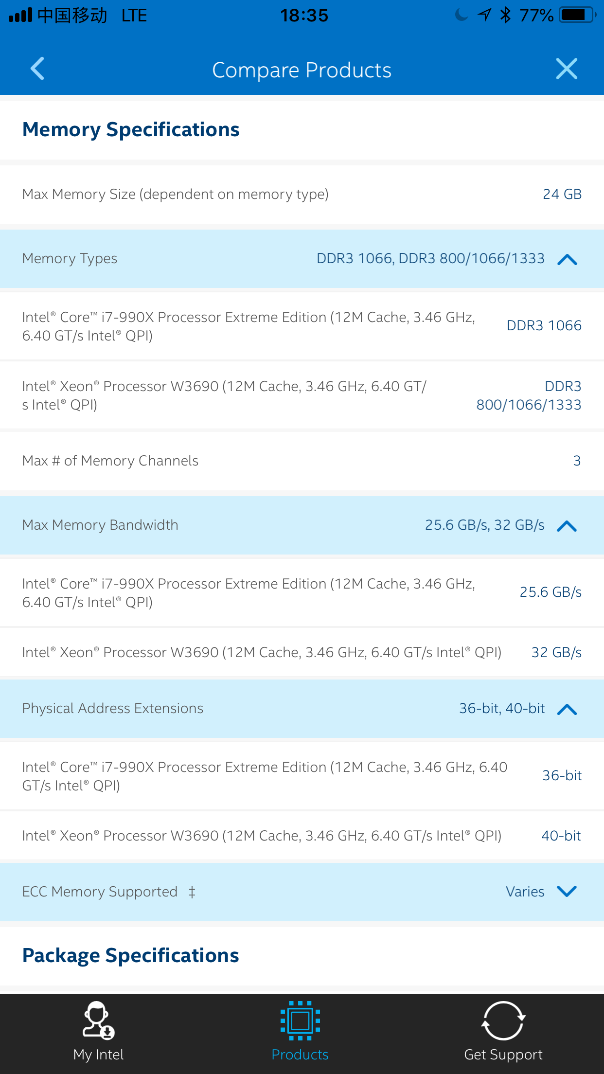

The CPU spec about memory handing is quite different between i7 and Xeon actually.
May be the i7 hit the memory bandwidth limit quickly. Therefore, 3 or 4 sticks doesn’t really matter (that “faster” is very tiny, within normal error margin).

UDIMM will do much worst when more than one stick installed on a single channel. On the other hand, RDIMM is not a problem.
OP use 16GB DIMM, that must be RDIMM on the cMP. Therefore, he won't suffer from the 2T or 2N timing issue.
But your 24GB / 32GB config can be UDIMM, in this case, it can explain why your pure memory performance degraded a lot when you utilise the 4th slot.

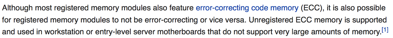

he was saying this in my thread also. but then also tells us how non-ecc RDIMM is faster, even though it doesn't exist.
h9826790
macrumors P6
Apr 3, 2014
15,986
8,064
Hong Kong
It is a fact that RDIMM work better when more than one DIMM installed on a single memory channel.
https://en.wikipedia.org/wiki/Registered_memory
Can you prove that is wrong? You know nothing about how the memory work, how to categories them, how to perform some simple math calculation, how to make reasonable assumption, how to discuss, and even how to read.
This is all I know from your thread.
And I NEVER say non-ecc RDIMM is faster, in fact, I never talk about this particular DIMM's performance at all. I just said ECC has nothing to do with registered or not. You still can't read despite I've said that more than 3 times.

x59 chipset VS intel 5520 chipset
Or EFI version 07F vs 085?
It's hard to tell.
But I don't think the BootROM has any effect on this matter.
Dual processor may make the difference. However, form the previous threads. It shows that even single processor cMP can still shows a significant memory performance difference when the 4th slots in use. Therefore, we may also safely remove this variable (as well as the chipset difference).
The remaining suspects are Xeon vs i7, and the memory spec itself.
It's very hard to tell if i7 make the difference because so little users using that here. Therefore, unless you have some UDIMM on hands to make the test. It won't be that easy to find out which one is the most significant parameter.

Please show me the exact post that I talked about the non ECC RDIMM's performance.
registered memory has nothing to do with ECC. And registered memory do perform better
non ECC RAM can be registered.
RDIMM will be faster
Registered or not has absolutely nothing to do with ECC.
Registered NON ECC RAM exist.
you going to deny you made these remarks?
also, go ahead and find a registered non-ecc memory for sale, try newegg or ebay, where are they?
