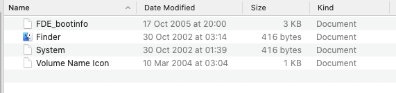

On PPC Macs however, I think it is actually some form of OS 9. I checked the files on two of my PPC Macs and booted them to compare. On my TiBook 867 (the last model to officially support OS 9) the AHT is shown as Mac OS 9, and boots up as such. The disc has all the files required to start Mac OS 9 and it is listed with a Mac OS 9 icon in the OF.
Following on from this, I downloaded ASD2.6.3 as this is the one that will run on my A1117 G5. It is a dual-boot DVD and when making the hidden files visible you can see an OSX volume and an OF volume as I expected. What you thought was an OS9 System Folder is just OF code. A System Folder of 11K probably wouldn't even boot my MacSE - it only contains a 416 byte Finder, a 416 byte System file, a 3K file called FDE_bootinfo and an icon. So, sadly, no short cut to booting OS9 on G5 hardware.
