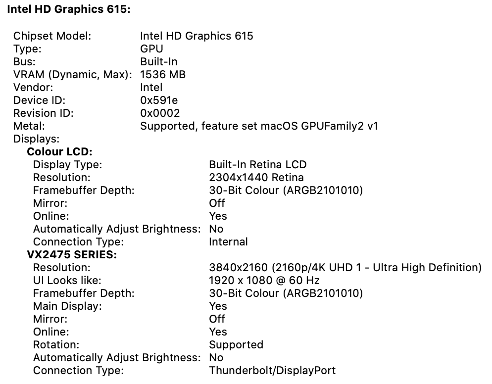

BOOM. Macbook running internal display @60Hz, and external display @ 4k@60hz (1920x1080 HiDPI), and charging, and using my usb mouse & keyboard.

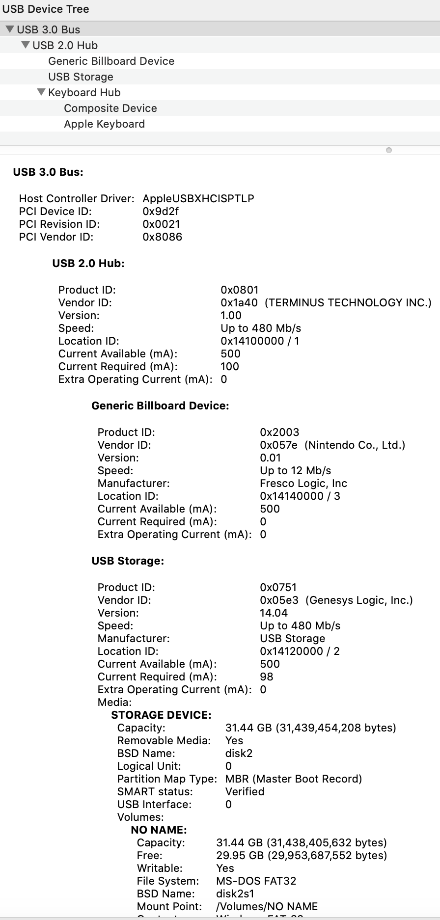

I've attached a pic of the displays, and a pic of the USB (though I can't fit everything on the screenshot) from system report.

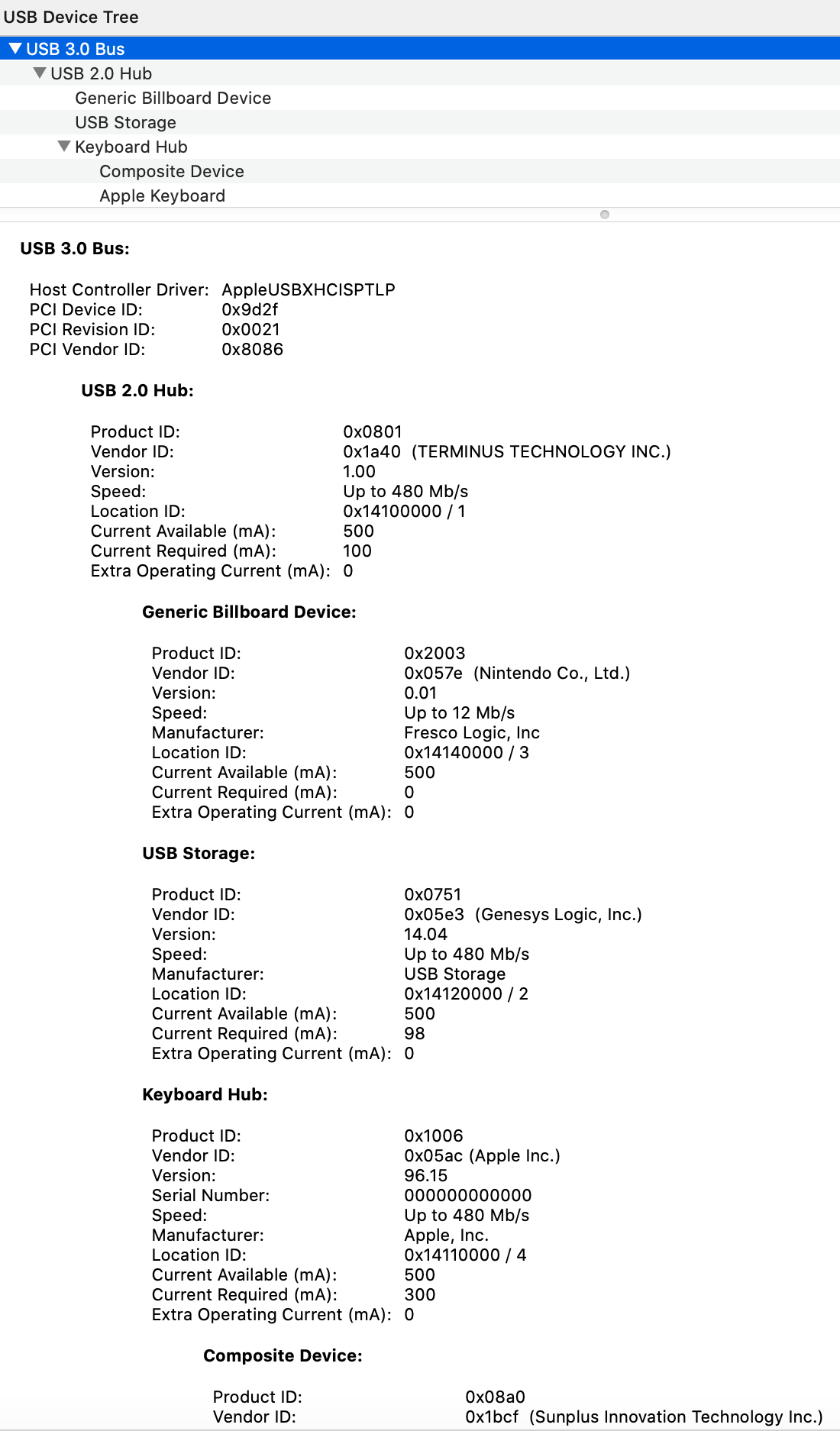

Update: Okay I thought for complete sake I'll quickly test the SD card slot. Works fine! Attached another USB system report pic.

Update 2: I have no idea why it's saying Nintendo Co in the system report, I guess they might have to name it that to trick the Nintendo switch for it to work properly or something, because the cable is also compatible with the switch.

According to the USB ids database, 0x057e is the Vendor ID for Nintendo Co., Ltd. It's an interesting theory that the billboard device requires a Nintendo Vendor ID to work with the Switch. I guess the way to test that is to use a different USB-C hub with the switch.

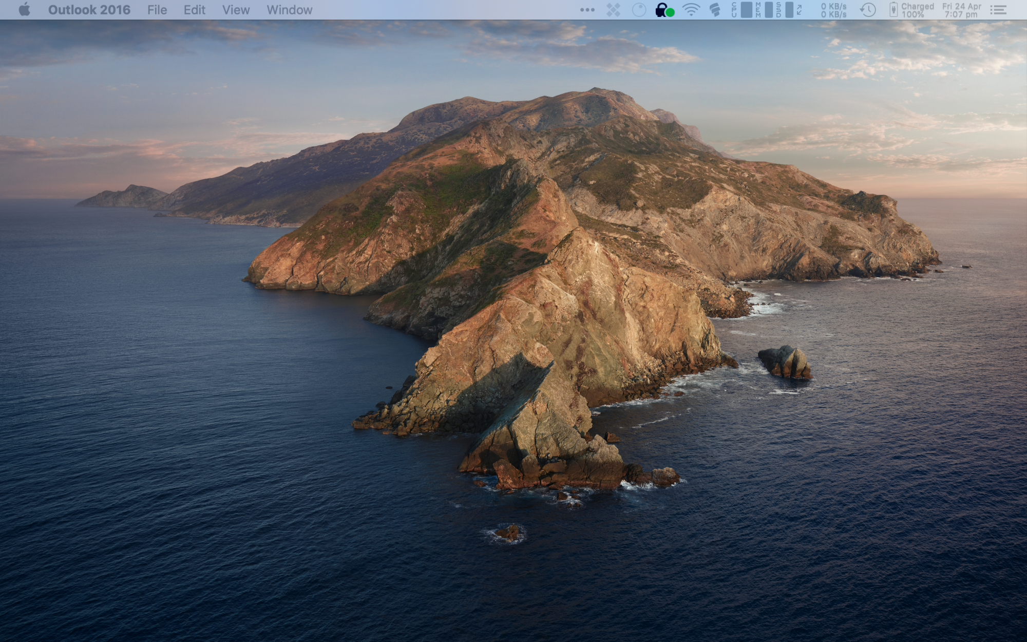

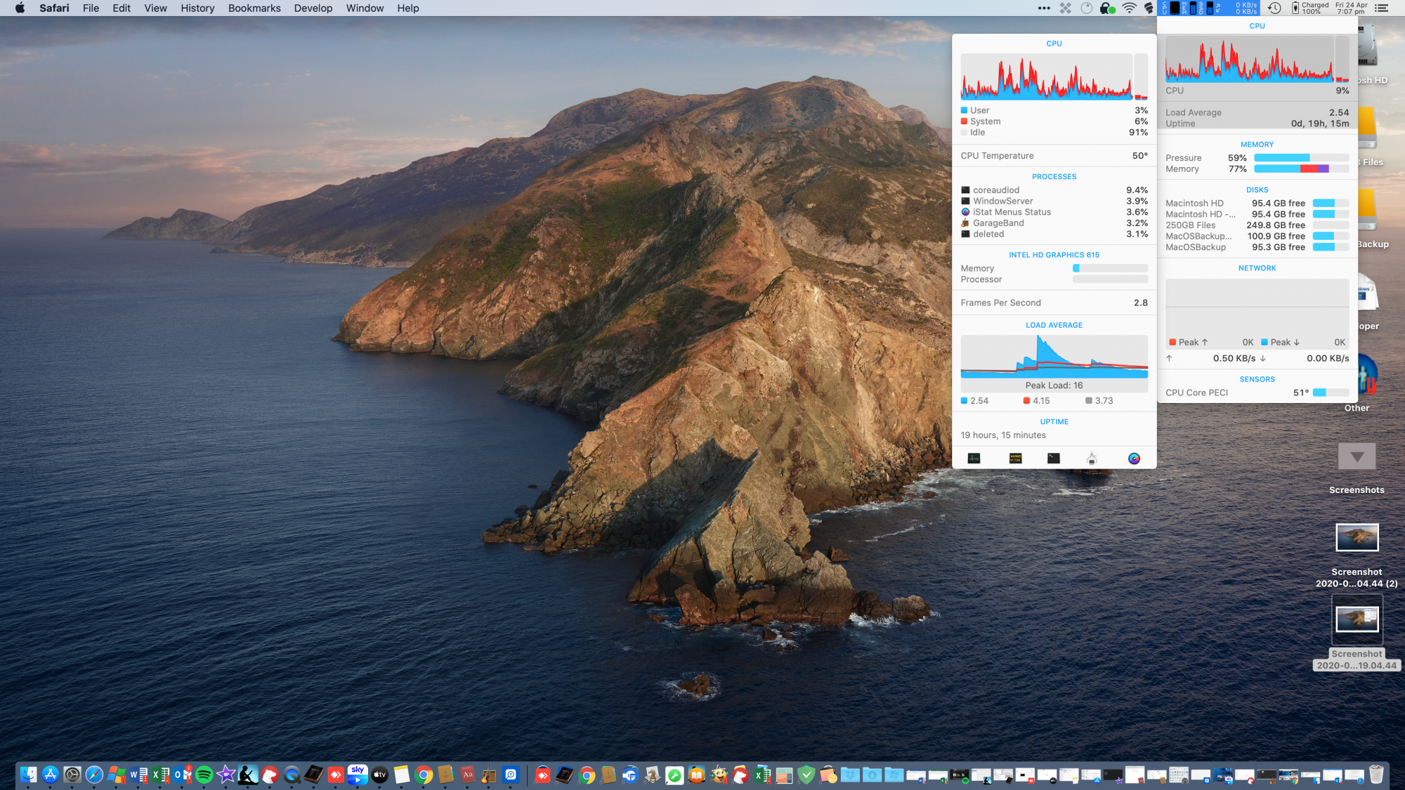

But it doesn't stop there. I've attached a pic where I've opened 23 apps, this is while it's running on the internal display and external display at 60hz. AND IT'S STILL RUNNING BUTTERY SMOOTH, EVERYTHING, the entire MacOS and the VM, opening apps and using them, listening to Spotify. It's incredible! And the CPU is not any higher than 60c, averaging around 50c. I'm not sure how the MacOS (I'm on Catalina 10.15.4) and this m3 CPU does it. I think the internal SSD probably makes a huge difference.
Don't underestimate the 2017 Macbook, even the base model with the m3 CPU and 8GB of RAM. It really is running stupidly buttery smooth, it's unbelievable.

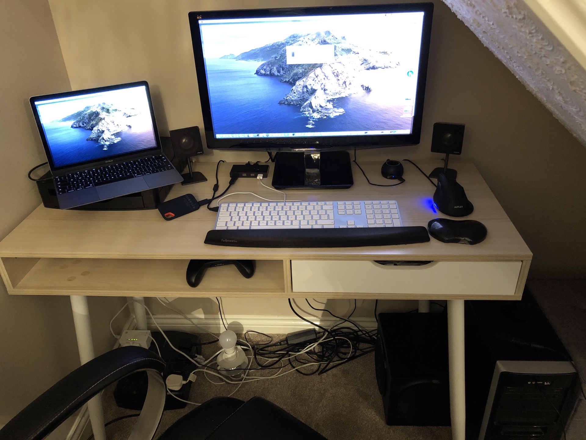

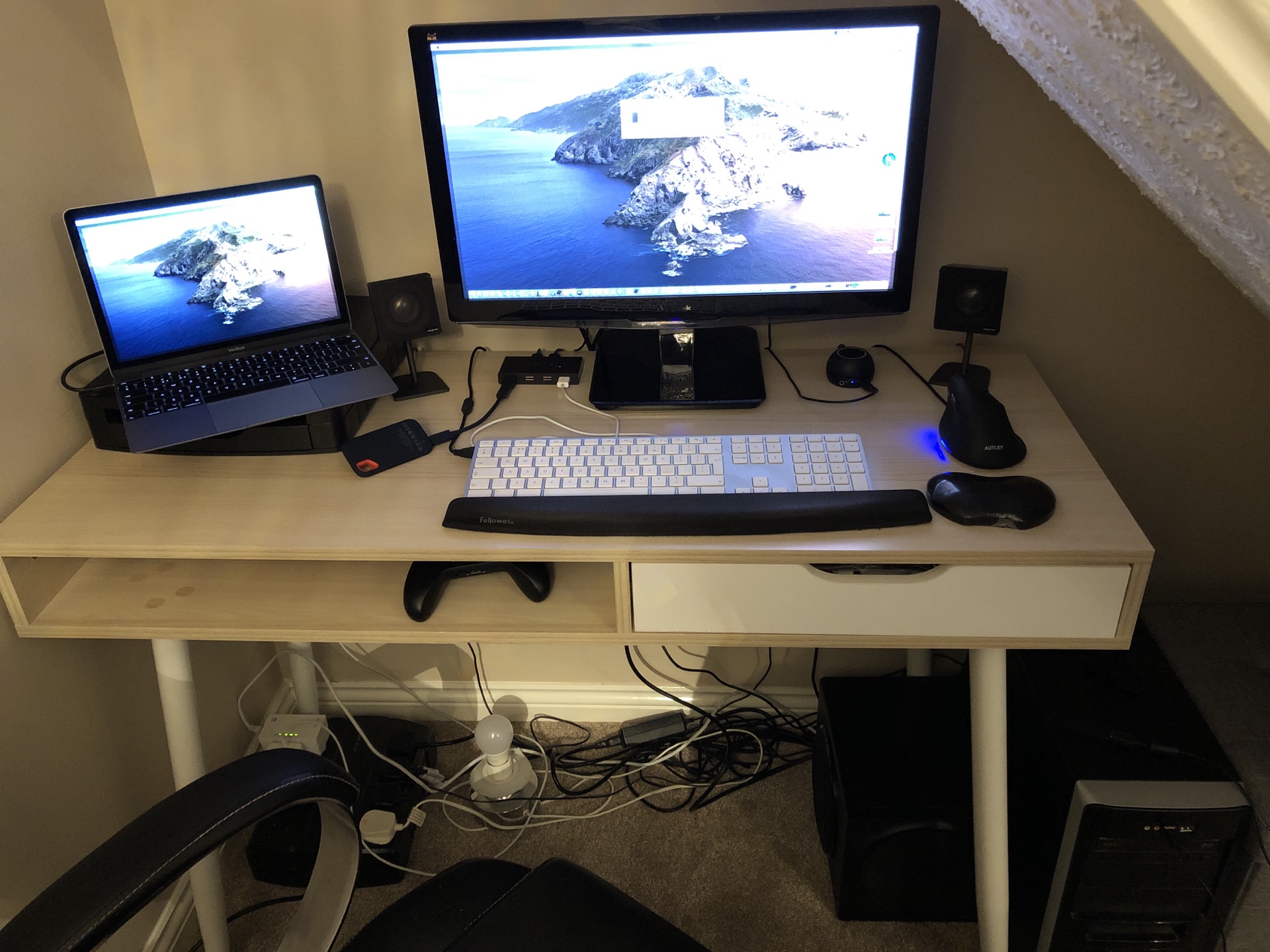

Also attached a pic of my setup. Note if it weren't for my PC, the wires under my desk would be pretty much non existent. Also the photo doesn't capture the colours/clarity of the screens, they aren't washed out.

I noticed PowerPoint is a problem in MS Office for Mac, because there must be a memory leak. With large PowerPoint presentations, they will open with a couple of hundred MB, but after a while that can balloon to several GB. But I'm usually OK since I've got 16 GB RAM in my 2017 Core m3 MacBook. 🙂
