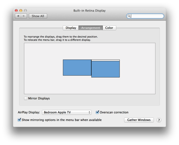

now I'm facing a different problem, i can't seam to display the same image over two monitors, it just cuts off.
i can get extended desktop and an image on second monitor, but it won't share the same image,
Make sure your monitor arrangement set up in OS X is identical to the monitor arrangement in real life.
The displays were correct as in your diagram, the solution however was in mission control. when you update from snow leopard to yosemite it doesn't let you share and image over two monitors. There is a check bock in mission control called "displays have separate spaces" this needs to be unchecked.
