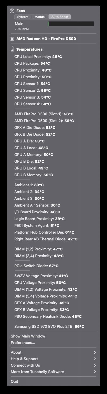

Back to #trashcanchat, I think I'll be doing some re-pasting/cleaning this weekend. It was already idling a little hotter than seemed normal, but this last week I'm regular seeing CPU temperatures of 70C+ when it's just sitting there. No weird process spikes in Activity Monitor. CPU/GPUs idling and the RAM pressure as flat as the screenshot I posted before, so I think it's time for a bit of maintenance. 🧑‍🔧 🫣
Yes, it is a good plan to do once in a while.
This is what I am seeing while watching youtube and surfing the forum right now.
Reactions: JulianStaples
Those are the temps I crave. 😊 I haven't repasted/cleaned it since I picked it up last year tbf. Easy enough for my idiot hands to mess around tearing broken £20 eBay finds apart, more risky with a Mac that's actually worth something. 😅 Still, it's got to be done.
I only cleaned the system and repasted the cpu. I dropped the cpu while doing it and didn't feel like doing the gpus at that point. Haven't revisited it since but my temps seem IMO quite ok. I did't ramp up the fan speeds a bit and modified the trigger points to improve cooling. Additionally I placed the trashcan on a ceramic coaster which lifts it maybe 1.5cm off the table giving a more relaxed path for air to enter the input.
I will repaste the gpus too some day. But as long as they seem to hover at these temps I am not worried. Right now gpu temps are between 38-46°C.
