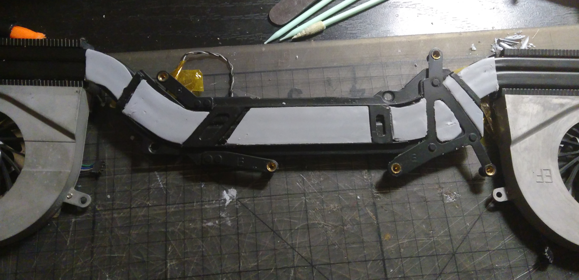

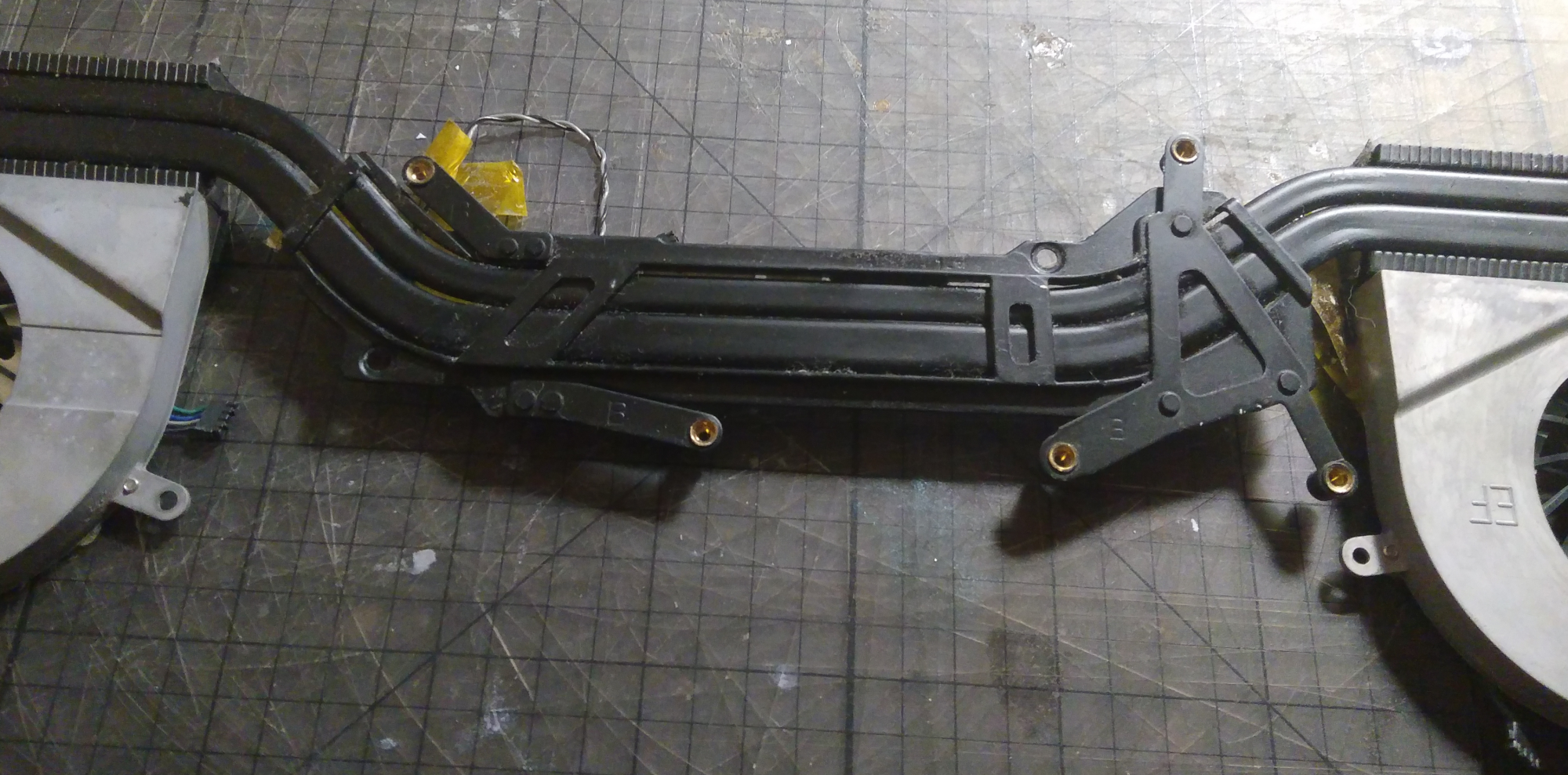

As a winter weekend project, I wanted to try something with the cooling situation on my A1261 MacBook Pro.
It’s not really a secret how the aluminium MBPs have the tendency to run pretty hot at even the best of times. But I got kind of tired dealing with a really hot lap after using it for awhile — even to the point where it was slowly scalding my thigh.
This MBP was the one I only started using last year after sourcing a green-dot board for it. As with all my Macs, I use Noctua NT-H2 paste, which is consistently pretty good at doing what it’s supposed to do. Even so, the MBP was still warm to hot in very localized spots directly beneath the heat sink bridge, particularly on the left side (or, the side nearest the Magsafe adapter). I’m guessing a far-infrared camera would have shown three localized hot spots where the CPU, GPU, and memory controller are located.
So I thought about the underside of the heat sink bridge and took stock of how there are only small portions of the bridge which actually make direct contact with the bottom case. Since the bridge, as designed, can shunt only so much heat to the fans, there aren’t other ways for heat conduction and dissipation to take place.
Except, well, perhaps there might be!
Borrowing from user discussions on improving heat dispersion in current-gen Silicon MacBook Airs, I bought a 10x10cm sheet of 1mm-thick silicone thermal pad. I went ahead and cut out pieces of the thermal pad to fit the underside areas of the heat sink bridge (which otherwise don’t make contact with anything, aside from poorly circulated air) to help to move some of the heat generated to the aluminium case, rather than make the fans do nearly all of the work.
If all worked as planned, the overall temperature of the case would feel warmer (including around the palm rest), but this manner of heat dissipation would also take longer for the fans to rev up as high to move out heat and to “de-localize” the hot spots underneath the laptop. In other words, I’m using the aluminium case more directly to keep “hot spots” from getting so hot so often and to make resting it on my lap more tolerable.
Before:
After:
There were a couple of tiny spots I could have filled in, but for sake of testing, I left them alone. I didn’t use thermal pads in the zones next to the fans, as those are sealed by a thin foam rectangle factory-attached to the bottom case (and sealing away air within from the rest of the case). I might come back to those later.
(While I had the heat sink bridge out, I also opened the fan assemblies, cleaned out a year’s worth of dust, and added to the spindles a drop of the lubricant I’ve been using for refurbishing fans.)

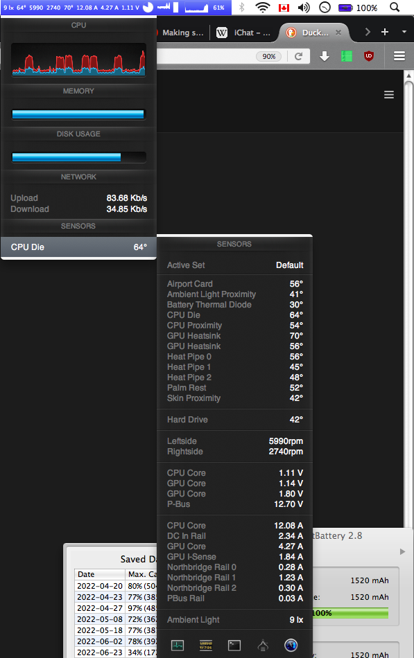

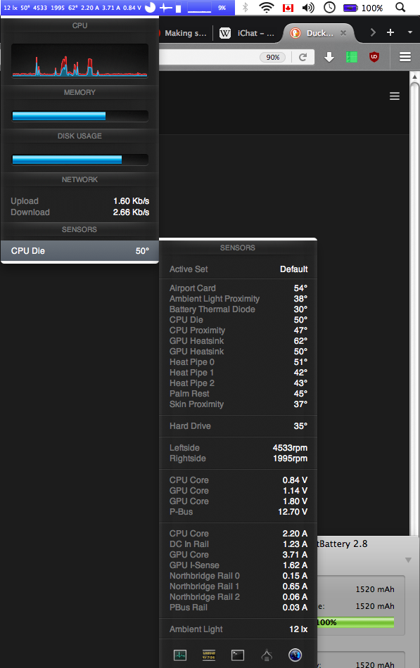

I ran a screen cap of the temps before I put the system into hibernate, and about an hour after I woke the system from deep sleep. The ambient room conditions were the same:
Before:                           After:
View attachment 2115841View attachment 2115844
The numbers to pay especial notice to are these:
View attachment 2115846View attachment 2115847
I wrote this post with the laptop on my lap, and for a change, it isn’t slow-cooking me. The fans aren’t moving as quick as before, while the top case and overall bottom case are perceptibly warmer. The above data are the best I can do without access to an infrared camera.
tl;dr: Not so hot!
EDIT to UPDATE, late into day 2: Even as this is still pretty early, post-modification, there is still a noteworthy drop in overall temperatures around the areas of heat generation — namely, the CPU/GPU areas and their respective heatsinks. In the 7-day line chart on iStat Menus, the drop in overall temperatures at the typically hottest area — the GPU heatsink — is evident (the break in the line is when the system was in hibernate mode and while I was adding in the thermal pad modification).
Overall, the CPU die is about 12°C cooler; the CPU proximity is about 6.5°C cooler, and the GPU Heatsink(0) is about 7°C cooler; other generators of heat are between 6 and 7°C cooler. Meanwhile, the three heatpipe sensors are about 2–5°C cooler, and the two case-related thermal sensors — Palm Rest and Skin Proximity — are 6°C and 4°C cooler, respectively (i.e., not as much of a drop as at the areas where that heat is generated). What this suggests is the aluminium case is now taking on (and dissipating passively) more of the overall heat from the thermal generation, borne out by an overall warmer case, and lacking the localized scalding-hot spots.
Put another way: the difference between the GPU Heatsink(0) and Skin Proximity before the thermal pad modification was about 28°C; since the modification, the difference is about 25°C — or about 3°C (which is bang-on with the difference between the 7°C cooler GPU Heatsink(0) and the 4°C cooler Skin Proximity reading). In Fahrenheit, that’s about 5.5°F.
As I add this section via the A1261, I’ve managed to push the Skin Proximity temp up to 42°C under load (Interweb, Transmission, Console, Preview, and a few OS X lightweight utilities like Dictionary and Calculator). Before the thermal pad mod, this would have been closer to 46°C — the latter being above the threshold for risking second-degree burns (after over an hour of constant exposure) or third-degree burns (after over 90 minutes of constant exposure); in localized spots, such as where the cross-members of the heatpipe assembly met the bottom case), that temp was likely much higher). And this might finally explain how I received such deep burns over the summertime as I used this laptop on my bare leg lap.
Unloved orphan of tl;dr: This thermal pad mod is doing exactly what I hoped it would (better cooling, less hot to the touch, and hopefully extending life on the GPU and CPU with less heat lingering) — all for less than $10!

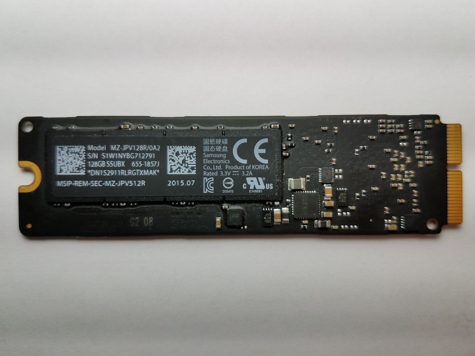

I just got my newest toy, a 256GB “SSUBX” AHCI PCIe SSD. This is Apple's custom variant of the Samsung SM951 AHCI PCIe SSD. The following image shows the 128GB variant, but the 256GB one looks the same.
So what's the deal with this thing? Aren't NVMe PCIe SSDs newer, better, faster 'n' stuff? Of course they are, but third-party NVMe SSDs require High Sierra to be recognised and a reasonably modern Mac — 2010(?) and newer — to be bootable. AHCI PCIe SSDs, on the other hand, use the universal AHCI driver that is built into Leopard and later versions of OS X, so they can even be used with Leopard, including in PCIe G5s. And they’re bootable in early/earlier Intel Macs as well.

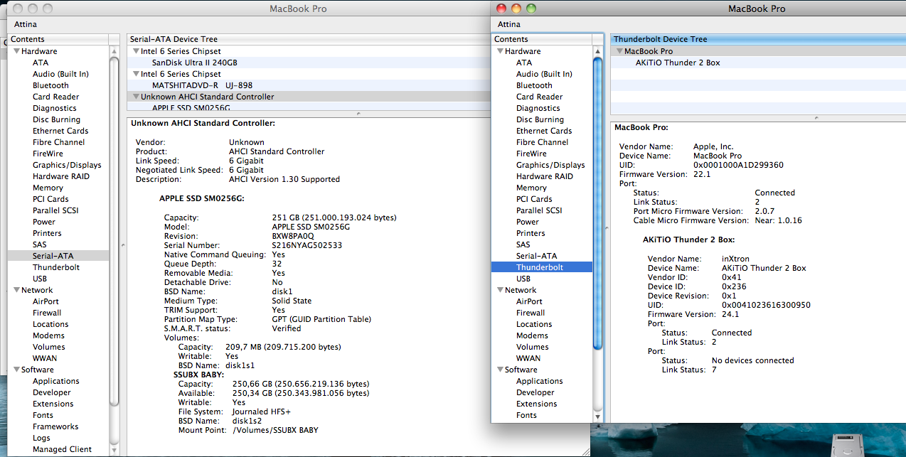

I popped this into a PCIe adapter, stuck the adapter into an AKiTiO Thunder2 PCIe enclosure and hooked it up to my Early 2011 13" MacBook Pro — runinng Snow Leopard — via Thunderbolt 1. Result: a match made in heaven. 😀
It shows up like a regular internal SATA drive would, even getting the “internal drive” icon. Don't let the link speed of 6 Gbps fool you, this baby crashes right through it.
The controller’s vendor ID is Samsung’s as expected. And: Confirming that it uses four PCIe lanes. Thunderbolt 1 is PCIe 1.0 so link speed should™ actually read 2.5 GT/s (5 GT/s is for PCIe 2.0).

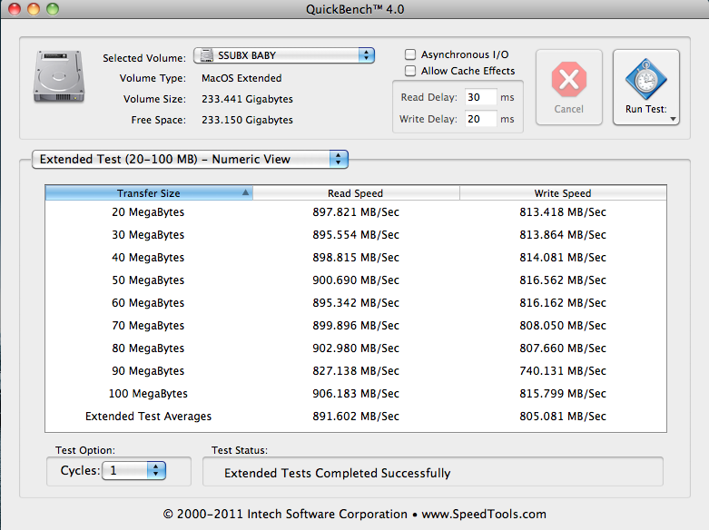

Correction: Thunderbolt 1 is PCIe 2.0. Thanks @joevt! Enough words though, let's see what this baby can do!
HOLY MOLY! 900 MB/s read, 800 MB/s write. The SSD can actually do even more, but Thunderbolt 1 bottlenecks it. Still, we're pleasantly close to Thunderbolt 1's theoretical maximum of ≈1000 MB/s.
And yes, Snow Leopard boots just fine off it, I've just tested this.

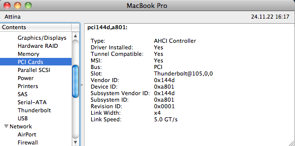

Confirming that it uses four PCIe lanes. Thunderbolt 1 is PCIe 1.0 so link speed should™ actually read 2.5 GT/s (5 GT/s is for PCIe 2.0). Enough words though, let's see what this baby can do!
It says 5.0 GT/s which means Thunderbolt 1 is PCIe 2.0.
I suppose you can test this by taping off all but the first lane to make it x1 which should give ≈450 MB/s for PCIe 2.0 and ≈200 MB/s for PCIe 1.0. Or use a x1 to x16 riser.
Actually, the 900MB/s might be enough to prove PCIe 2.0 since PCIe 1.0 x4 is usually less than ≈900 MB/s? But it's not conclusive since PCIe 1.0 x4 is 1000 MB/s disregarding overhead.
Actually, you can probably switch the Thunderbolt controller downstream bridge to PCIe 1.0 using the fast.sh script and pciutils (but you need DirectHW.kext for old versions of macOS). If it reduces the speed, then you know it was running at PCIe 2.0 speed before that.
I see. I mistakenly assumed that Thunderbolt 1’s 10 Gbps limit implied it was PCIe 1.0, even though Sandy Bridge supports PCIe 2.0. Thanks for the correction.
I’ll give this a try. Thanks again.
Thunderbolt 1 supports 20 Gbps just like Thunderbolt 2 except that Thunderbolt 2 is able to combine the two 10 Gbps channels into a single 20 Gbps link.
Thunderbolt 1 has two separate 10 Gbps links. It can connect two 8 Gbps displays (1440p60) but it can't connect a 16 Gbps (4K60) display like Thunderbolt 2 can.
PCIe tunnelling is limited to 10 Gbps (a single channel) for Thunderbolt 1. Maybe there's a way to get two separate 10 Gbps PCIe tunnels on the same Thunderbolt cable if the paths are somehow made separate - but the tunnels would be to different devices - not a single NVMe. There's enough PCIDown adapters for that (my iMac14,2 has one Thunderbolt controller, two Thunderbolt ports, and 4 PCIDown adapters). I don't know if that kind of path manipulation is possible. I do know that you can make a DisplayPort path from one domain to another (like Thunderbolt Target Display Mode does) but I haven't looked at how to do the path manipulation (for example, in linux to do Thunderbolt Target Display Mode, or to create a Thunderbolt dock controlled KVM).
