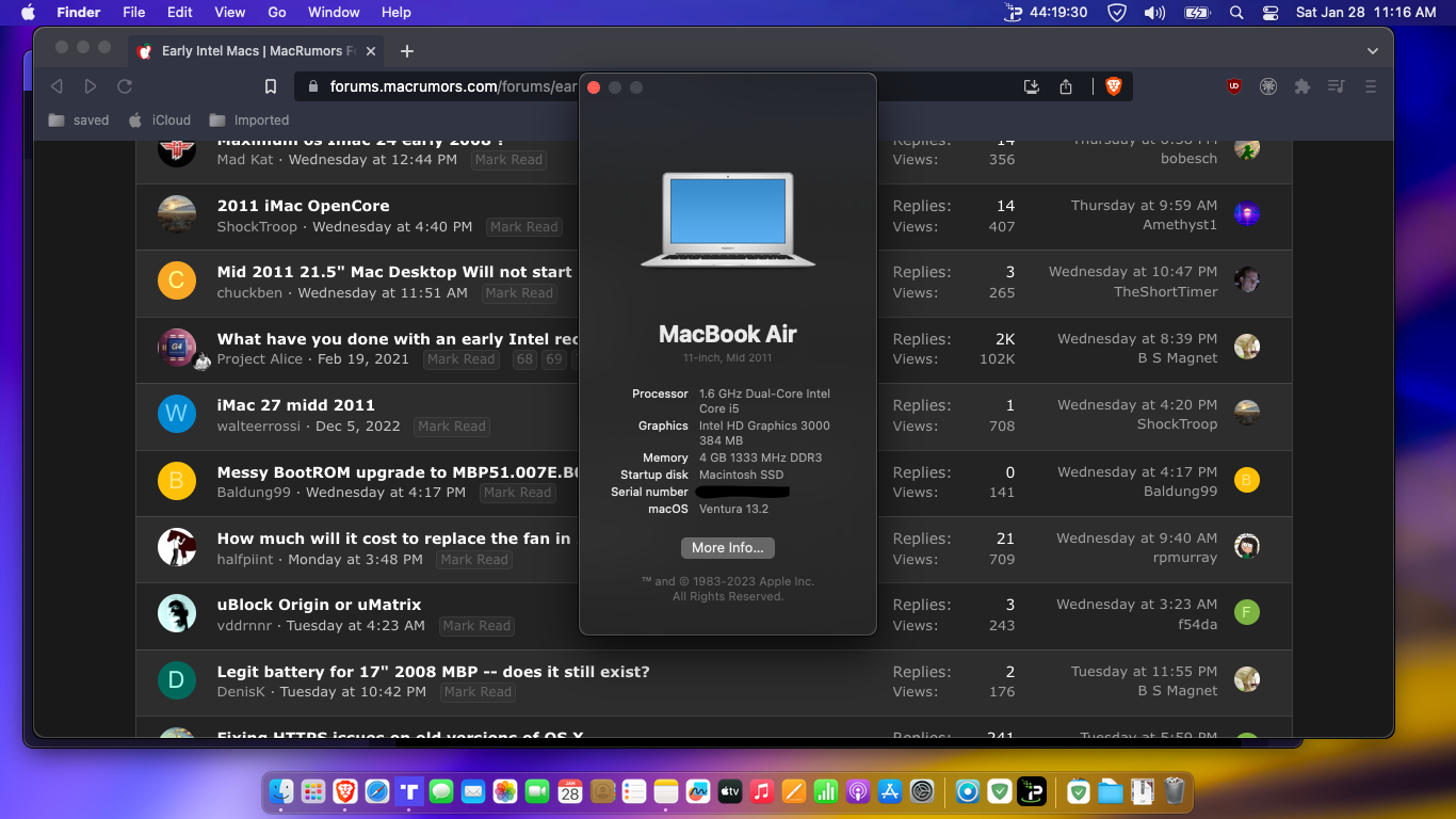

My 2011 Air is now running Ventura via OCLP 0.6.1, and quite nicely...

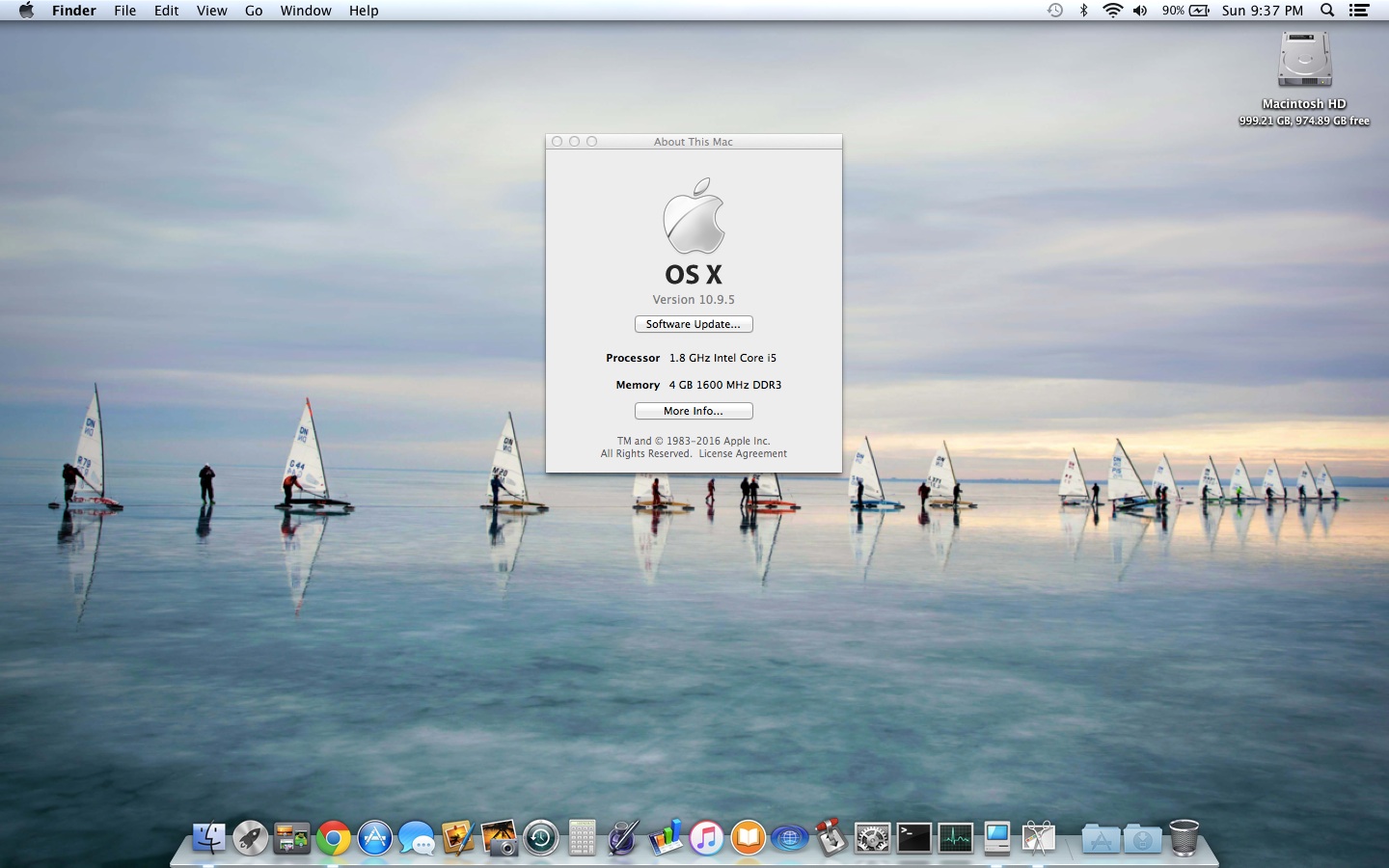

Where did you find that wallpaper? Looks great with the frosted Mavericks dock.I tossed my Mavericks image on my MBA 5,2. Running quite smoothly. I had been running 11.x on it and while it was running fine I felt like going back in time on a Sunday night..
It’s a Bing image of the day. Wallpaperhub.appWhere did you find that wallpaper? Looks great with the frosted Mavericks dock.
