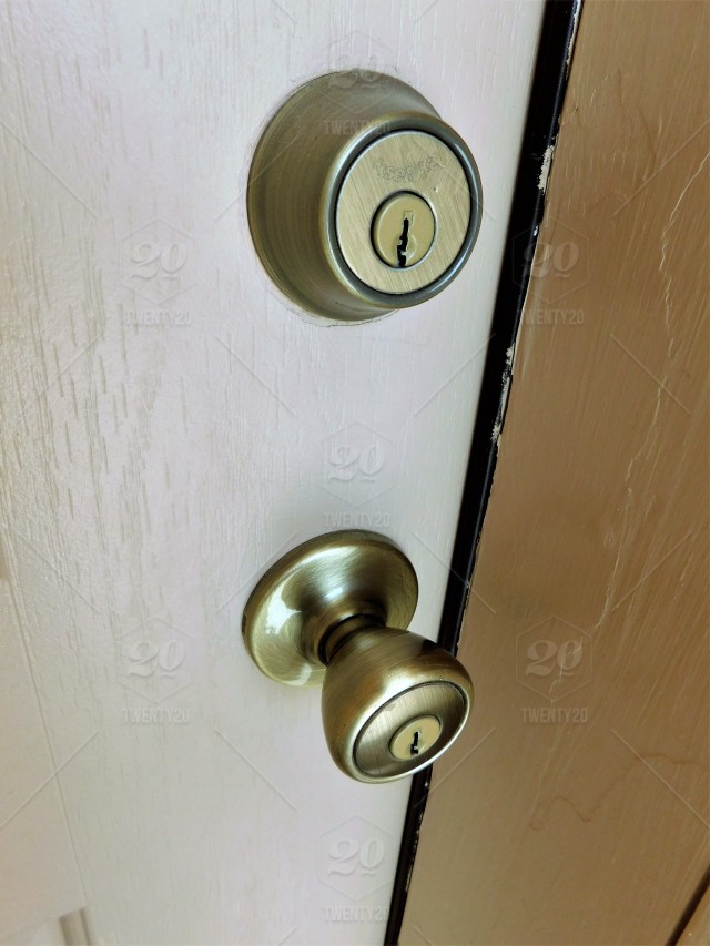

Just moved to a new house and the front door lock could be better.

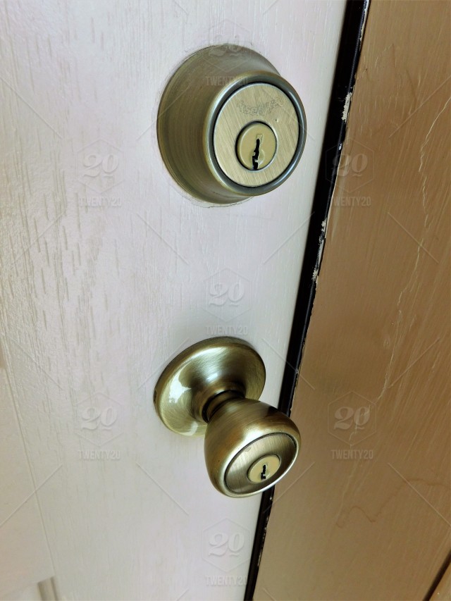

The front door has two locks. The main classic door handle where you put a key to lock it and above it the also classic dead bolt that requires a key to lock and unlock from the outside with no door knob.
Ill include Pictures. I want to get the best of the best and don’t mind if ppl were to recommend HomeKit/iOS compatible door locks IF they are really good but I recall years ago that many of those were easily hack-able.

As for my personal dwelling, I use the SCHLAGE Touch™ deadbolt and a level handle. Dunno if it's the best, but it works for me. I don't care for smart locks or wifi connected dodads.
Schlage electronic. Had separate codes for different people/services so I know who came in and when. Could lock/unlock the door remotely.

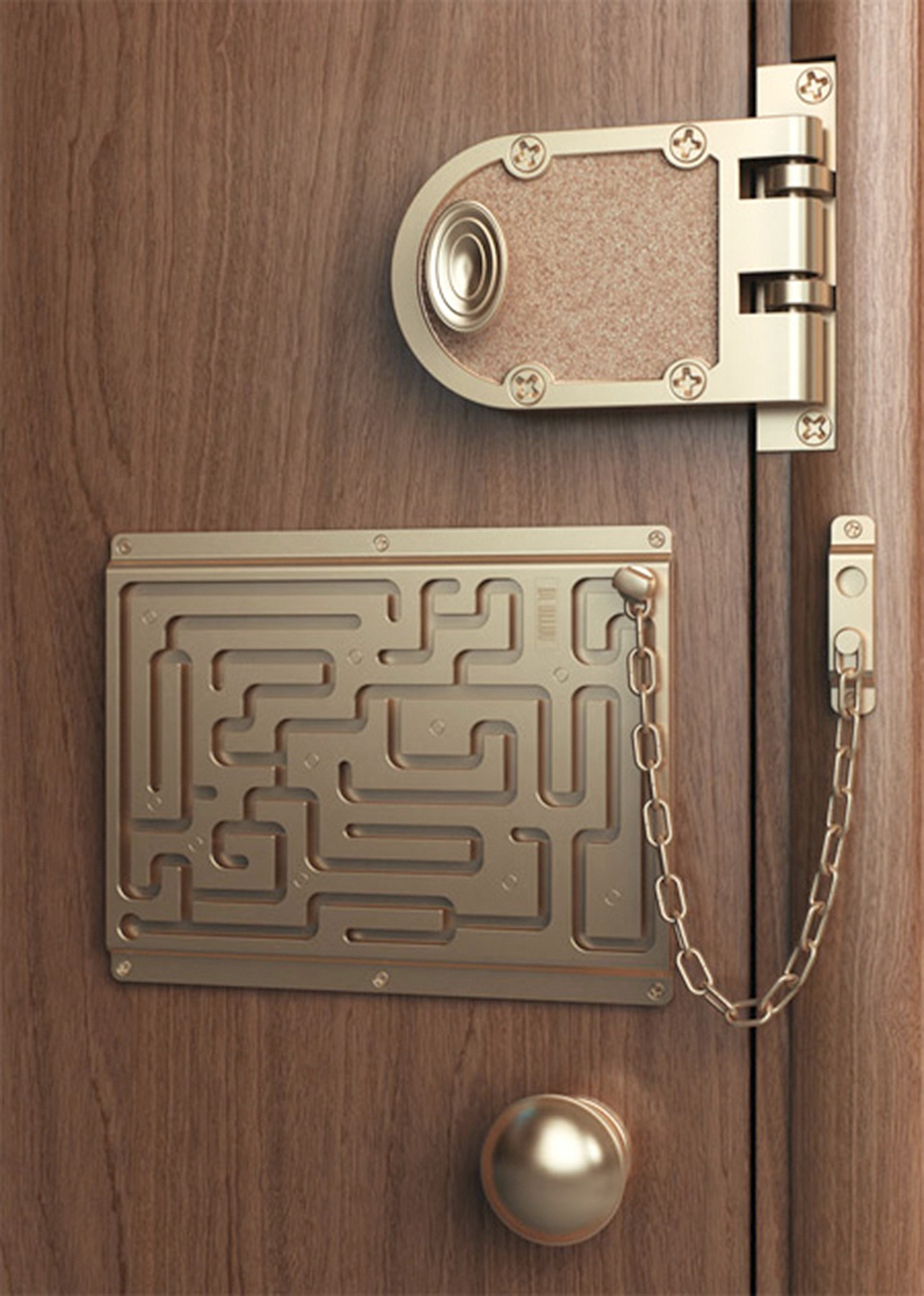

Our front door strategy 😉
Seriously, we have a single deadbolt on front and back entrance that require keys on both sides of the door, backed up with an exterior sign, stickers on the windows, a monitored security system, the door is wired, plus motion detector, and glass breakage detection. Does not require food, cleanup, or attention. 🙂

On a serious note. The best I've used was some heavier duty Schlage deadbolt. The steel plate in the doorjamb was larger than normal. Which had heavy duty screws going deep into the wall studs. Same with the hinges. The door was a standard insulated steel door. All of which made for a secure front door.
Of course a really secure front door is pointless if someone can just break a window or kick in another door.
I prefer Schlage myself.
There are nice 'beefy' regular handles and locks and they also offer options with HomeKit, Bluetooth, number codes, assigning entry codes for different people.
I like their quality and options.

Schlage electronic interests me. What You mentioned is rather significant with multiple codes and ways of having an itemized list of when/who entered at what time/dates, I like the tracking aspect. In terms of technology today, we definitely are living in a digital frontier, But I still haven’t made the transition away from your ‘standard deadbolt’ hardware, but I also utilize CCTV at all entrance points.
