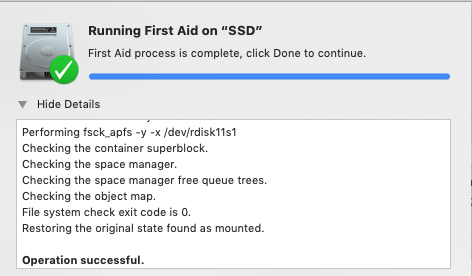

I’ve actually run Disk Utility’s repair many times and it never finds any issues. However, in system profiler, it shows a “Failing” S.M.A.R.T. Status.
I wouldn’t mind running macOS from it. Worse thing that would happen if the SSD fails is the machine crashes. All my files are stored on iCloud.
Still, I’d like to know how S.M.A.R.T. works. I know I had file system problems when running APFS on the Fusion Drive on High Sierra. I wonder if it triggered an error that has stayed on the drive even though there’s no physical problems. I mean, how can an SSD fail before the spinning disk?
Disk Utility's repair checks the status of the file system (the actual bits of how the file system is written on disk and its logical consistency). S.M.A.R.T. checks several (hardware) parameters of the drive. It can predict drive failures even when the actual stored data is not corrupted yet.
