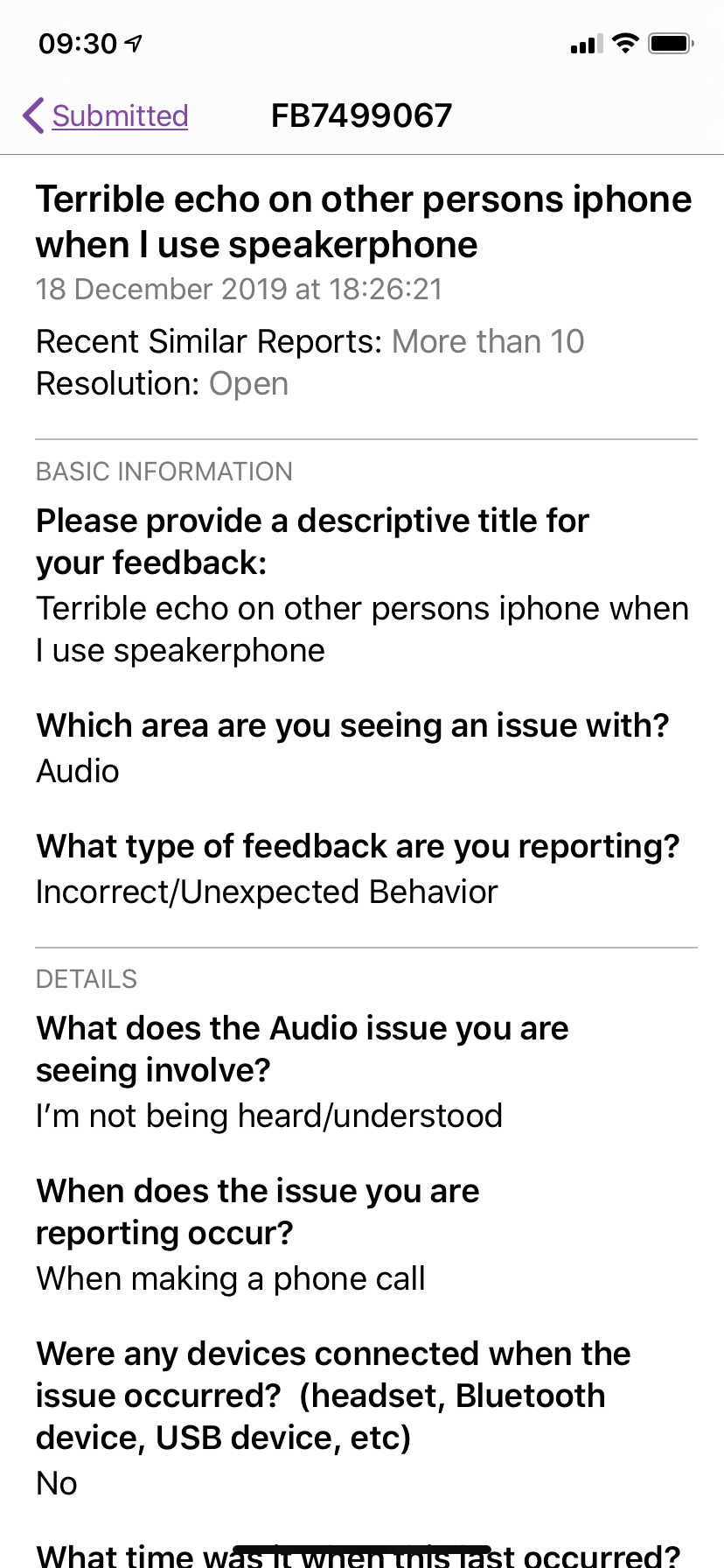

Just to add I’m on 13.3.1 the latest beta, I have filed a bug report I advise you all to do the same, so far I have
1. Tried a different sim on a different network
2. Tried reducing volume on both phones
3. Tried the signal app call feature
4. Tried both standard cell and FaceTime audio calling , note it does not happen on video
5. Activating the mute button, this does cure the issue but obviously is not a solution
6. Making calls using my Apple Watch connected via Bluetooth, this also had no echo.
hope this helps
