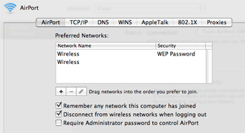

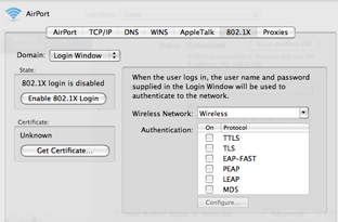

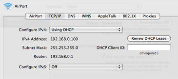

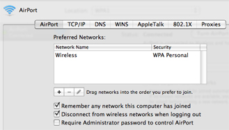

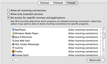

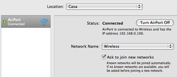

pics of my network settings...

Mlobo01, I notice from your screenshots that you're using a wireless network with WEP - does WPA not work properly for you?
I only ask cos of how everyone says how easily crackable WEP is. I'm using WEP myself cos WPA caused too many problems but I'd prefer to use something more secure.

I will try these settings and post my results, One thing I did notice is the Lock symbol on my Airport networks list, it was not there before with WEP, and can someone explain if WPA-PSK is different from WPA alone? if not my next trial is WPA alone. I will try theses settings for the connectivity properties, what happens when the system goes to sleep or shutdowns etc, and I will post the results, Thanks

So far so good with WPA...
So far so good, Im satisfied that the connection is stable, it was a rocky start for my connection and it did get lost upon long-term sleep, once after restart as well, but I left it alone for a while and it began to stabilize further, I have no idea if its the caches or the way its registering upon other files but I have tested it in all manners, Im gonna see if not having any WPA set-up makes a difference in terms of speed, since my network has a short reach about 20ft. radius, and I only have 2 machines. Also I set the router to a short preamble, Im researching the significance of the now over google. Im not sure if all routers have these same settings, but supposedly short preamble makes for better video-audio and VOIP streaming, can anyone opine and that or test his/her equipment. thanks
