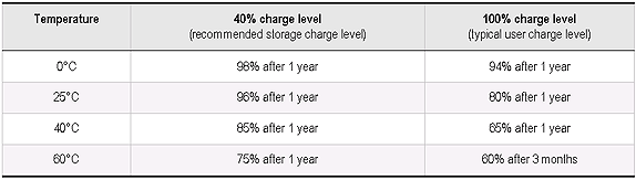

If this is the case I hope you realize that by the battery just sitting around at room temperature it will likely fail long before the battery that will come with your new Macbook. Unless you store it properly.
If you are planning on long term storage. You should drain the battery to a 40% charge and keep it in a cold temperature controlled environment. A refrigerator, not a freezer, is ideal. Place in a sealed plastic bag to prevent condenstation.
Source: Battery University
http://www.apple.com/batteries/notebooks.html
It isn't necessary to keep batteries in the fridge.
Source: Apple

It is not necessary but it minimizes lost capacity by about 1/2 over room temperature. Especially since I was thinking of three to four years of storage. Assuming the op would swap out the battery once the new Macbook's battery lost too much capacity.
Since the op later revealed that the intention is to swap batteries every three months then room temperature storage is fine.
