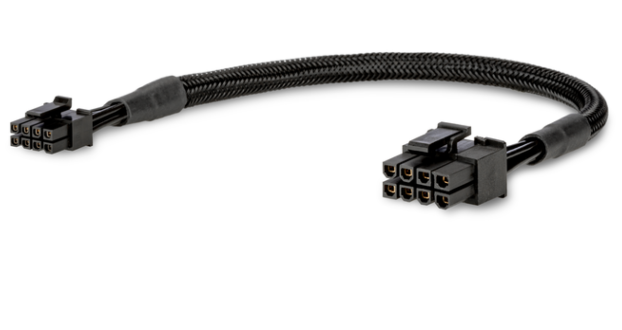

Can somebody tell me which cables i exactly need to power the 6900xt in my mac pro? 8 to 8 pin? 6 to 8?
Hope someone can help me. I ordered the Belkin kit, but the sender shipped it to a wrong address and right now he is pissing me off. So i want to order the exact cables alone.
^^^^Depending on your card. you will need either two or three of these:
Belkin kit works fine I use it on my 7,1 and 6900XT
I know it works fine, but the shipper posted the parcel to a wrong address and now i have to wait for the investigation etc. and i don't want to wait haha. So i order the cables again.
Nice yeah try to get a refund for the previous one if you cant wait and also @flowrider posted a great alternative.
