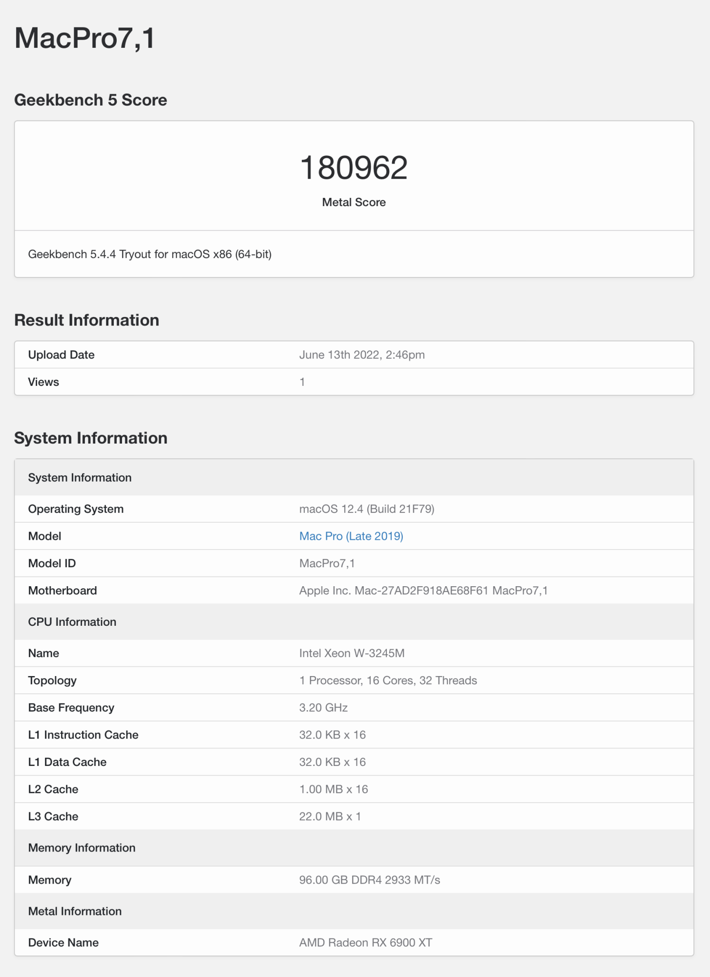

Gigabyte 6900 XT gaming turned up today, now fitted and it fits really nicely. so first metal bench score with it. performs well.

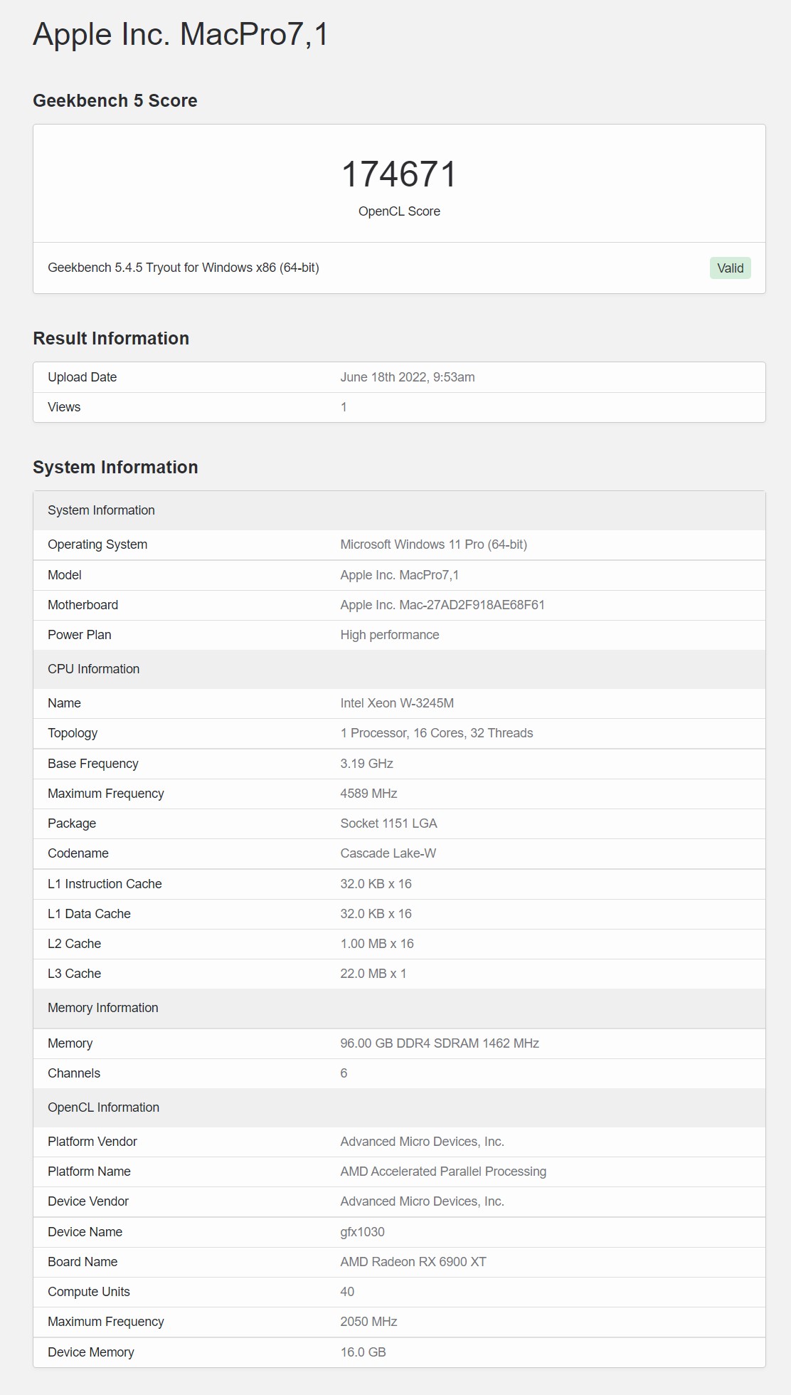

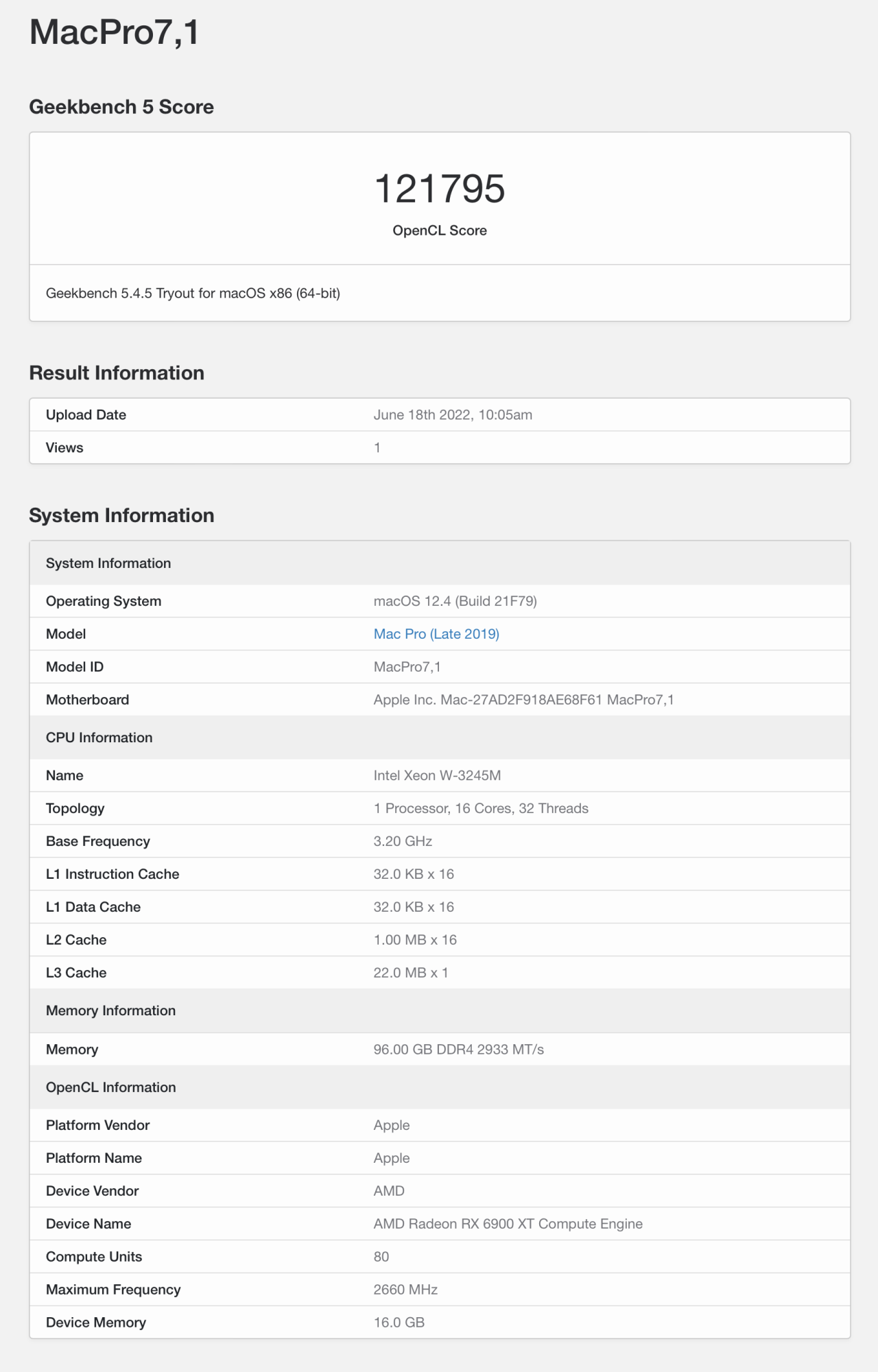

I thought I would do a comparison on Open CL between Monterey and Win 11 and wow the drivers in OSX are way down on win 11 the new AMD drivers are so much faster. I wonder if apple update the AMD drivers or keep them as is so the M1 looks good haha.
Yes I had the same results on openCL. Apple focuses on Metal and OpenGL is neglected.
You would think Apple would allow AMD to port over to OSX a decent driver for all really, what difference does it make to apple if the AMD driver is good in openCL. The AMD driver should be the best it can be in all requirements.
