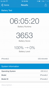

Morning guys so here the results for the replaced unit using geekbench with same condition as before (min brightness, disabled autobrightness, flight mode, dim mode enabled):
Iphone6s 64gb model N71mAP 6:00:05 3608
http://browser.primatelabs.com/battery3/125335
To compare with the unit I had before replacement:
iPhone 6s 64gb model N71AP 4:05
I know it's difficult to conclude anything on 2 tests, i know there are variations between unit but 2h of battery life difference doesn't sound right at all.
Would be happy to see other results.

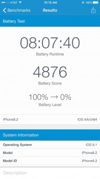

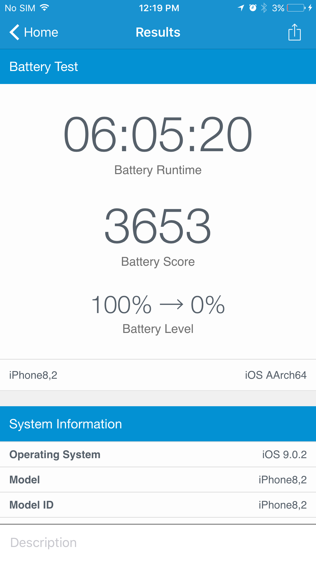

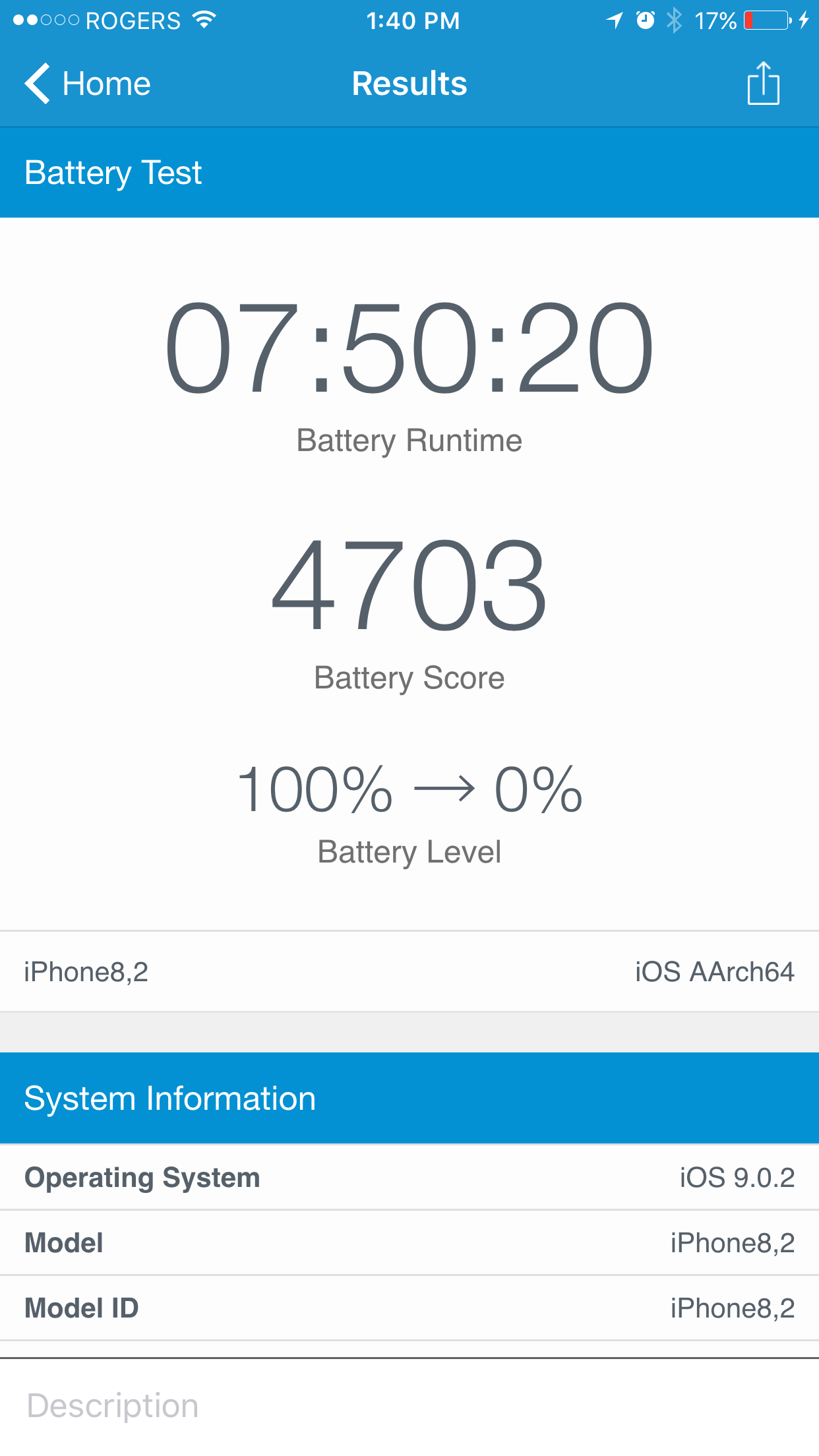

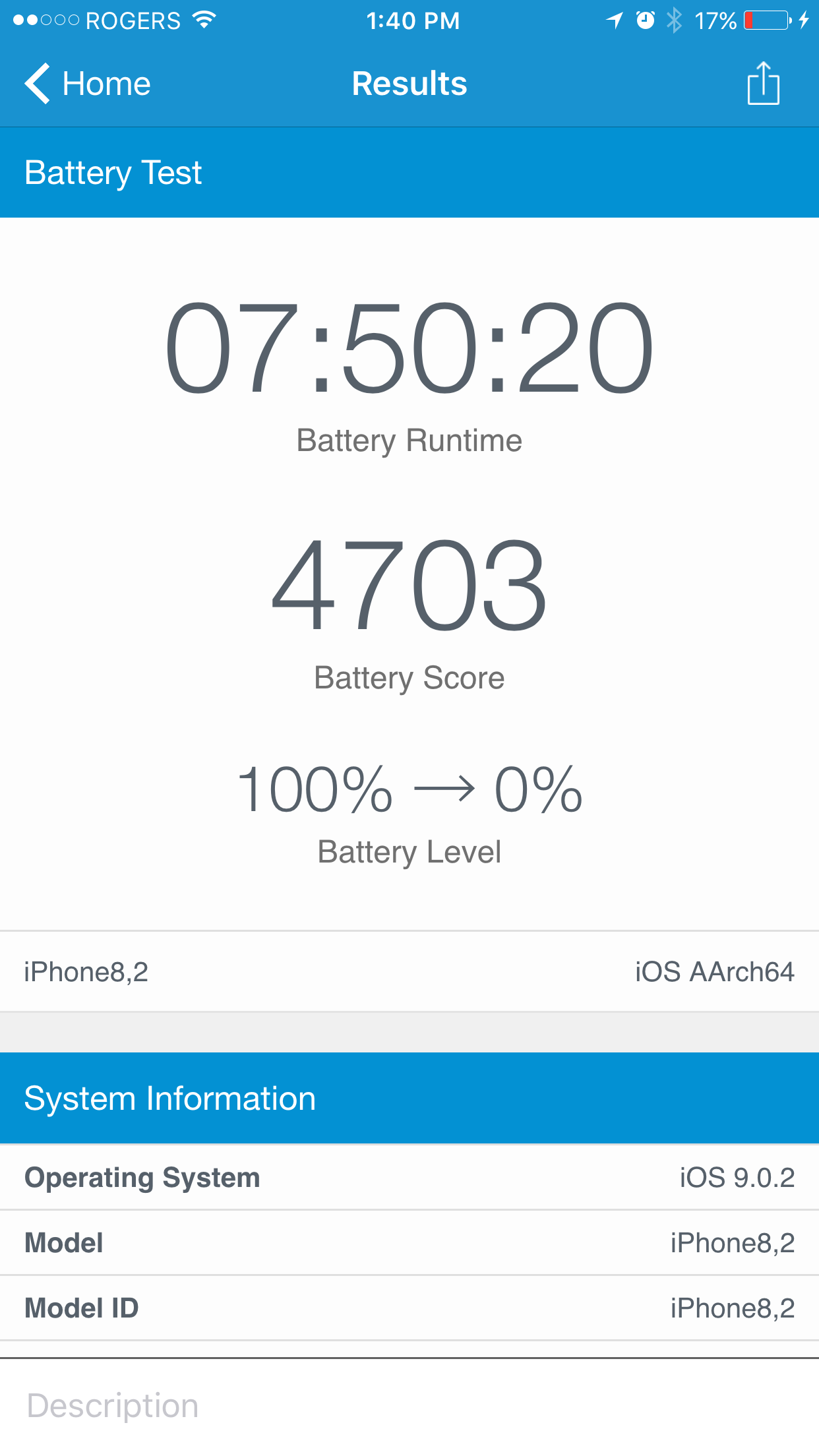

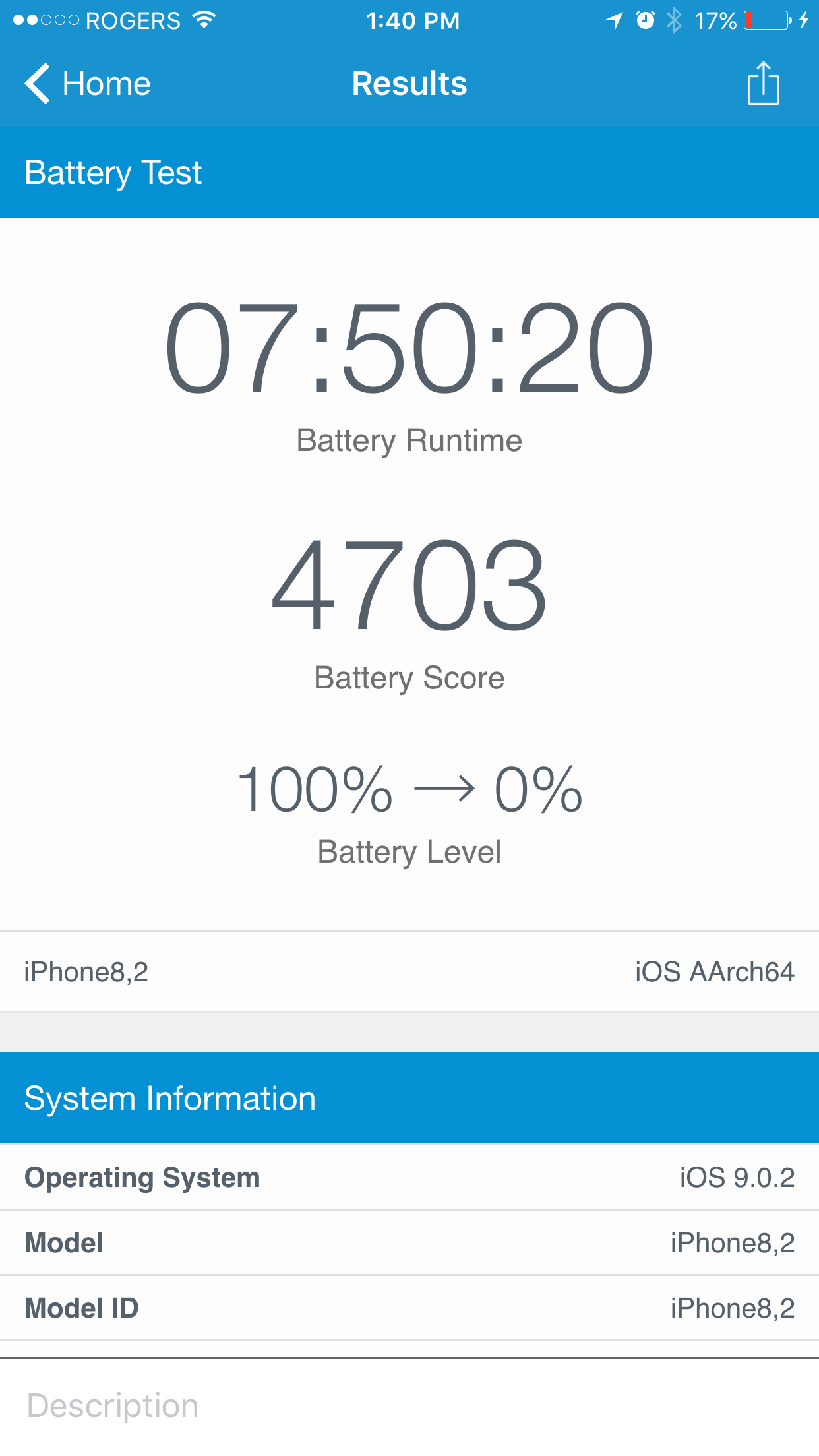

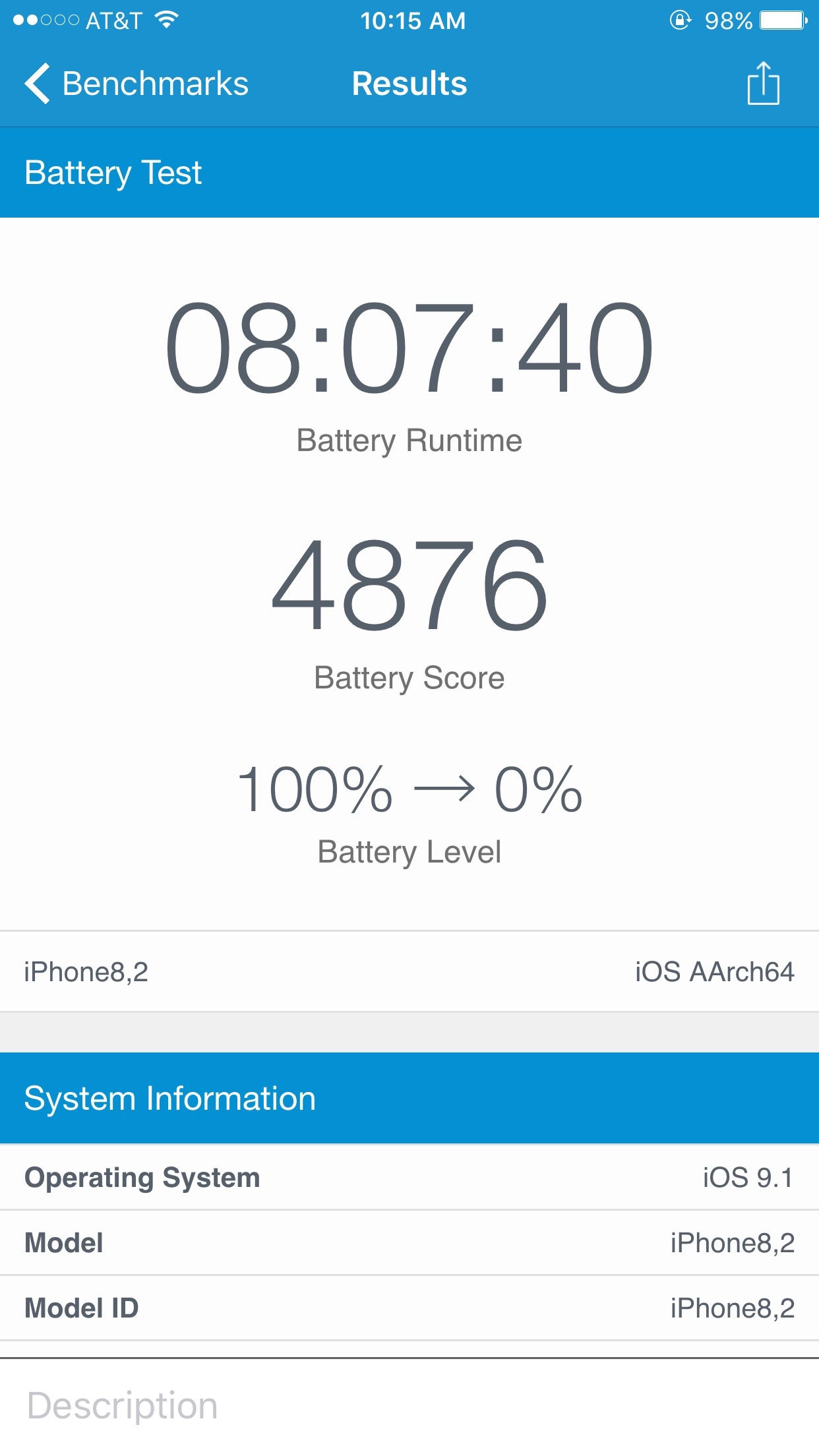

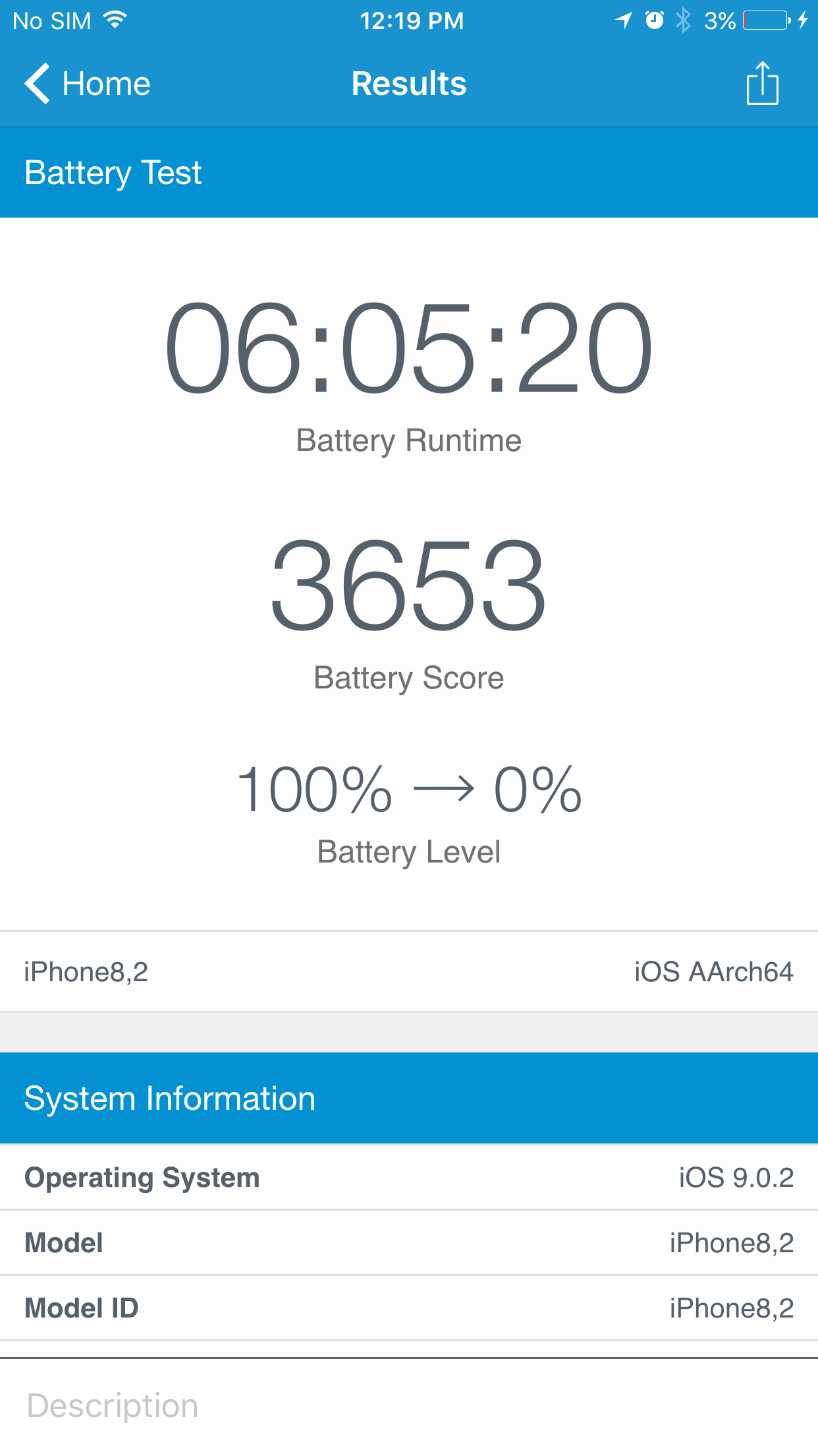

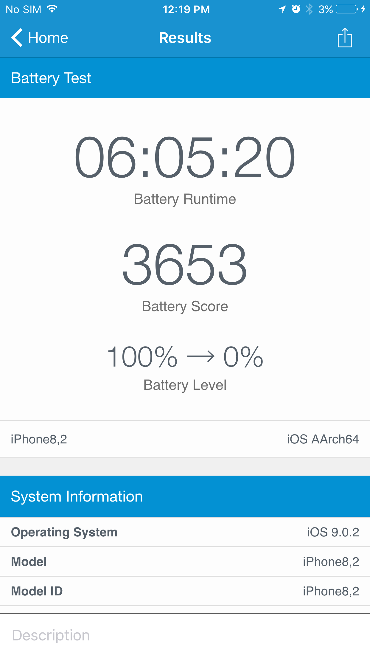

My results from a few days ago seem to be consistent to yours, although mine are the Plus versions.
My TSMC Plus was able to achieve a duration of almost 8 hours, while the Samsung was only able to last 6 hours on the test. A difference of almost 2 hours, similar to yours.
Samsung:
TSMC:
