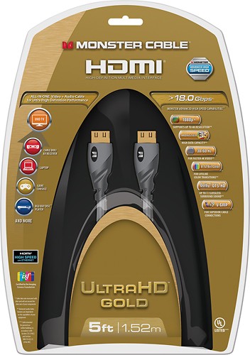

You must have Monster gold-plated HDMI cable. As everyone knows, gold improves the quality of the bits as they travel the wire.
