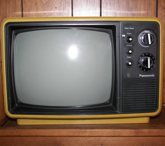

OK, I got all of that, but I'm having problems hooking it up to my TV:
I know that digital connections are essentially all-in or nothing seeing as all you're doing is sending 1's and 0's.
That said, I cheaped out and got a $5 cable online. My TV is getting 3's and not sure what to make of it......
