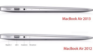

I need to replace my keyboard. If I put a top case for the newer (or older) MBAs in my 2012 model, would it work?
I already tried and messed up on that, it's a long story, so I just want to replace the top case alltogether.
After doing some more research, my impression is that the only difference between the 2012 and 2013/14/15 top cases for the MBA is the holes in the microphone. (I don't know about the 2010 and 2011 models)
mkSkmUEgDcB64GUk.standard
Assuming I'm right:
If I put a 2013+ top case in my 2012 MBA and kept my original microphone, would it affect my input volume? If so, would putting a 2013+ microphone in my MBA work?
