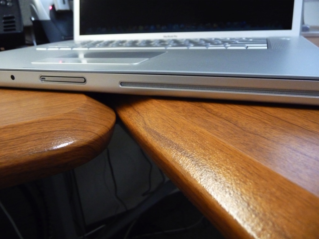

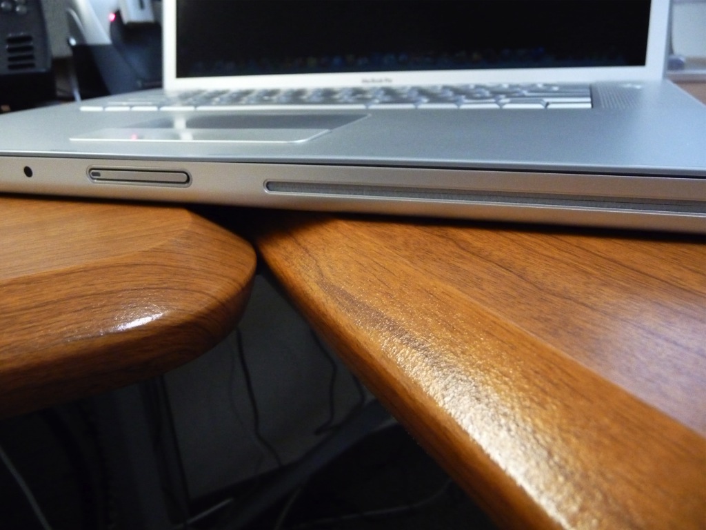

I have the same problem as you. I see a space between the keyboard part and the metal above the superdrive. It's really bothering me. =/
Have to carefully angle the top case toward the front so it fits closely before laying the back down. You should not have to apply much pressure at all. Take a close look at the lid lip and the base and see how it should fit in.

I upgraded mine last weekend and have the same issue with the small gap above the superdrive. It seemed like there was some kind of adhesive used but maybe I'll have to take it apart again and see if I can fit it in again like panzer06 said.

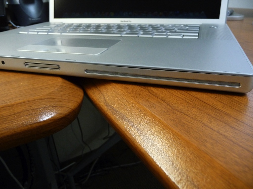

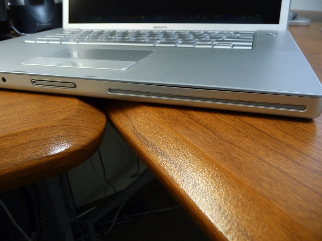

I took mine apart again today to try and get a better fit over the superdrive. This time, I did hear it click in but there's still a small gap. Any advice? I was trying to lay it in at an angle but that didn't seem to do anything. Once on, I pressed down to get the clicks. Tried pressing above the superdrive but because of the opening slot, it's not really working.

I know what the problem is...however I don't know if it is in our best interest (I say our because I have the same issue) to pursue a the fix. If you look at where you lay the keyboard in right above the superdrive, there is a metal/mesh/cloth-type bumper. This is not able to full depress causing the gap. It looks to be easily removable, I'm not sure that'd be a good idea though...it's there for something. Im thinking its so the keyboard doesnt hit or rest on the superdrive...I dont know. But I'm positive if you take that out/off the gap won't be there.

The whole "gap above the super drive" problem is pretty well documented. Take your phillips 00 screwdriver that you have been using to pull apart your MBP, and put just an edge inside the Superdrive. Pull up against the lip at the opening GENTLY, while pushing down gently as well. Work your way from left to right doing this and you oughta hear a couple clicks as it re-seats itself. Worked like a charm for me, and many other people that had this problem. 😉
That was so easy, I feel like a complete goober now. Thanks for the tip...worked perfectly.
