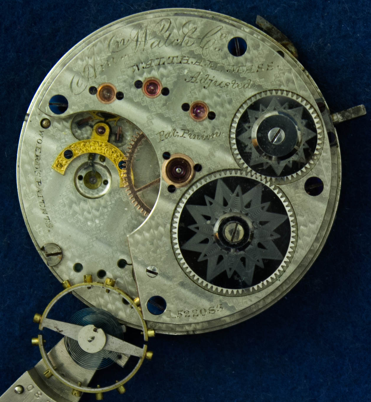

Unfortunately, the nickel movement pictured above is going back to the seller. While playing with lighting and trying to photograph to really show off the "quilted" pattern, I happened to notice that the balance wheel had brass screws rather than the expected gold and the balance arms had an atypical finish for the grade. A quick check showed that the serial number on the balance wheel did not match the one on the movement.
Fortunately, the seller-a friend-is a long-time collector and very graciously agreed to accept return. He also apologized profusely for not catching the problem.
In the meantime, though, here it is with the balance wheel removed. Despite it being the incorrect wheel, the roller table(likely original, along with the hairspring, judging by the number of timing washers) has Woerd's Patent square roller jewel along with the corresponding pallet fork horns.
So, the serial number on the balance wheel did not match that of the moment? Hm. How that that come about?
Well spotted, and unfortunate that you have had to return it.
Interesting story, and it pays to subject such purchases to close scrutiny.
Most likely, someone at some point in the past got lazy and took a balance wheel out of a parts movement to replace a broken staff rather actually replacing the staff. Or, there's also the possibility that the original wheel was damaged and, again, the part taken from a lower grade parts movement. The hairspring stud is unique to the Am'n grade and the pinning looks factory, so most likely they transplanted the hairspring from the original wheel.
This particular seller never provides pictures, and instead sells everything "on memo." Since I hadn't paid for it yet, it was no big deal to return it. The seller was very apologetic.

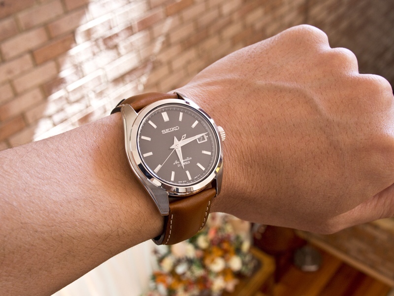

I am thinking of investing in a dress watch and have been thinking of the Seiko SARB033. I like the understated look that isn't flash but gives the presence of a nicely made watch.
(Not my pic)
It seems to look nice on its bracelet and most leather straps I have seen it on. Has anybody here got one or seen one first hand that can share their thoughts? They are only officially sold in Japan as its in Seiko's domestic range. I can get it for around £250 but would consider other dress watches in its price range. :)
I've not seen one "in the flesh."
It's a great looking watch and is very tasteful. Honestly, you can't go wrong with a Seiko.
With that said, it looks a bit "chunky" to me for a true dress watch, although admittedly this is sometimes hard to judge in a photo. In particular, it looks fairly thick, which I suspect is a consequence of it being an automatic.

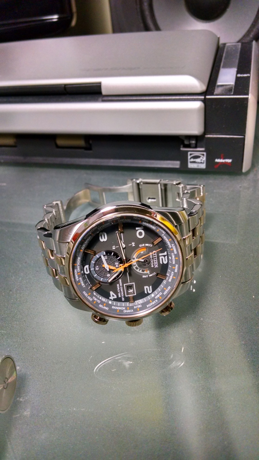

Here are my thoughts on my new Citizen Eco Drive, a gift. This watch is photoelectric powered. Not really a traditional watch, not sure if it belongs in this thread, but I like it almost as much as my Rolex submariner. It shares the same quality of being perpetual: it could theoretically work forever. Only the battery likely needs to be replaced after a certain number of recharges. The submariner is not dissimilar, as the mainspring is replaced at each service. At the same time this watch is radio synced to an atomic clock. I don't see how this is not equal or superior to a Rolex in these qualities. Further, it is water resistant to 20 bar. I think the only place the submariner is superior is that I can dive deeper than 600 feet (lol) and it would still work after 6 months in a lightless mineshaft (the length of time the Eco Drive can go on a full charge without light). Cheers.
Are all Citizen eco-drive watches atomic synched?

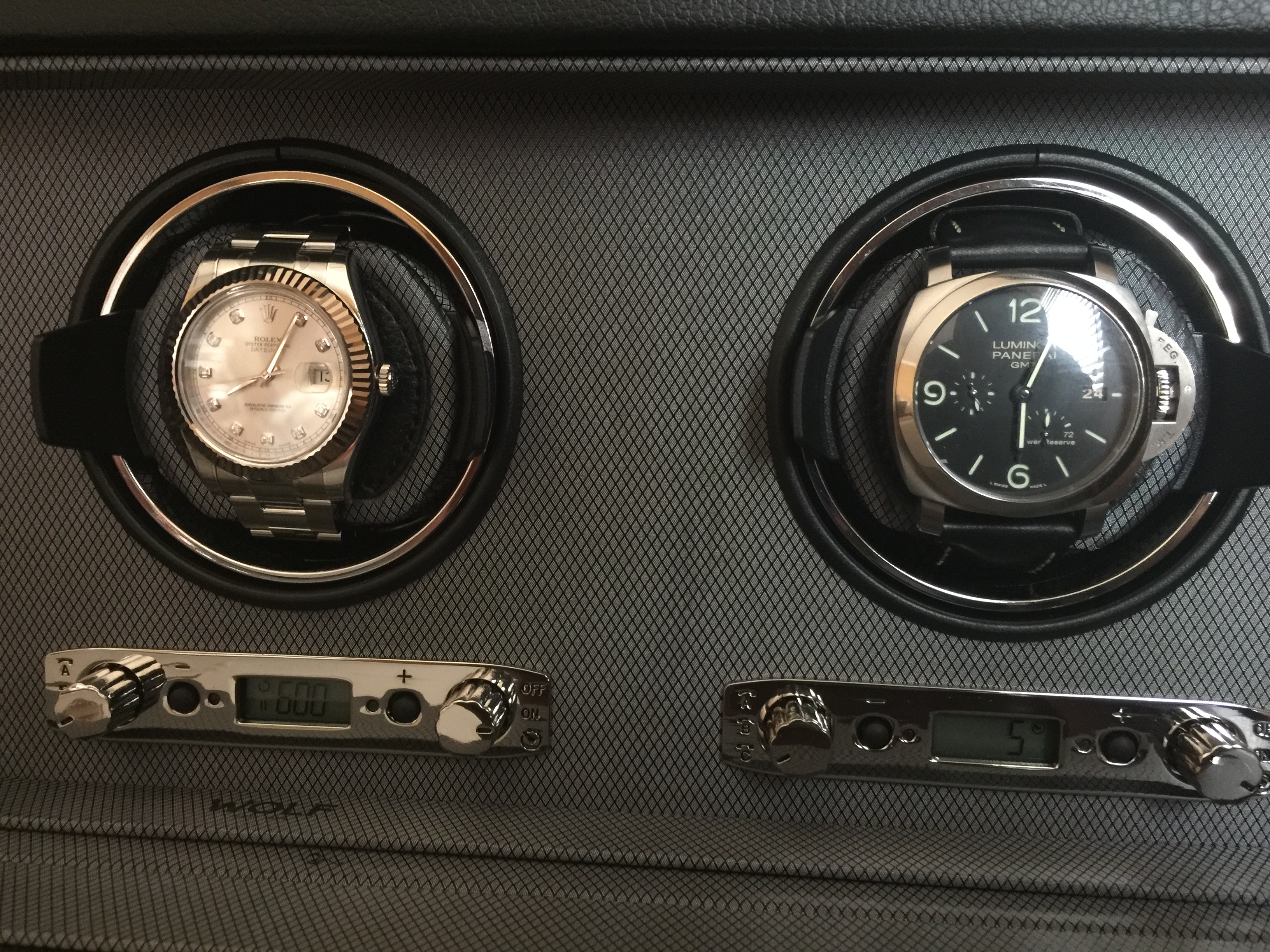

Heres my two! Sorry for the poor quality. Took it in a hurry.
What does the LCD on the winder display?
I Have a two tone Ladies Eco-Drive watch for years and I got at JC Penney years ago. I just love it to pieces. I may buy another one in the future.
Not all Citizen Eco Drives are atomic synced. I have to say it is an erie feeling when your watch has the exact time to 1 second every 100,000 years (the accuracy of an atomic clock). With the Rolex, its only accurate to +6/-4 seconds per day. That's a factor of a million.
