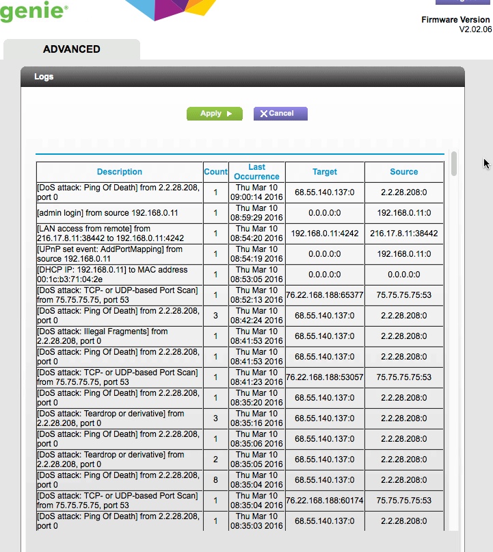

As an aside, here's a snap shot from my router log files this morning. Could this have anything to do with this? This is before anyone used the web in earnest today...
It's odd seeing the DOS in your log, but unless your iMac is attracting that problem, you would have seen the issues across all your devices with your Mac on or off. Check to make sure your firewall is off .
Find 802.11d and 802.11H. One will restrict power or change channels when it detects radar used by air ports and the other will tell the iMac the correct country code. I think 802.11H is what you want to enable. It is a wireless feature.
Are using tunnel or VNC technology's? It looks as if so,done is remoting into your 192.168.0.11 computer.

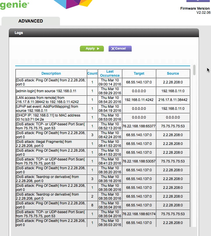

If your modem is also a router, I would recommend buying a decent router like asus or TD and put the modem in bridge mode. The devices seem to do either on or the other well, I've always had serious issues with combined devices.
